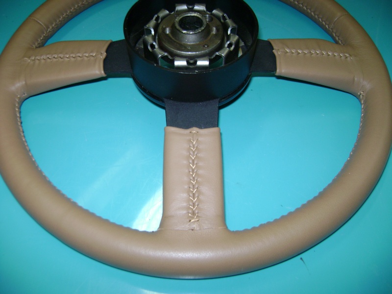

$20.00 is good but I told you, I,m thrifty. This recover was done with stuff I had laying around the house. The only thing I bought was the thread I used. $2.00 at Joann fabrics. Everything else was leftover from some other project. Sometimes it pays to be a packrat. After covering with the padding, I got out my covering material. A few years ago, at scout camp, my son made a leather poncho in some kind of crafting class. He said years ago to throw it away, I said I,ll find a use for that some day. Well today is someday!! The color is not an exact match but it's just going to be in my daily driver. Close enough for me.
Plenty for what I needed. I cut two strips the size I thought I would need.
Then I glued and folded over the one edge of the larger piece. This would be the edge near the center of the wheel. About a 1/4" or so.
Then I sewed the two pieces together. Should have used a darker thread but I was being lazy.
This is what it looks like draped over the wheel
Then, starting at a random corner, I started sewing.
I didn't glue the leather to the felt at this point. I'm hoping it's stretched tight enough to keep it from twisting. My first stitches were a little close. It's been awhile since I baseball stitched anything. 20 years or so. Took a while to get the rhythm and spacing where I liked it. Fortunately, most of it's behind the wheel.

I skipped over the posts and did the round sections first. I'll stretch around the posts later. Notice that the glue I used is starting to separate from the material.
I would start at the corners, pull tight and stitch.
I did not pre-punch any of the holes because I wasn't really sure the size and stretch was going to be OK. I just felt along as I went. Sorry the pictures are a little blurry. Need a new camera.
When I went back to do the posts, I cut and stretched till I thought it would look right. Then I stitched it together.
I know on the Fiero wheel where the post meets the wheel that it just overlaps but I decided to stitch it.
You can see here that the glue had really just given up. I was able to pull everything back together with the stitching. The hardest part was figuring out how to hold the wheel while stitching. Don't think I ever found a good way.
The home stretch (pun intended)

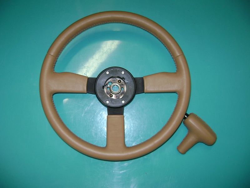

Well, I finished it. For me, unbelievable! I'm happy with the results. Now to reassemble, soon.
I hope this helps anyone that's thinking to do the job themselves. This was just my experience, all others are welcome to post suggestions and helps to make the job easier.

WOW! Incredible! I thought I was gonna have to dish out $150 for a new one, but this looks GREAT! This will be one of the first aesthetic things I do to my Fiero. Thanks for the write up!
NCTyphoonKid
Posts: 1278
From: Trinity, NC USA
Registered: Jun 2008
Report this Post11-25-2010 09:25 AM Click Here to See the Profile for NCTyphoonKidSend a Private Message to NCTyphoonKidDirect Link to This Post
Wow! Good job on that steering wheel it looks factory too!

The dreaded goo of death dripped out of my GT wheel one hot day this summer, and I have been trolling the web looking for ideas on DIY recover. Have not seen felt used as padding, but it appeals to me to me more than foam which might eventually go the way of the original.
Anyone have suggestions on what glue might work best for attaching felt to wheel?
I agree with other posters -- it's not so much the price as it is the satisfaction of being able to say that you did it yourself.
Have bookmarked this writeup for reference this winter when I tackle this job - many thanks.

Thanks again everyone. I'm happy to see that my writeup has been appreciated. I did it as much for myself as for everyone else. I tend to forget over time how I did things if I don't write down the details.
Well, if I were going to do it again, I would probably use weldwood contact cement. The same thing that I used on my headliner. Heard it sticks well and lasts a long time. Just didn't have any available when I was putting it together. The felt seems durable and I like the feel of the padding. I don't know how it will last long term. Have to wait and see. I do know it's not going to turn into goo anytime in the near future. I pulled the leather tight enough so I hope it doesn't twist on me
Finally got the wheel reassembled and traded into my car. Wow, a project I actually finished, I DO need to write this down. The color is a little off from factory but I'm not building a show car, just trying to keep things nice looking.
Thanks again for the compliments.
