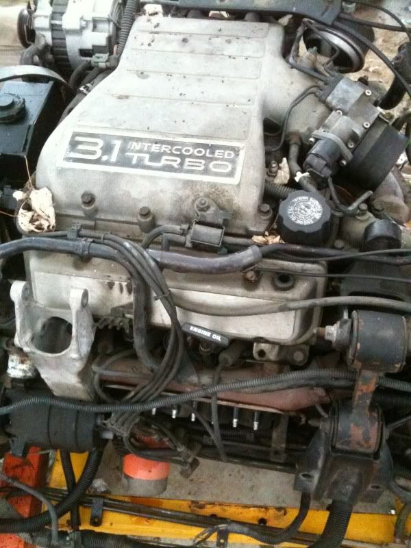

Still tossing around using the dash and cluster.
I really like the idea of HUD,but i'm really diggin' the "Intercooled Turbo" wording and integrated boost guage.
Stock boost guage's suck,but i'm sure something could be done using guts of an aftermarket unit.
I've been building this though for the past few weeks in my spare time (no time lately)
https://www.fiero.nl/forum/Forum2/HTML/103872.html
and not sure if I wanna give up on it-I really like the green and that style digital.
Any opinions?

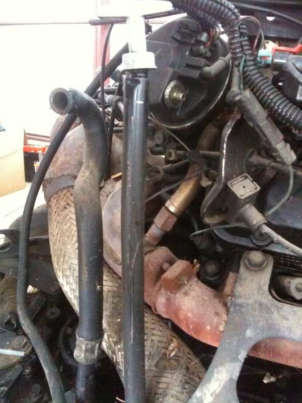

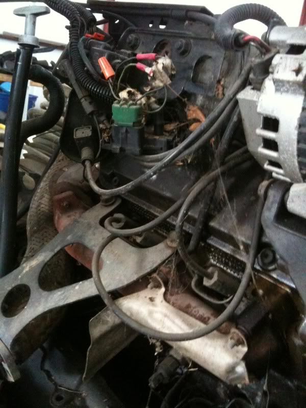

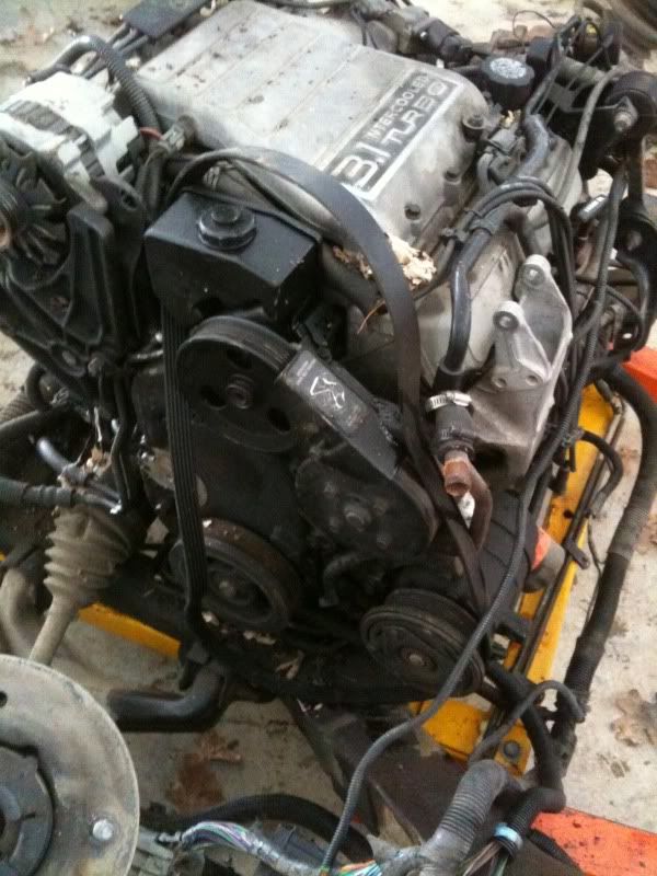

Lol @ Tim
The Bronco is a hunting rig only,all stock with a winch the width of the bumper.
It's sitting there till I get time to rebuild the rear end,hopefully before next season.

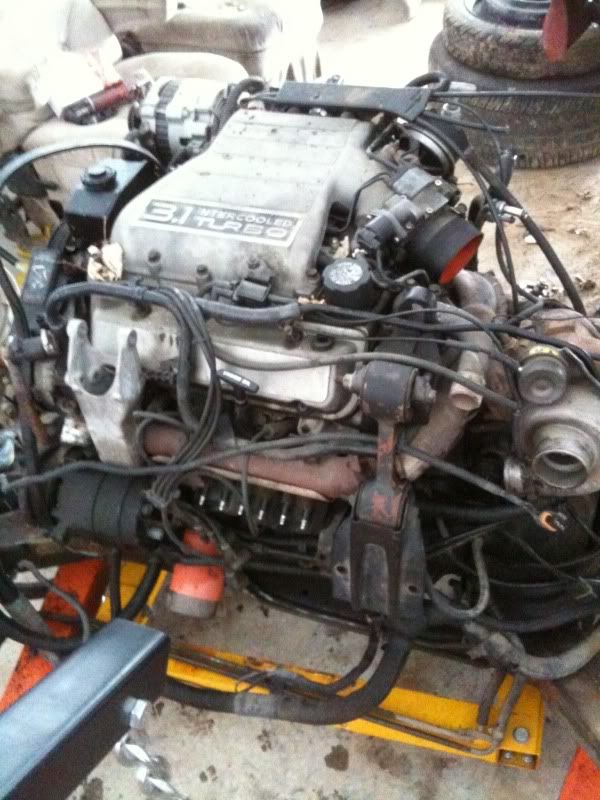

Originally posted by Carcenomy:
Will be a particularly nice wee swap, since you've got the whole TGP to pillage you might as well gank the cluster etc as well and make use of it while it's available - you'd be the first I know of. Might as well have the 80s fancy goodies that go with the turbo 3.1 to go with the 80s fancy looks of the Fiero eh?
I thought of doing just that,and almost scrapped this project
But to be honest,other than keeping the cool 80's look and having the "intercooled turbo" wording there isn't much there imo.
The integrated boost guage is nice,but it's a stock unit and they are terribly inconsistent.
While I haven't decided for sure which dash i'll be using,I think i've ruled out the TGP cluster.
If it actually said McLaren on it,I would use it just for that probrably.
As of this time though,I plan to give it to my buddy to rebuild and put new motors in and sale it on ebay,tgpforums or w-body.com
Here are some pics of the powertrain,don't mind my dirty shop-it's storage at this moment (and my brother in law can't remember to close the big door,hence the leaves)

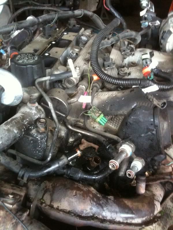

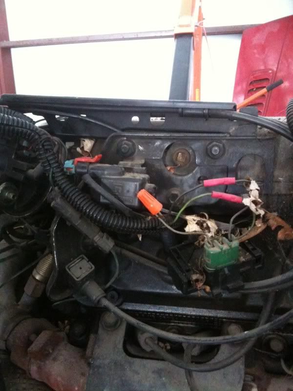

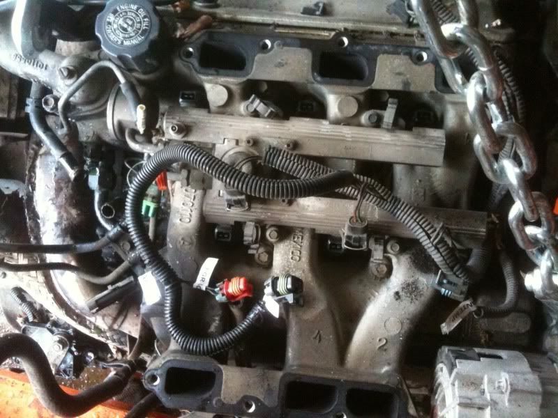

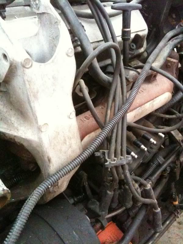

Had a spare couple hours today so went out to the shop for a bit.
Subframe is back under car and car is rolling again.
Took almost an hour to push the engine/trans/hoist to the front of the shop by myself (thanks for not showing Jace!)
Decided to pull some misc crap off since I didn't have a truck to load it into at the time to degrease it and move to my garage.
Got most of the harness pulled and labeled,gonna have to rebuild it from scratch it looks.
This thing must have ran like toasted dog turd,almost every vacuum line was cracked,broke or shoddily patched.
AC clutch connector was dead short across,along with a few more.
Inline splice/scotch-lok connectors (shadetree trash) were used without abandon.

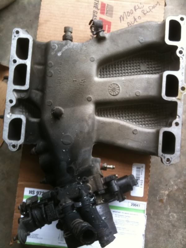

From the looks of the upper intake manifold i'll be dealing with a crossover leak more than likely also.
Went ahead and pulled the upper manifold.
I really want to use the stock stuff,just ported to infinity-but not so sure i'll use the stock TB.
Yanked it so I could start comparing the gasket and flange size to see how I could tweak it,make it better etc..
(I'm aware of the easy 3400 top end swap-different conversation and TGP's came with the big splayed valve heads )
Here's some more pics.
[This message has been edited by DefEddie (edited 02-03-2010).]

Good news as that means I can sell it for funds to pay for the newer bigger one if I need.
Well,for those following that's where i'm at.
I'll take some pics of it cleaned up whenever I get it on the stand and get my garage cleaned up enough for pics
Haven't heard from Majestic Turbo all week.
Not a huge issue yet,but will need to hear from them or call them back within the next couple weeks.
