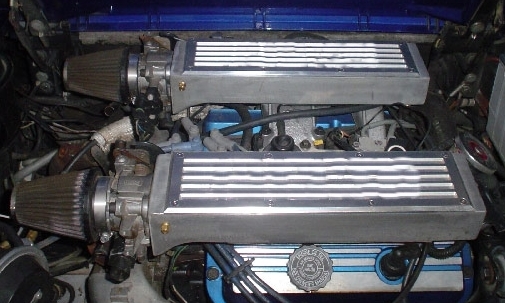

PaulJK
Posts: 6638
From: Los Angeles
Feedback score:    (25)
Total ratings: 237
Report this Post01-14-2008 04:31 PM Click Here to See the Profile for PaulJKSend a Private Message to PaulJKDirect Link to This Post
i think this looks a lot better
or this
[This message has been edited by PaulJK (edited 01-14-2008).]

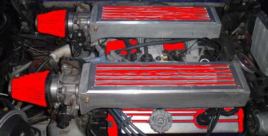

PaulJK
Posts: 6638
From: Los Angeles
Total ratings: 237
Report this Post01-19-2008 11:59 PM Click Here to See the Profile for PaulJKSend a Private Message to PaulJKDirect Link to This Post
OK - how about this ?

toddshotrods
Posts: 1177
From: Columbus, OH, USA
Registered: Aug 2004
Report this Post01-22-2008 04:53 PM Click Here to See the Profile for toddshotrodsClick Here to visit toddshotrods's HomePageSend a Private Message to toddshotrodsDirect Link to This Post
Originally posted by The Poopsmith:
I see.. what about employing instead of injection moulds maybe carbon fiber or fiberglass and making some kind of mold so you could reproduce the pieces multiple times. I think somebody here made a fiberglass intake for their swap.
I'm not trying to hijack this thread I've given Todd my fair share of ideas for other projects he has worked on so I thought I'd try here seeing as there is still some interest.

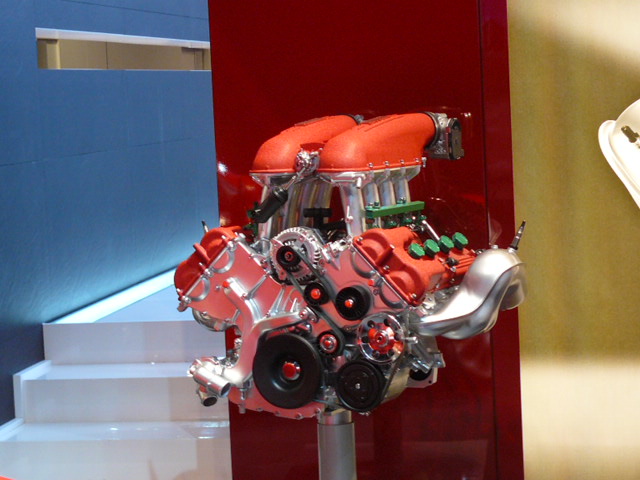

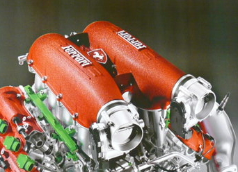

Gokart and Poopsmith are my uncompensated design consultants All I can say about the Ferrari engine is
As for the carbon fiber or fiberglass, it actually takes more labor than the aluminum; and the life expectancy is quetionable. Someone started a thread in Tech about building a composite intake.
The problem with these intakes isn't the materials or processes. Aluminum is very easy to work with, and the actual machine/welding processes I designed the intakes around are perfectly suited to a low-volume product like this. The only problem is that my life just kind of fell apart right after I started the project, and I am still trying to pick up the pieces and regroup. I just haven't had time to work on anything other than basic survival since last year.
When I get my life sorted out I will finish the design work, have some parts cut, build the welding fixtures, and start cranking out intakes. I'm probably not too far off on having 3D models that are ready for the CNC mill, then I will need to find some free time to fabricate the welding fixtures.

DarkRanger4200
Posts: 186
From: Rochester, NY
Registered: May 2007
Report this Post03-08-2008 12:45 AM Click Here to See the Profile for DarkRanger4200Click Here to visit DarkRanger4200's HomePageSend a Private Message to DarkRanger4200Direct Link to This Post
something like the Ferrari intake would be sweet but with Fiero engraved
