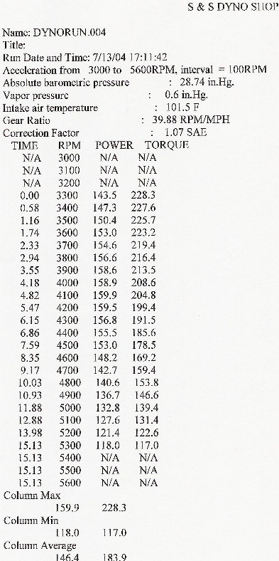

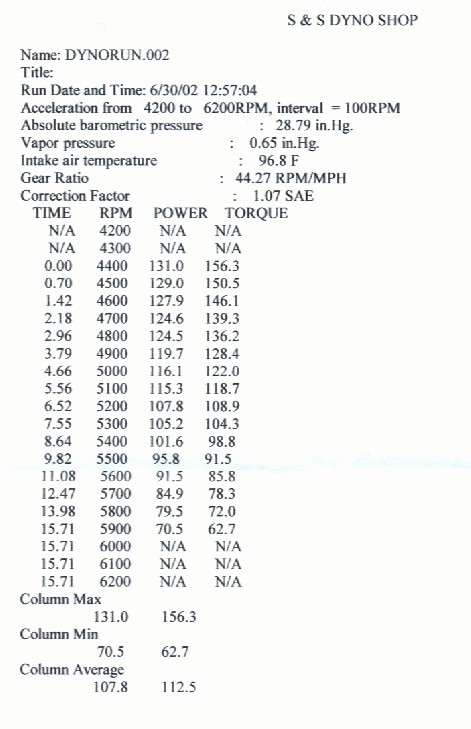

Thanks for asking. Bone stock. Rockcrawl chip (disabled VATS, adusted for tire size)
Hardly "high 14's". I don't claim it's a world beater, and the Finale is NOT a light version of the Fiero. Our car has every option and is not stripped at all.
Dyno Sheet:
Rear wheel numbers, not corrected for temperature, barometer, or humidity, and it was a HOT day. Look at the air intake temperature. Now compare that to our 3.4 that we had in the car prior. This was with underdrive pulleys, sprint headers, bumped the fuel just a tad, and 1.6 rockers:
That's a gain for the 4.9 of 80 ft/lbs of torque at 1100 less rpm and that wasn't the highest torque because we had to wait to sample until the converter locked up to get an accurate reading.
I have nothing against the 3800 sc. I own one and it's in my Riviera. It would make a great swap, but I really don't understand the people that DON'T own 4.9, DON'T have any experience with them, and don't really want to have any hating them so much. That's a mystery to me. I'm also curious as to why, if they are so wonderful, does it seem EVERYBODY immediately puts a smaller pulley on them, modifies the computer, and starts to look for more power? Did I fall asleep and suddenly those things became FREE?
To refresh everyone's memory, the original question was:
So what is quicker off the line to 60, a slightly built 4.9 or a 3800 sc??
I don't see the original poster asking about smaller pullies or computer work to the 3800sc, do you?
If you WANT to make modifications and go for more power, then the 4.9 is not the way to go. It was never the way to go for that. If you want to run low to mid 14's, run to nearly 150 mph, have a V8 rumble, be stone reliable, and still get 30 mpg when you keep it at or below the speed limits, then it's definitely an option to consider.
As to the SBC option, that was a question that was not asked. I've done one, I don't intend to do another. I don't care for them in a Fiero. That's MY preference. I'd think about a 3800 sc, but honestly the Northstar has more appeal to me. After all, a 3800 sc isn't exactly high tech..........
