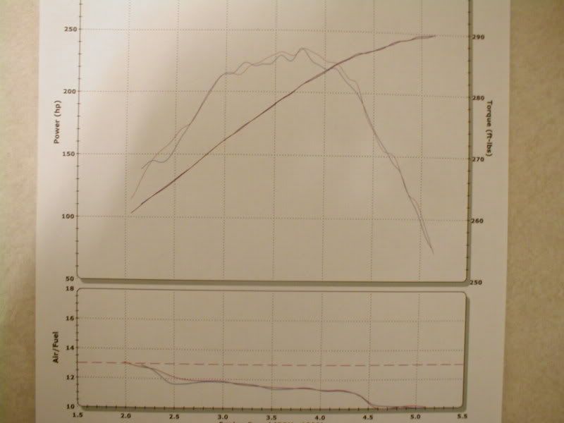

I'll have a better one for ya the 21st when i head back with more timing and corrected fuel
EDIT, In case you're unsure, the tq is on the right, and thats over 280ft/lbs at 3300.
And that's not stock, either. If it was you wouldn't need to take it to get "more timing and corrected fuel". The chart I posted is a bone stock, 100K+ mile 4.9 that the dyno couldn't even read maximum torque because we had to wait for it to shift into 3rd to start sampling. If we sampled sooner than that, the car would downshift and invalidate the readings.
If it had been a stick shift you'd have seen a lot more torque than that. Notice where the maximum torque on the motor is at on my table, the first sample taken. Cadillac rated the engine at 275 ft/lbs @ 3,000 rpm, and with the automatic we couldn't sample there, so the maximum torque is never shown.

Originally posted by WhiteDevil88:
Maybe this is more appropriate. I have a hard time comparing your dyno, it's hard to picture exactly how steep that angle of intersection of the torque curves it is at 4100 rpm. Do you have a more conventional version?
You like flat torque curves?
I don't remember who's motor this is, but how does 250 ft/lbs at 1,750 rpm sound? Link (at the engine)
This is my graph and mine is at the wheels. Link 2
