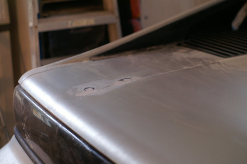

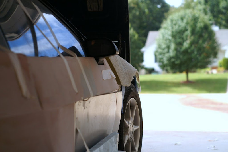

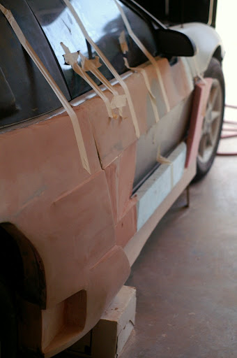

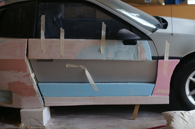

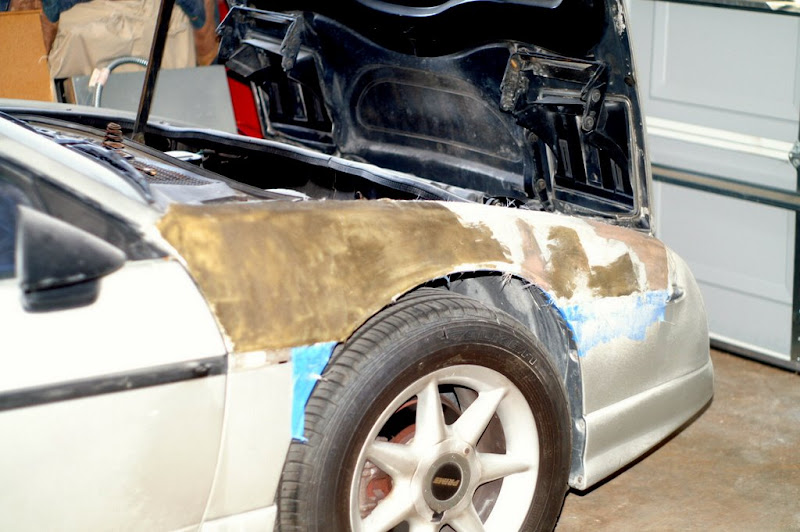

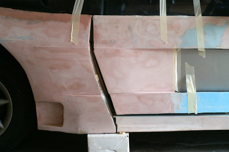

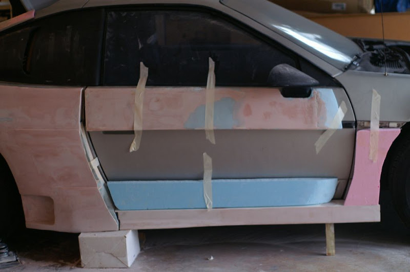

Some updated pics. Going slow but now I am starting to add some distintive lines in the body to define some things. Here is how I am doing it:
I simply used a piece of wood taped to the body to create the straight line exactly where I want it.
The I am adding the bondo to create the line. Takes some layering to get it right.
Once the Bondo hardens, I remove the wood and have my line. Now I have to feather in to make it look natural.
Maybe 1 more layer and it will look like it belongs.
Will post more when it is a bit more distinct.

whodeanie
Posts: 3819
From: woodstock,Ga.,USA
Registered: Jan 2008
Feedback score:    (14)
Total ratings: 120
Report this Post10-08-2008 10:08 AM Click Here to See the Profile for whodeanieClick Here to visit whodeanie's HomePageSend a Private Message to whodeanieDirect Link to This Post
looking better and better.
just keep telling your self ..... ( I love fiberglass! ) HA HA...............
keep up the good work!

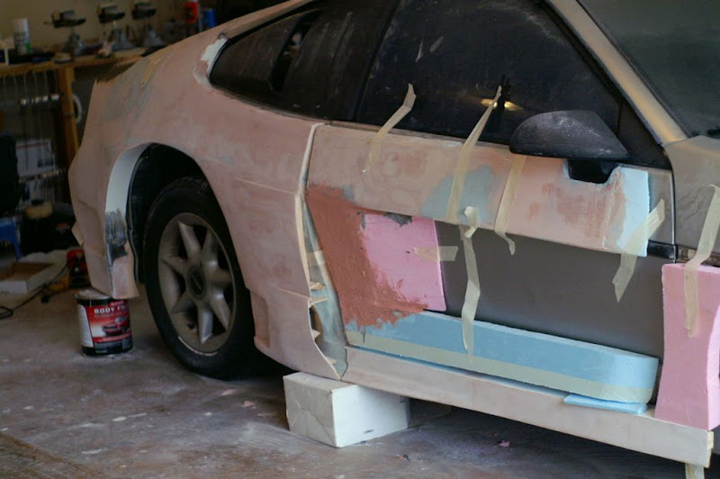

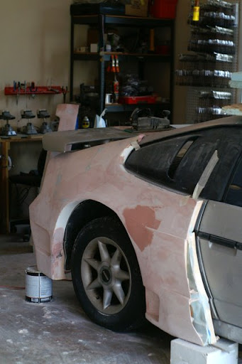

OK here goes the latest update. And thanks once again for the encouragement. I noticed from a distance that the bottom scoop (line above) was at to much of an angle, so I have fixed that and also finished the upper line as well. Also starting on the door....
I think the lines are finished here.
Now I start on the door - It will probably change a few times but I needed to start somewhere..

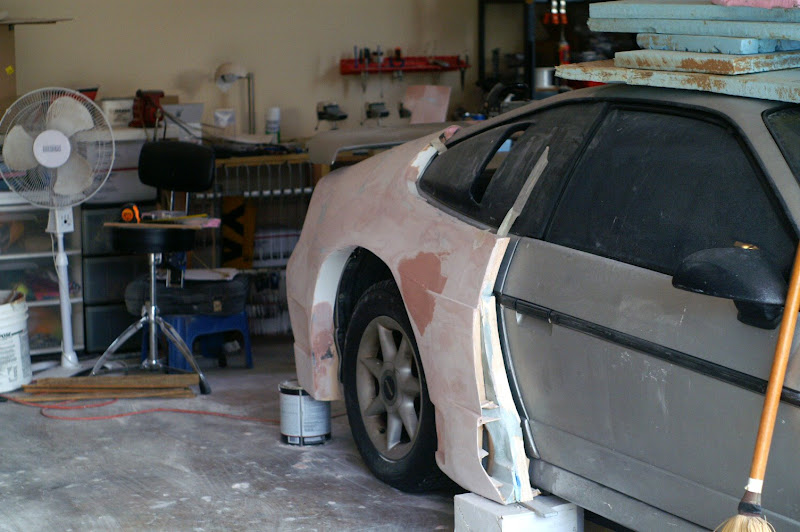

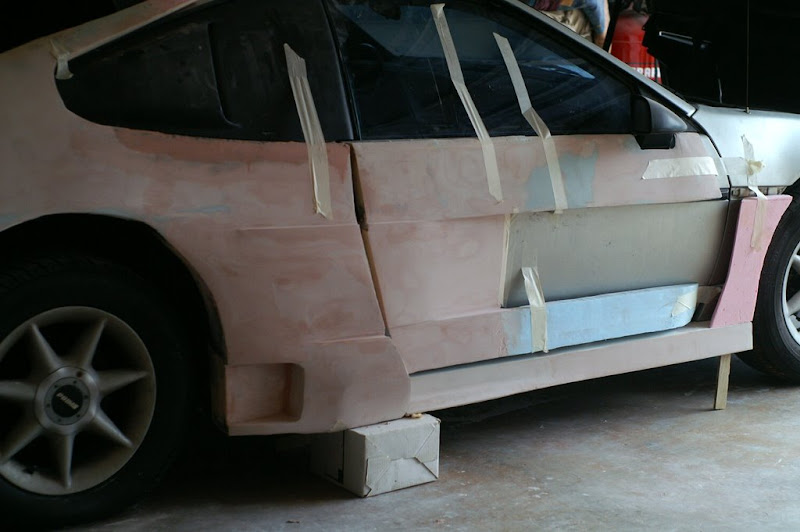

A little closer::

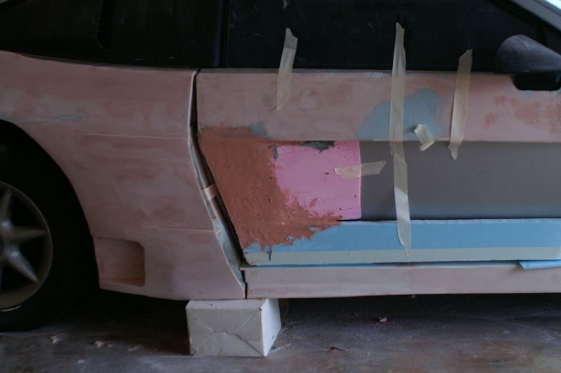

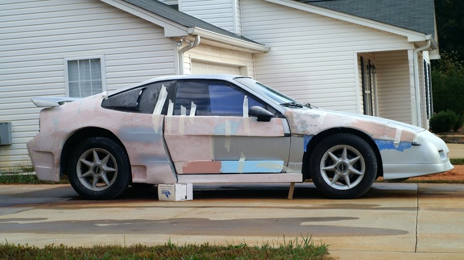

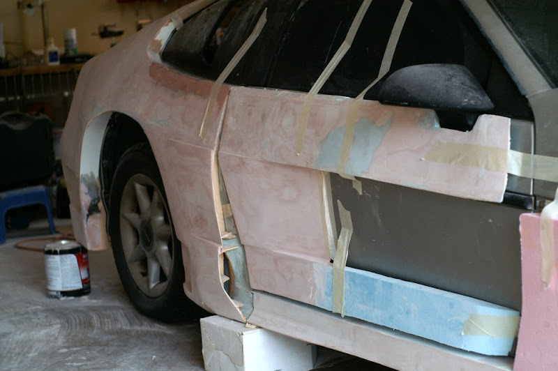

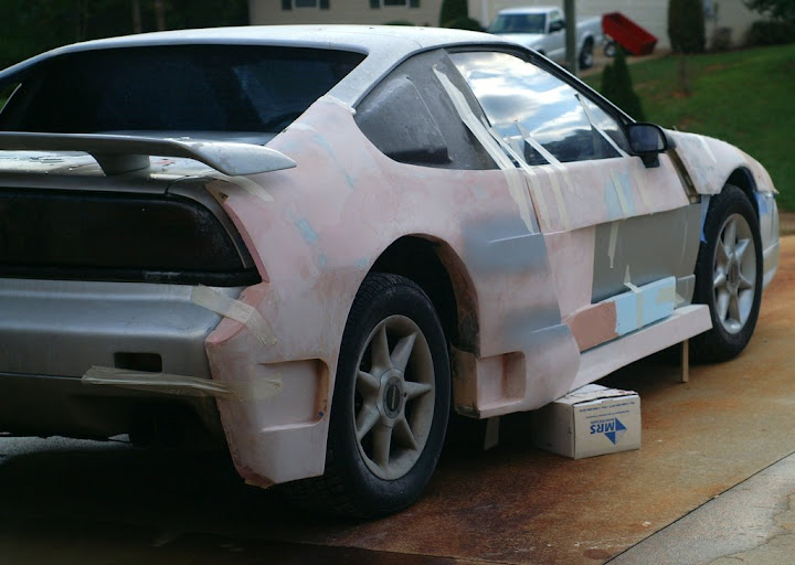

ok i hope you dont get mad but i was looking at the side scoop and it looks off when you put wide tires on it, it will look like the body rolls under so i though this would look better i hope you dont mind and its just a sugestion.
instead of tapering in taper it out
[This message has been edited by 3.6lvvt6spdgt (edited 10-11-2008).]

Whats up everyone...
I am glad to see some interest. Makes all those hours sanding and getting itchy worth it.
85SEnochie--The big question door handles??
HC hit it on the nose. I did however find them a little less expensive (around $120 for a set)
http://www.jaycorptech.com/...id=120&categoryid=17

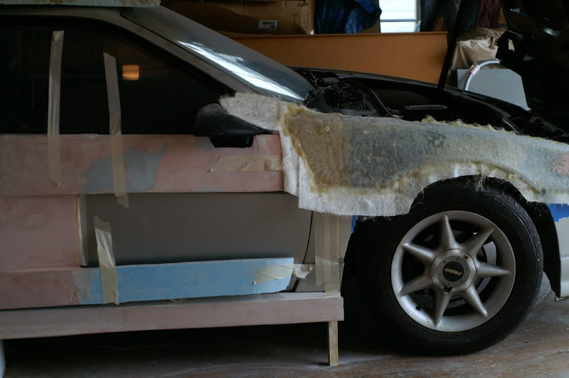

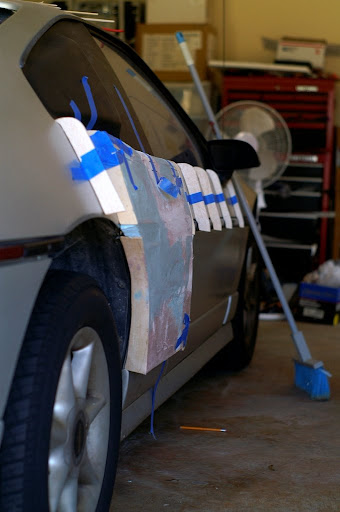

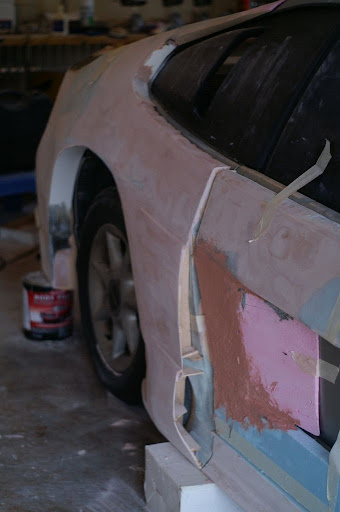

3.6lvvt6spdgt-- I would certainly not get mad. I was hoping someone would give some of there own ideas. The only problem is that I don't think it is even possible to get a rim and tire as wide as that part of the rear anyway. When I started the back, I am already a good 1 1/4 inches out without the scoop. pic below:
After adding the scoop, I am way out there.
Thats when I decided to fill in above the scoop with another scoop which solved the problem on the drivers side which actually needs the scoop to work.
Like the Lamborghini, the scoop sticks out passed the tire. I will probably only go with a 10 or 11 in if lucky which will just make the top (above the wheel) filled in.
Then again, I really won't know until I can get the cash for rims and tires. I may end up doing exactly what you have pictured.
I really don't mind your input at all. I am actually looking for it. Thanks

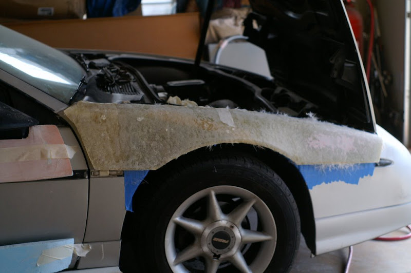

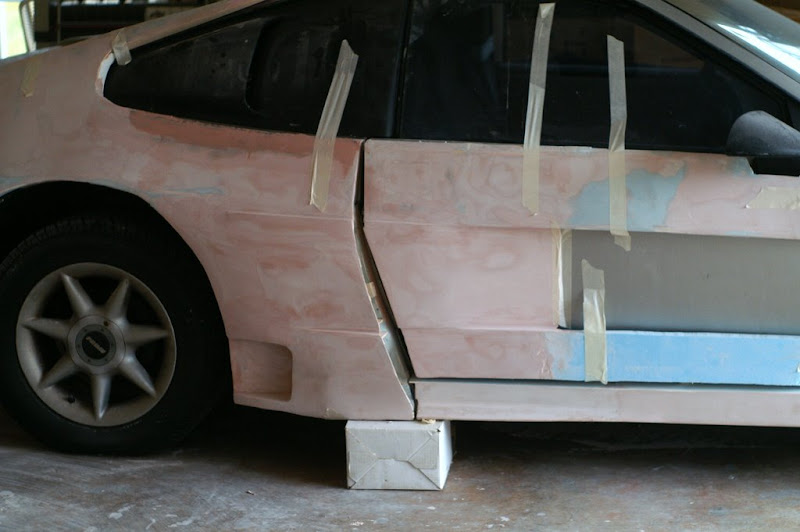

Here is some updated pics:

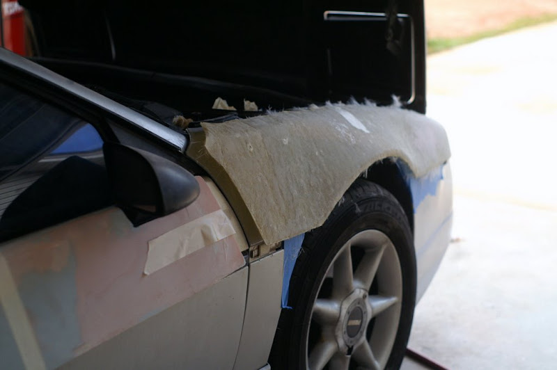

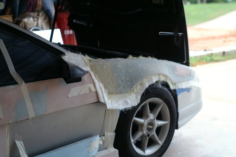

As far as the front fender goes, I am simply going to remove it and modify how it attaches to the body to get it to pop out. It will save allot of time and money besides it looking right.
Here is a link to all the pics so far: http://picasaweb.google.com/Frickephoto/TheFiero#
Thanks again

oh fron the back it looks way better nevermind its just all that bondo messing with the look.

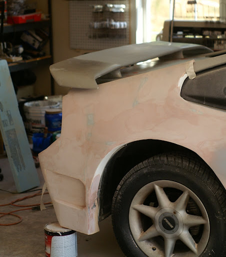

Actually, after your post I took a good look at the way things looked from the top/back and the places in the next pic where way to shallow, so I am bringing it up a bit. You can tell by the color of the Bondo where I am talking about:

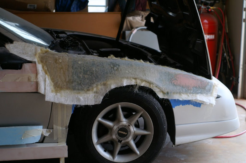

Also, on the front fender, I am simply making a Fiberglass replica and then using that to build out the front. I actually may do this to the Whole Drivers Side to eliminate the foam. I will still need to use the foam to make the scoops and such, but the glass seems quicker and more durable than just the foam and wood. We shall see.

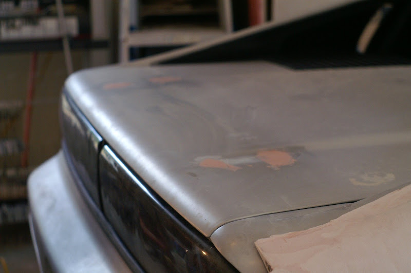

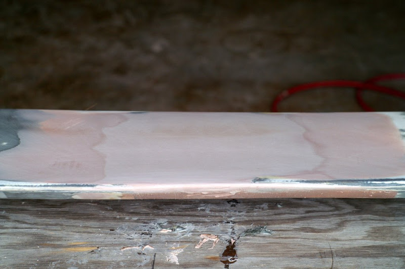

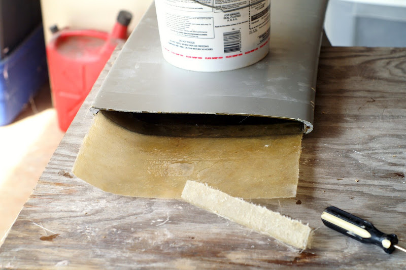

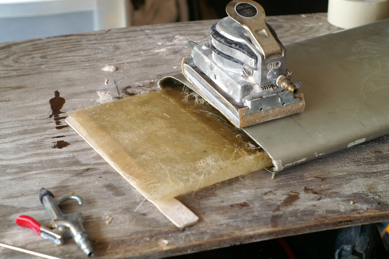

Well, I haven't got to much more done. I put a few layers of glass and trimmed up the front fender. Below are some pics of how I intend to place the panel to match the rest of the body.
Instead of using just reg. Bondo, I am using a Bondo/Glass to do the initial leveling out and smoothing. It is more durable than the standard Bondo.

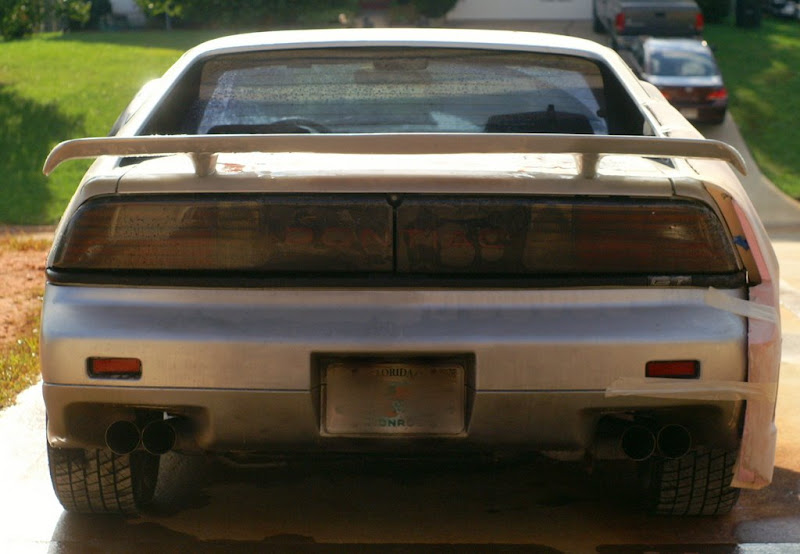

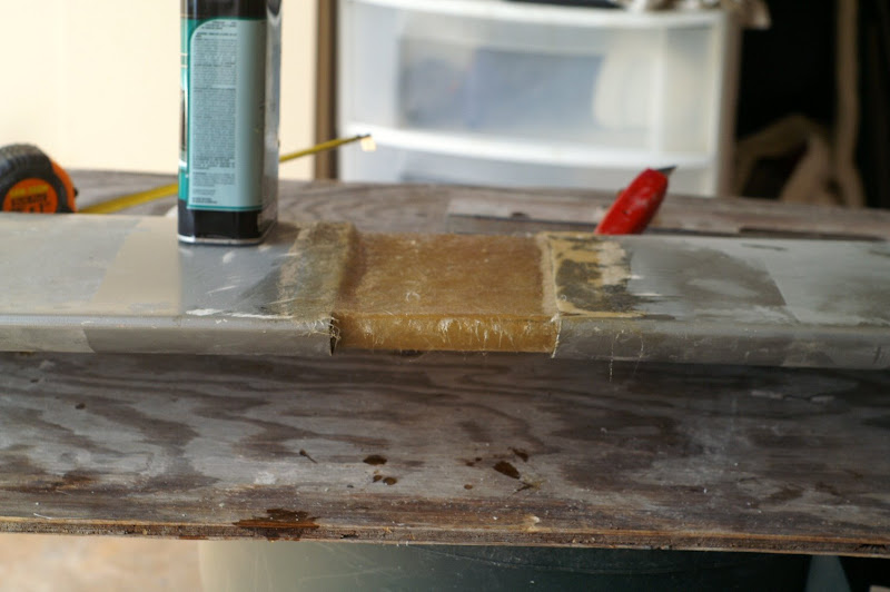

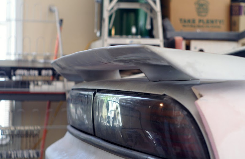

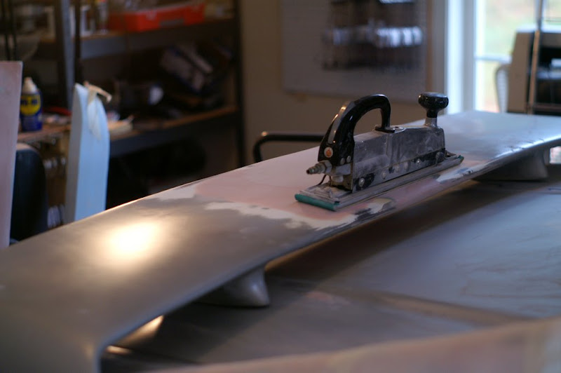

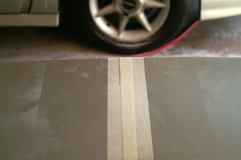

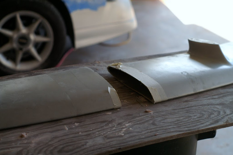

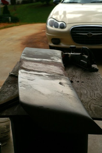

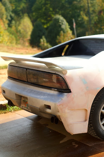

Well, I did IT!! Cut the wing in half::::
READY..
SET
OUCH..
It was a bit nerveracking, but I had to do it. Below are more pics as I am progrssin with it:
Back together again!! I extended it 5 1/2 inches
Getting Better
How it looks on the car::::
ANY Questions??
[This message has been edited by Mailmule (edited 10-17-2008).]

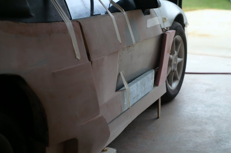

what are you going to do wit the center section of the door where it meets the rear quarter?
are you going to bring it out flush with the quarter?
it is looking great keep up the good work. lots of hrs.
Mailmule
Posts: 89
From: Lula, Georgia
Registered: Aug 2007
Report this Post10-16-2008 05:43 PM Click Here to See the Profile for MailmuleSend a Private Message to MailmuleDirect Link to This Post
The center of the door will look like this:

well you like my photo chop before so here is an idea for you.
i think your side looks to plane so heres what i came up with.
the red lines show the new cuts needed and the blue show shape. what do you think?
nice work on that fin that looks sick

Once agin, you have some great ideas. I wish I had another Fiero to try all f them out. I DO like the way you brought the middle door out to meet the quarter. It is kinda bothering me, but the reason is because I need that scoop to actually function on the Drivers side for the air intake. If I bring the door out to meet it, I will be blocking that functionality (unless I find a way to make the door portion part of the air intake) . Those openings you see (the scoops) will have some sort of grill when finished. I just don't want to go making anything like that until the finished product. What I don't like is the way you cut the top of the door. Just doesn't do it for me. Let me see if I can do some moch up's and post them for criticism.
Thanks for the ideas once again.

the scoop could be still used, just ,make it so there is a vent at the back and a vent in the back panel. basicly make it a tunnel you could use some mesh in the door jam to alow the air to go to the back. also with this vent you could keep your door handle and kep it hidden.

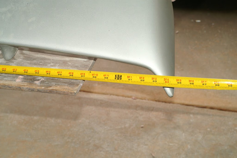

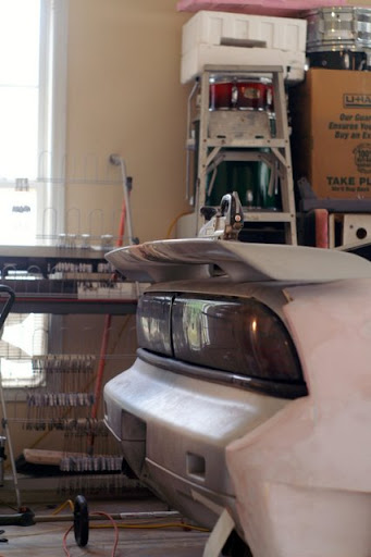

Well, the wing is just about done. What would you pay tohave your wing extended???? Let me know, I may take on this custom wing deal.
Cant see the ruler, but it is now about 66" long. I didn't measure it before I ut it, but I can tell you it is 5 1/2 " longer now.
If I would have thought of it when it was cut, I could have installed a really nice 3rd break light. Damn!!!
Just about ready for Primer. I will finish the bottom side and prime it tomorrow.

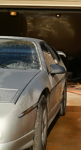

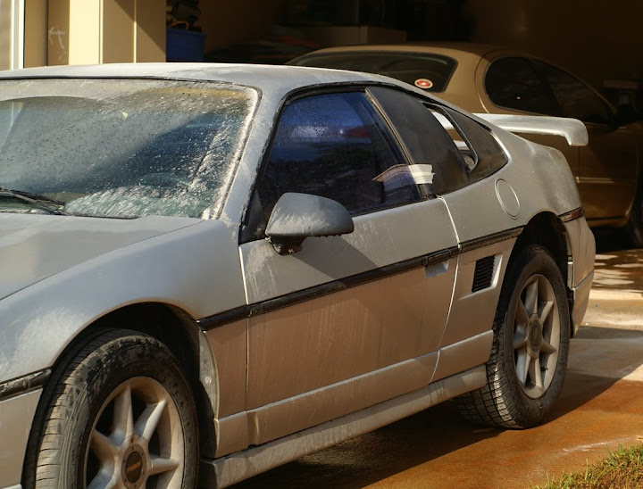

The wing is primed and mounted. Waht do you think?? Also, I pulled it out of the garage to get a wider view on things. I am pretty satisfied so far.
Here are some of a wider view::
This is what the wing looks like from the drivers side and no mods to the body.
A few more of the whole car::
http://lh3.ggpht.com/Fricke...Y8/s912/PICT1030.JPG
Here is a link to all my pictures: http://picasaweb.google.com/Frickephoto/TheFiero#
[This message has been edited by Mailmule (edited 10-19-2008).]

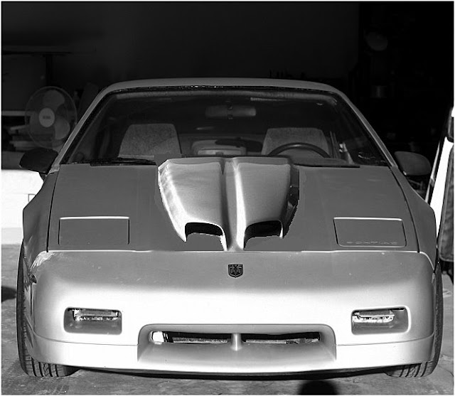

Yeah I knew that going in I guess. This is my idea for the hood. Pontiac style Ram air from a Trans AM
