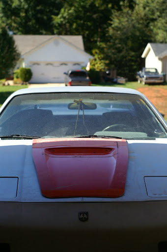

Look what I picked up at work today. What do you think? It is off a 2002 Mustang. Nice thing about it is that is is all Fiberglass, so it will be easier to cut and modify.

I like it !
10 times much better than that other style you were considering.
Posts: 33125
Total ratings: 399
Report this Post10-22-2008 07:24 PM Click Here to See the Profile for Jake_DragonSend a Private Message to Jake_DragonDirect Link to This Post
Its backwards.
ALLTRBO
Posts: 2023
From: College Park, MD
Registered: Mar 2006
Report this Post10-22-2008 08:13 PM Click Here to See the Profile for ALLTRBOSend a Private Message to ALLTRBODirect Link to This Post
Its backwards.
Ditto... for functionality, anyway. If you reverse it and put it at the front of the hood, it'll extract heat from the radiator and help keep your front end planted at high speed.
Either way, I agree. It's much better than the T/A nostrils. IMHO, they only look good on the cars they came from.

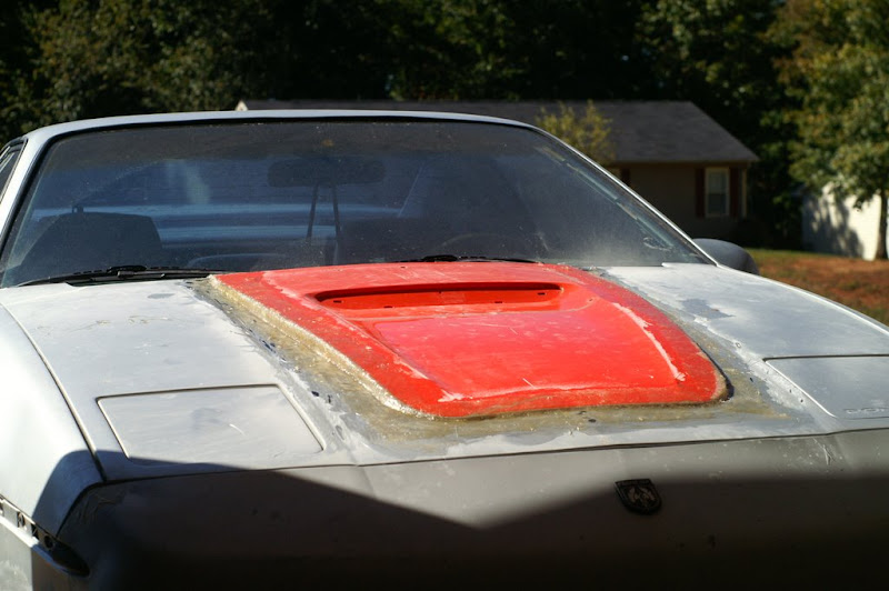

ok, latest pics and progress:

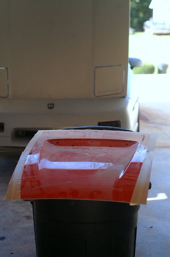

Cut up the Mustang hood to my liking:
The left overs:
Lining it up on the car:
And Yes, I did cut a hole in the hood to find a way of making it Functional at some point:
This is the first layer of Glass and final position:
Let me know what your thinking?

I would suggest trying to keep that line in the scoop.

Why make a mid-engine car look like it has an engine up front? Get a comaro or firebird, it's easier. In addition a Fireo can make good use of an extractor scoop up front. Back in the 70s we use call cars with none functional or unneed scoops etc Cosmetic Cars, still fits. BTW: I'm sure your end-result will look fine workmanship-wise. Mine Fieros are too out there scoops-wise for most, but each one works 100%.

I would at least mold it in flush with the hood... but as everyone else is saying.. why not turn it around and make it functional? even with a duct to it, its pointing the wrong way to be functional..

Why in gods name did you glass it on top of the hood instead of flush?

Rookie fabricator mistake but that is his car.

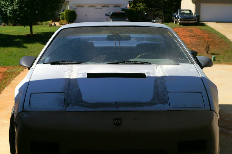

OK, now that you all got that out of your systems. I know where you all stand. Thats cool, and like you said it is my car. But let me clarify a few things. The Fiero has NO hood scoop factory. So what is the difference if I add a few eye appealing body lines? I mean the mustang it came off of WAS a front engine car and this scoop wasn't even functional on that. Also, I did cut the hole in the hood so I could easily modify a tubing vent it toward the radiator for extra cooling.
And you ask why I didn't mount it flush? I have 2 reasons. First is I wanted a little bit of a raised look. Second is beacuse I couldn't cut the scoop down any more and still fit the additional inserts that go on top off the vented part. I would have literally have had to almost cut the origianl hood in Half loosing any structural integrity. I do however appreciate the comments good AND bad.
Here are some more pics (like it or not):

Not bad.

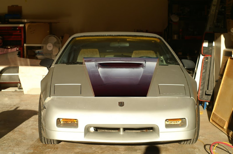

Well, pretty much done with the hood for now. A few spots I will fix before painting, but 95% done.
Here Goes::::

Not bad at all!

From a purely cosmetic standpoint, I really like it.
Do you have the black plastic cover for the "opening"?

You better take a mould off the whole thing now to make a new skin for your hood because that bondo will crack. There is no avoiding it as Bondo shouldn't be used as thick as you have used it. With Bondo, 1/8" is already too thick. It appears you have it 1/2" thick. Slam the hood down a few times. Save yourself some grief before painting it.

Please don't take my suggestions wrong either as I am trying to save you some grief. The overall concept isn't bad. The execution will kill you though.
The scoop has potential to be functional with a few well placed vents..

Mailmule, I like what you did. Closing in the sides to make it raised really gives it the look. And I agree with Aus about the bondo...
Also.. Aus, you nailed it with those vents in the front. Made a good idea even better!

Looks Maranello....ish. I like it, it looks good. I even like adding the front vent idea. Yeah thick bondo is bad buisness. You may have better luck with that stuff....... whats it called........ kitty hair? You know its like resin/filler with fiberglass strands in it. Your doing great work. Keep it up.
