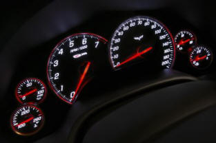

Is this photo of the Corvette gauges, or the Camero set?
Those are the Camaro gauges

I would be interest in one of those Vette clusters. What is so special about them, that makes them hard to wire up?
BTW, if you dismantle any more C5 vettes, I am still looking for the dash parts as well. I guess what is making it hard to find is that I am looking for a dash with HUD.
Don Z.
I don't know that much about the wiring, I think maybe the cluster doesn't have a tach input as it gets it from the engine computer??? Ask jscott1 or someone that knows more about them and the wiring.
I can tell you that finding a dash with HUD is not a concern. My main business is HUD retrofits into early C5's, and all C5 dashes can be easily modified to accept HUD>...HOWEVER...if you want to install it in a Fiero, you're going to have to leave lots more dash than I did, which will cause the dash to stick into the cabin severely (another 6" or so minimum). That changes the entire geometry of the install,and I don't think it would work nearly as well. It would push the radio console back, not leaving room for the rear console, etc.
There are other HUD options in the aftermarket that might be easier...or you might consider pulling the C5 projector apart and placing the components in the dash area separately as most of the projector is empty space for mirrors, etc.
Best of luck!
It's not the Vette Cluster per se that's hard to wire up... But like OBD2, around 97-98 timeframe GM started using a serial data bus to wire up all the body conrol modules including the cluster in that mix. The Fiero and earlier clusters use analog voltages going to analog gauges. To use the vette C5, (or just about any other modern gauge) you would have to have an analog to serial data conversion, or build your own custom interface, (as Riceburner98 is proposing).
To avoid all this mess, you are going to want to use an "older" cluster.
FYI - Since pretty much all modern cars use all this fancy electronic hardware we are generically facing a dilemma that we neither need to figure out how to adapt all these fancy electronics to the Fiero, or forever be resigned to using the old parts. I think the market will step up and find ways for us to use the moden hardware on our cars.

So if I already have the series 2 computer in my Fiero, running a 3800 S/C engine. Should I be able to use the Vette cluster?
That might make it a bit easier to hack the system, but it's still not going to be plug and play. The software to run that cluster I'm sure is not in the 3800SC computer. Someone would have to figure all that out and write the code. If you were running an LS1/LS2 I might says it's a bit more possible.
It's way above my level of understanding to figure it all out. Maybe 20 years from now when all the old analog electronics are gone, I'll figure it out.

I did a little reseach, today. You are right. The Vette cluster's serial data link is over my head. I still like the looks of the Vette cluster. So, I will make it easier on myself and convert the cluster to the Fiero gauges. (Putting the guts of the Fiero cluster into the Vette Cluster). This will make it easier to mount the gauges, back into the dash and I will be able to use the Fiero wire harness.

Originally posted by Amida:
Bob, that cluster looks like it could fit in my new Fi360 dash. It'll be interesting to see if you could make it work in the Fiero.
I got the cluster today, thanks pacethis! Amida - it turns out that the cluster is not at all "flat" like the picture seems, all the gauges are mounted at angles and at different heights in the cluster, so it would be tough to create a non-Vette faceplate for this guy. Also, they're using (in my opinion) ancient technology - Front-lighting the cluster, like the old 4 cylinder Fiero gauges! I'm sure they have a fun way of doing it with either a flourescent light or a blacklight or something, but it's all front-lit, behind the gauge graphics is solid black plastic, there's no way to back-light them. Very odd. Even my el-cheapo Scion and Kias use some decent LED backlighting these days.
--> Pacethis - do you know what they have for a "front-light" setup in the rest of the plastic? Is it a blacklight that makes the white glow, or is it just a flourescent light? The big honkin' inverter on the back looks like a beefed-up CCF light driver.. I always just thought it was there to power the flourescent text display at the bottom of the cluster. The gauges look real cool, but not sure if I'm going to spend much energy getting into them since I probably won't use them in my Fiero and the front-lighting just kind of kills it for me.. That and there's a custom AC-Delco chip driving the vaccum flourescent text display, so that pretty much rules out finding any kind of chipspec for it and getting that working. I'd have to replace it with an LED display.. Definitely the strangest internals of any instrument cluster I've ever seen!
(Edit - found the front-lights on Vetteessentials (seen on the left side of the picture, look like blacklight tubes)... Interesting!) I've got a blacklight around here somewhere, gotta see what it looks like..
WOW. I take that back about the "ancient" front-lighting... Hooked up a blacklight in front of the thing and it's really cool. Everything just glows really bright. The only downside is any dust on the thing also lights up like a Christmas tree.

Report this Post12-14-2007 04:29 PM Click Here to See the Profile for pacethisSend a Private Message to pacethisDirect Link to This Post
Yes, it's 2 blacklight tubes, controlled by the box on the back of the cluster. While it may not be current design protocol, the front lighting is very nice with the blacklights. Keep in mind these were released in 1997, with designs necessitating back to 94-95. Not sure how the new C6 ones work, haven't played much with them, maybe they've updated something...
I used to sell the inner bezels, but I've recently had a sale on them and cleared my inventory of them (about 15-20) last month. I've been concentrating more on BMW E38's for the last few months as Corvette prices are up on salvage...
