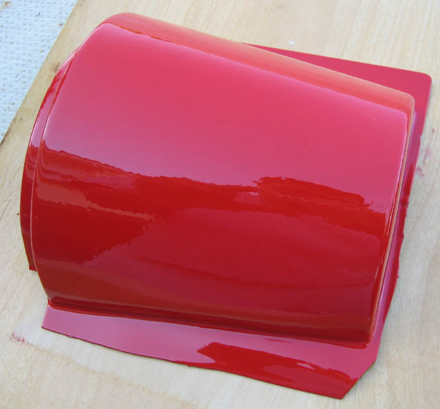

So what's the latest? I took my small gun yesterday and did some practice pieces with the color I will use. Spraying is easy but knowing what you do is not! I wasn't sure if the paint knob was open too much or too little, if the pattern was right, if the distance I was using was the best... Oh well. Many variables. At the end I was surprised it came out so good but I would be paranoid when I do the car.
Practice scoop. This came out perfect.
Practice panel. Came out good. With the basecolor recently done it looked like it would have a lot of orange peel but when it dried it came out great.
And this is why you should use a booth of some type. One is a little bug. The other two I'm not sure.

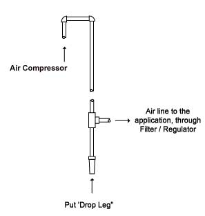

Do you have your hose running on the ground?
There could be too much water for your filter you could try a drop leg
