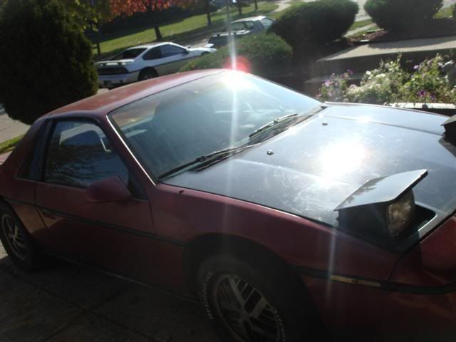

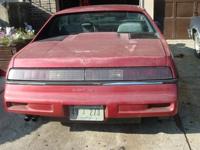

I recently purchased a 88 coupe that I'm going fix up and use as a daily driver while I finish my 87GT project. I'm not going for a show car on the 88, just want it to look good. My goal is not to spend over $400 in materials to paint the car. Also, I don't want to put a bunch of time into the car either. I see a lot of threads on here about painting Fieros so figured I would start this thread showing steps to a basic paint job. Heres some pics of the 88 before I start

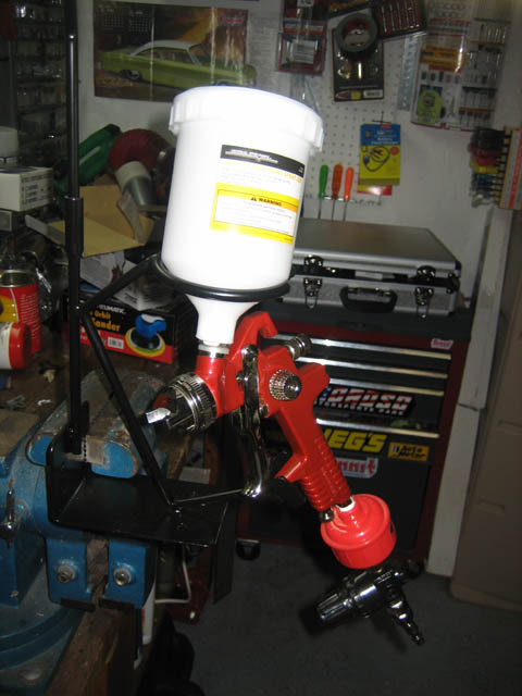

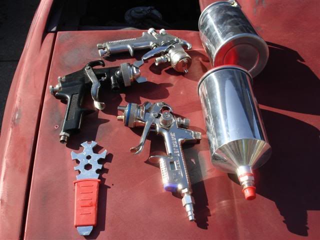

Heres the guns I'll be using
Don't need a good primer gun, a cheap one will do just fine. Mostly because after I get the car in primer I'll be block sanding it to make sure the body work is straight. For the base and clear I'll be using a SATA RP gun. Best gun I've ever sprayed with IMO.

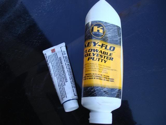

Glaze to finish off the body work

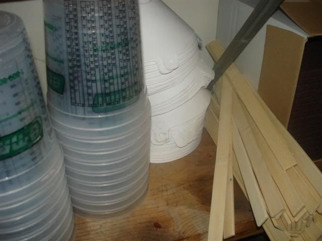

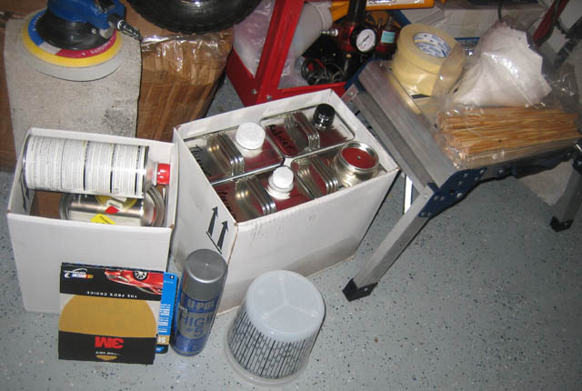

Paint cups, strainers, sticks, red pads to scuff the small areas
Primer
Base, clear, reducers, activators, wax and grease remover, tack rags, body filler, sand paper, tape, razor blades

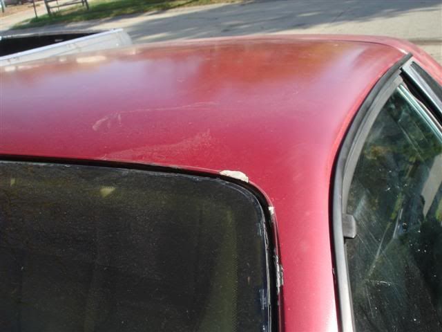

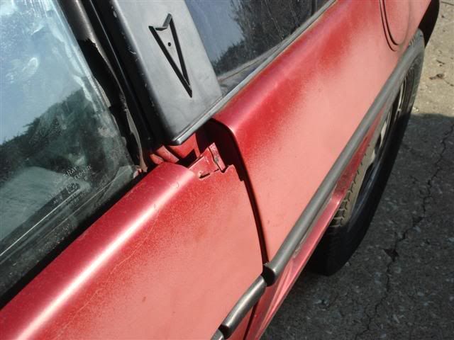

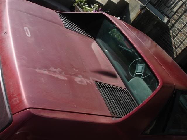

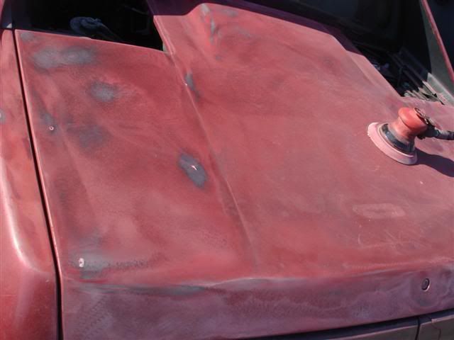

Theres is some body work that needs to be done. Mostly deep scratches and chips on the roof and decklid. Also, there is a piece that is broke on the door, and a hole in the fender where the antenna use to be. When you want a great looking paint job you would R&I (Remove an Install) all the molding, mirrors, bumpers, ect. But, like I said I don't want to spend much time on this paint job. On my 87GT I'm in the process of painting, I stripped the car down to the frame and doing a off panel paint job. On the 87 I'm going with House of Kolor Kandy Tangerine over silver metallic above the molding, and black diamond metallic on the bottom. Also shaved from the rear bumper to a under the hood. On the 88 I'm going with Blue Ultra Pearl.

LOL.......you went fairly inexpensive with the paint yet you have a $500.00 SATA digital paint gun

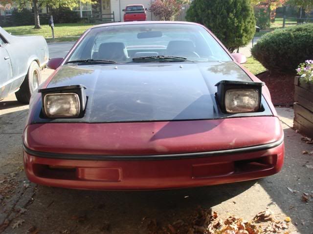

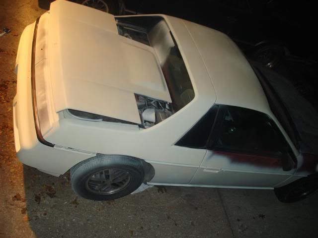

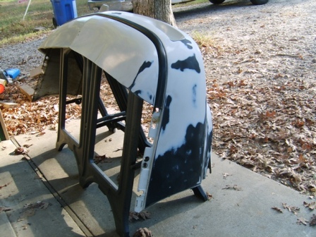

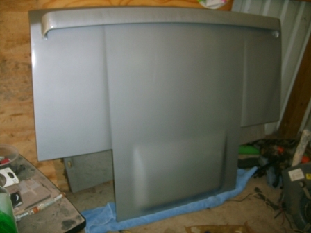

So far I have done most the body work, and finished the car off in 320 grit. For tight spots that I couldn't hit with the DA I use a red scuff pad. I went ahead and sprayed primer over my body work just in case it rains, I don't want water to hit the bondo. Pretty much the rear end of the car I sprayed so far. Can't put the car in the garage because my 87 is up on jacks lol. I sprayed the primer outside, not too worried about debris getting into the primer because I will be block sanding it out. Lucky, nothing got into the primer while drying outside.
I know I said I didn't want to spend a bunch of time on the car, but should of took a little bit more time masking it. Nothing that a razor blade can't take off Tail lights are getting replaced either way so thats why I didn't mess with making them off.

Report this Post11-11-2007 09:52 AM Click Here to See the Profile for jscott1Send a Private Message to jscott1Direct Link to This Post
What's the deal with the trim on the bumper? For some reason you didn't prime it.

Report this Post11-11-2007 10:06 AM Click Here to See the Profile for greengoblin0129Click Here to visit greengoblin0129's HomePageSend a Private Message to greengoblin0129Direct Link to This Post
There was still body work that needed to be done to it, plus it had tape still on it that I couldn't get off. At some point someone did a rattle can paint job on it and didn't take off all the tape lol... now it won't come off for nothing. Only reason why I got it in primer was to seal the body work because the up coming weather. Right now it's poring down rain

This is great! Could you post more details on your prep, spraying, etc? Definitely you have experience on this so it would be great to share. After debating it for a long time I decided to tackle this job myself but I have no experience other than an art background if that helps. LOL! With body shop bills so big (especially where I live) I thought I could save some $$ and I can use the experience in more than one car. I'm not looking for a show winning result and my jobs are for same non-metallic colors so it shouldn't be that hard. My red car top is the one fading so that is the candidate. I have already spent near $600 in tools (guns, pneumatic sanders, etc.) and paint material for this job. I just started playing with a cheap gun and some leftover paint I had spraying on some flip-chart pads. There is so much to learn, I mean stupid thing like what are the knobs for at the gun and even what is the best way to clean it. I have no clue Then I have couple of panels to practice on the real thing. I'm not in a hurry but want to learn quickly
Paint supplies
Ok guns
Play gun
Flip chart to practice spray pattern and play
Practice, practice, play!

The knobs on the guns are different between manufacturers. You usually have one that controls how far back the trigger goes. This one controls the amount of paint that comes out with the given amount of air. Another one controls the air pressure coming out of the gun. The last one (usually) will spread the spraying paint from a small circle to a wide oval shaped fan. Read the instructions on YOUR gun then experiment. Too much air in a gun that dont need it can blow up in your face spraying paint on everything. Too much air pressure will also fill the air with paint instead of just your car (overspray).
As for masking, its still easier to take a few seconds to mask off something than go back later with laquer thinner or a razor blade and try and clean it. I keep a piece of old metal (old licence plate in my case) to keep from spraying anything on something when im priming just a spot. I just hold it over what I dont want painted. Garbage bags are good for throwing over tires and wheels in a pinch.

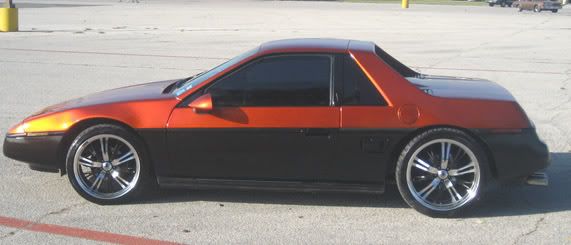

Hmm, I bet that will look good...
My 88 Coupe with HOK Tangerine Kandy over Orion Silver above the trim, PPG black w/ gold pearl clear under the trim
Man, guess I have to go with a different theme now lol! I didn't think any Fieros had that kind of paint job. Thats 100% what I was going to go with, except on a fastback. Is that real kandy or the base-coat version? I'm going with the base-coat kandy because knowing my luck I'll get a scrach on it, and real kandy is almost impossible to match. However, theres nothing that looks better then a true kandy paint job haha. One of those colors you have to see in person, pics just can't justify the paint.
