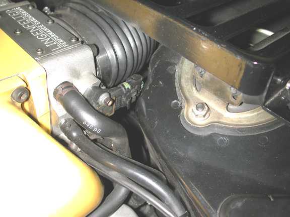

Great job Alex. It looks fantastic.
Question, though... Why bring the TPS sensor up straight and not leave it going out the front? If there is an interference problem, why not make a pigtail that's soldered to the TPS pins? That should give you clearance.
At least on 88s the stock TPI TPS points forward and the shock tower is in the way. Someone here suggested using the 4 cyl Fiero TPS which I tried. Problem is that it is still too tall for a coupe grill and also for some reason (maybe because it is not an A/C Delco) it is not reading as it should (.5-4.5++V). This is a very critical sensor so I need it to work right. So now I will try to mod it as shown in the first picture on this thread; https://www.fiero.nl/forum/Archives/Archive-000001/HTML/20030531-2-030342.html

Alex: Will the sensor clear without the connector plugged in? From this pic, it looks like it does:
If it does, all you need to do is make a pigtail that has the wires soldered directly to the sensor pins. Silicone the end to seal it. The pigtail will connect to the existing connector.

Report this Post12-02-2004 08:25 AM Click Here to See the Profile for Alex4mulaSend a Private Message to Alex4mulaDirect Link to This Post
Look closely at that picture. That area in front of the TPS has been cut a big shunk. Also that's a Zumalt kit (if I remember correctly, CalKid car?) which gives more clearance in that area (adapter plate is thinner). This is the clearance I have in my car in that area;

Report this Post12-02-2004 12:13 PM Click Here to See the Profile for RCRSend a Private Message to RCRDirect Link to This Post
Eww... That's pretty tight. Sorry, no more ideas here. Looks like moving the TPS is the only real choice. You might want to check the resistance value of that 4cyl TPS. There's no real reason why it only goes 1/2 way unless the value is different, or the travel is different. It is looking real good, though. Even if you did take the Tin man's arm.
You are correct, I'm running a modified Zumalt Kit, placing the engine further to the left.
I've seen a vertically mounted TPS that will get you more clearance without doing severe surgery to the shock tower, believe Archie would have the details on this sensor.
I just did that Still need to work the linkage a little better but it is working.

Steel mount, kinda rough looking.
Rubber mount pic

Well you can drill a hole in the end of the crack then take a grinder and open it up.
Weld it then grind smooth. I would also weld on a plate to help distribute the load.
If thats your weak point then its going to crack again.
I hope to avoid this by not leting my motor move on the cradle, thus not letting it load up every time and cause those stress cracks.
Solid mounts will be used on motor and tranny.
I also dont plan on driving the car every day so if its a little harsh I wont mind.

I bought a 1/4" plate to copy the pattern and weld it underneath the area. That should fix that one for good. I'll weld the cracks on the top too. At least at the end this will be a better install. Hope to be ready by Daytona. Still so many little things to fix and do and only three available work weekends before it
That should do it.
Do drill a hole in the end of the cracks before you weld them. That will stop the crack from getting longer.
I had to start driving my GT so I wont be starting the V8 swap as soon as I want.
