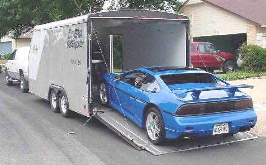

Let us know how it turned out. I know how excided you are. I remember when I picked mine up.
More photos, http://www.cardomain.com/member_pages/view_page.pl?page_id=278279

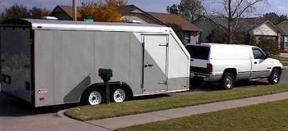

Nic, I'm also using an equalizer hitch, and Dual cam anti sway system. I'll post a few photo's. The Dual Cam setup makes the towing so nice. Used to have that "white knuckle" grip on the wheel when trucks would blow by, or with cross winds. Now, there is no sway and the setup makes it feel so solid. I keep looking in the mirror to make sure it's still there !!
(following copied from Open Roads fourm, Posted: 11/19/2003)
Okay, just got home from the dealer. Were having some 10 - 15 mph winds & rain, on the way down, I barely went over 55, the trailer was swaying a bit when the wind hit it.
Along the way back home, I kept trying to put into words how the truck felt with the new dual cam sway control installed. It did feel different.
As I was watching another trailer in front of me, that was swaying , I then realized the words I was looking for. HOLY COW !!!! What a difference.
My vehicle wasn’t swaying at all. The wind would blow across the highway and the guy in front would go all over the place. When there were trees blocking the wind, he had no problem.
If felt as if was driving a one piece unit instead of a truck towing a trailer. I was able to relax and not have that white knuckle grip on the wheel. The ride was as if I was only driving the Suburban !
It really surprized me how sturdy/secure it felt. Boy, what I've been missing !!! I'm glad the wind was blowing across the road, it really was a good test. A few trucks passed me, I could still feel there wind push a little, but it no longer felt as if I was out of control.
The dealer showed me a way to hook up the W/D bars that was diferent than the way I usually do. He said to back up to the trailer with the tongue right above the ball, then hook the spring bars up, tighten with the chains, this would push the hitch/ball up into the tongue. Then lower the jack.
He called it preloading the weight.
I used to just back up, plop it down on the ball, then tighten the spring bars with the chain. He said this way would not do as good a job.
Here’s the before & after shots. We swapped the spring bars.
(the final adustments were not done as this photo was taken)

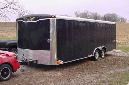

Actually yes...
Here's one from this thread...
https://www.fiero.nl/forum/Forum1/HTML/047650.html
Sorry that it's so dirty in that photo... We had just come home from Minnesota the evening before, and had driven through 2-3 inches of snow most of the way. I've taken a few more since I bought it, and they were taken while it was clean, but I haven't loaded them into the computer yet. Maybe I'll get that done here this weekend.
Nic

Oooo man I'm laughing so hard right now, for a second I thought that the fiero was actually hooked up and pulling that trailer lmao........ I should get some sleep shouldn't I lol.

Hmmm, very nice. Tell us about it's 1st loaded trip.

Take a look at the front of my 1996 Pace enclosed trailer. The angle on the front is very helpful with mileage, my Dodge Cummins gets about 14-15 npg under tow at 70-75mph. I have pulled enclosed trailers without that angle, and my mileage dropped to 11-12mpg under the same circumstances (I get 21-22mpg without a trailer, for comparison).
This trailer has about 250,000 miles on it - as a lot of people on this forum know, I haul cars as a sideline. I have hauled Fieros coast-to coast and border-to-border with this trailer. Also to/from Canada, and even have a request to take a car from Gualajara, Mexico to Archie's next month.
In this trailer I have a carpeted floor (so much for the slick floor discussion) and vinyl walls. It also has a winch, tire rack, jug rack, 12v lighting throughout, and a Craftsman roll-away tool box bolted to the floor and wall (all from when I used it solely as a race trailer).
You can see some of the interior in this photo loading up in San Antonio for a haul to Illinois.
The biggest thing that I need to point out is that my trailer is just 18'!! The Fiero is exactly 14' bumper-to-bumper, and that 4' in front of the car is more than enough room - at least most of the time - for my needs. I carry spare engines and trannies on the space in front of the car, plus customers often have spare parts that I haul with their cars. All in that 4' x 102" space (in addition to all the other "stuff" I mentioned earlier that is already permanently mounted in the trailer).
An 18' trailer is so much handier maneuvering and parking - both in the 'hood and in parking lots/restaurants/etc. It fits readily into a double parking spot - the same space as occupied by two cars nose to tail. That is why I made the 18' choice so many years ago - and I don't regret it.
Was it hard to find the correct balance ? How'd the truck do ? Have any shots with the truck hooked up ?
Um, err, you were using a truck, right ? lol
Thanks!
The first loaded trip was interesting. I've hauled several cars before when I worked for a large car dealership, and delivered top-end cars in our enclosed trailers. I never thought of the fact that they all had the engine in the front, and the Fiero has it in the back. So, within about 8 miles of highway driving, I was turning the car around.
The first serious loaded trip went well... The weekend after Thanksgiving we went to Elk River, MN to pick up my Formula I bought from Darrell Morse. Once we got through the Friday evening traffic/construction in Minneapolis that night to our hotel, in was a decent trip. We drove the 300+ miles on Saturday; never had any bad luck except a few inches of snow, and wet roads. I'm pulling it with 2000 Chevy 1500 4x4, with the 5300 V-8. It does fine around town, and even with hills and interstate speeds (70 MPH); but headwinds really hurt my ability to keep with traffic. Loaded with a light breeze, and interstate speeds, my mileage was around 8.5 to 9 MPG. This was right where I expected it... But, once we turned west and drove into the wind, with some good sized hills for about 50 miles, it dropped to almost 7! If I had utilized some patience, and let the truck slow on the hills, or just drive slower altogether I'm sure I could have kept the mileage up a little higher. Instead, I kept it at 60+MPH, and wanted to find out just how bad it could really get. Now I know.
Once I get around to finishing up my roll of film (I know, I'm living in the 1800's), I'll get the pics I have put up here... I took some while it was clean, and hitched to my truck, as well as some with the car(s) inside.
Oohhhhh yeah baby!

Originally posted by musicman_L7:
Nic
Hey, your not using that little red Fiero to tow that thing with are you?
LMAO - now that may be overkill
i like the indoor/outdoor carpet idea tho
