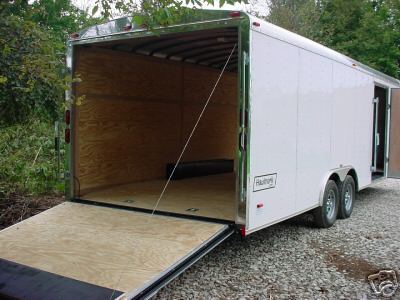

This was my 1st trailer, 16 foot, w/ steel deck, I did not like, it hardly fit in the garage, and the painted on pin stripe was very sloppy, looked like a drunken sailor painted it, so reordered another one.
2nd one was ordered with steel runners, it came with wood instead. I actually liked the wood better after I got it.
The trailer bed was 14' x 7' and has dove tail rear, over all length, hitch to tail is 17' 9". Has 15" tires. Removable driver side fender. It weighed 1400 lbs
The dove tail is a must, as it brings the ramps lower, less of an angle. The open middle has it's advantanges, it's easy to craw under the trailer to hook up the tie downs. Plus, if you ever need to work on the fuel filter or change the oil, no need to jack the car up !. You can reach those under the trailer.
The traler had brakes, and a "break away battery". (most states require them) In case of the trailer leaving the tow vehicle, it puts the on brakes so when you go back, you can hopfully find the trailer where you last saw it ! (that's how they told me)
I sold that trailer to a forum member, ordered an enclosed trailer.
Good luck with your trailer choice.
