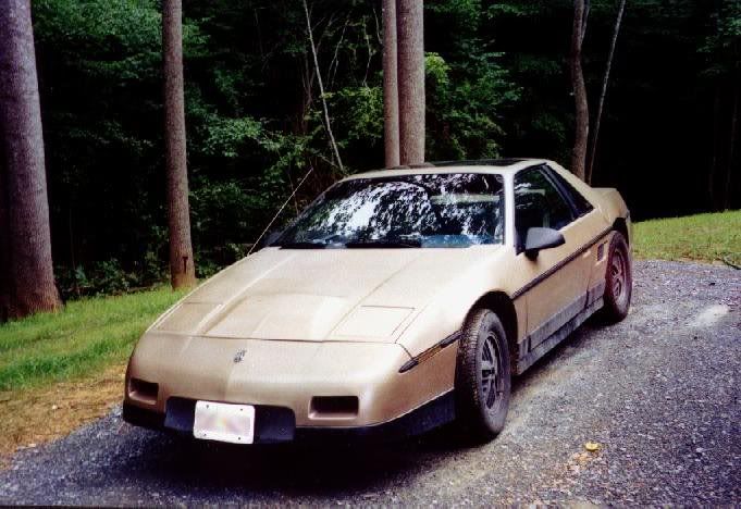

I have included a link to my car as the passenger side cover broke off.
http://www.angelfire.com/mb/HouseboatsNorthern/camera/briansCar.jpg

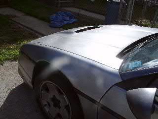

yeah somewhere either on my computer or in pics i can scan -
edit: here they are
[This message has been edited by Kohburn (edited 07-27-2004).]

Report this Post07-27-2004 08:13 PM Click Here to See the Profile for KohburnSend a Private Message to KohburnDirect Link to This Post
Kohburn
7349 posts
Member since Jul 2003
this was my second fiero when i was 18
i later swapped that hood onto my 3rd fiero

now that i look at it i think it looks like a stubby version of skitimes cowl hood scoop..

I've heard that some people put vents to the wheel wells, if you don't want to cut up the hood... Any pics of these or comments on how well they work?
I would prefer to keep my spare tire compartment watertight, so opening up area between the rad and compartment as well as cutting a hole in the well would not do it.
Kohburn
Posts: 7349
From: Oriental, NC
Total ratings: 188
Report this Post08-04-2004 12:41 PM Click Here to See the Profile for KohburnSend a Private Message to KohburnDirect Link to This Post
not sure why you think you would have to cut a hole in the front trunk tub...
installing vents in the left and right wheel well liners may help some - may even help with brake cooling
but a good hoodvent will help with front end downforce
