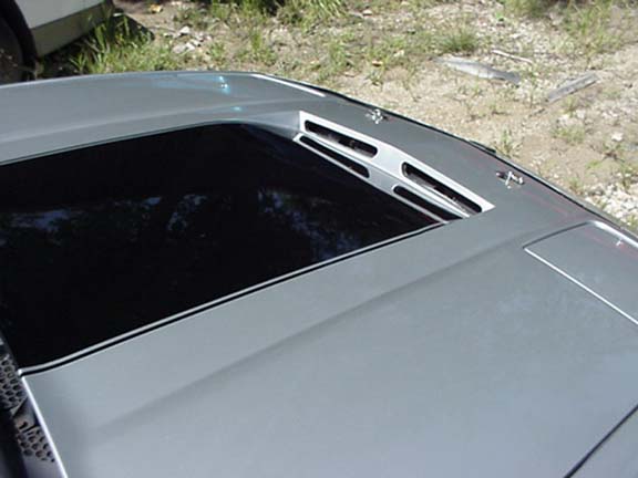

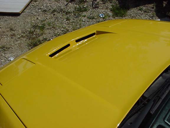

Hood vents.
Solves the headlight prob, cools better, reduces front end lift at high speeds. All that and they look cool as all hell.
Good all around.

Originally posted by Archie:
There are 2 ways to get the air out from underneath the front end, you can pull the hood release or use hood vents.
How would pulling the hood release get air out from underneath the front end? Would the hood actually open?

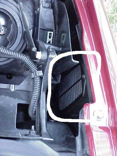

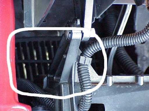

Originally posted by joeformula88:
You might be able to drill holes into the front side of the wheel wells but I don't know if that will work.
Why wouldn't this work? Has anyone tried?
It would have to be drilled behind the headlight housings or else it wouldn't do anything.
GM already vents the air from behind the radiator out through the front wheelwells, but apparantly it isn't enough.

I would cut out a 3" round hole under the hood in the headlight area, Run a clothes dryer hose from there to a hole of same opening at the back of the fender through a scoop( like skitime has on his car)routeing it will be up to you!
And the vent thing on the covers has been done by fieromomo (not sure of the name right now) only his were not funcional, they just glassed to the top of the headlight. I would say to get those and cut out the vents, then replace the light doors.
Of course the flush lites worked very well also!
Stick with Archie = smart man! AND I think he was joking about the hood latch at speeds!

Actually, I wasn't kidding. The Root cause of the headlight doors coming open is the buildup of air under the front end of the car. This also causes lift as noticed in a "Lite" feeling of the steering at 100+ speeds. The next time you're at 100mph and the steering is starting to get lite, pull the hood release and you're steering will feel like a 200 pound fat lady just sat on your hood.
You can tie your headlight doors down with some cable from Home Depot, you can tape them down or you can mount flush lights but none of those get rid of the "Lift" that caused the problem.
In the past (when I don't want to modify the hood) I've used a hole saw and put 2 3" Dia. holes up high on the front bulkhead just behind the radiator and another hole in the trailing edge of the spare tire well. That worked pretty well but I haven't done as much testing of that method as I have the hood vents.
Hope this helps
I've done this to my car. The excess air vents out into the area in between the fender/wheelwell and trunk. The air then dissipates out the bottom and can even travel as far back as the gap between the fender and front door (it's open there too). I didn't want big ugly holes, so I got these vents from the junk yard from a Camaro(?). They are about 3"x5" rectangular vents that GMs use to allow passenger cabin air to vent for that "flow through ventilation". There're all different shapes and sizes.
On the passenger side, I mounted it on the side vertically. I think this looks best. Unfortunately, you can't mount it this way on the driver's side becasue a headlamp motor relay box (?) is mounted there.
On the driver's side, I mounted it on the bottom below the headlamp to allow the air pressure to escape. There are already drain holes there to allow rain water to drain. You could mount the vents under both headlamps.
I tested these by driving about 90mph into a 50mph headwind and they DID NOT pop up.
The car also runs cooler now!! It works, and is "hidden".

Fierosound:
This is what I was looking for! Thanx a lot, this is a neat solution to the problem.
A (W)HOLE lot better than what West Coast Fieros come up with. I frankly cannot believe that a self-respecting Fiero Club comes up with an idiot solution like that.
Oh well, thanks again for all the serious input!
