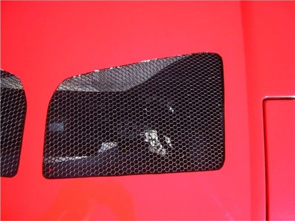

I've heard that some people put vents to the wheel wells, if you don't want to cut up the hood... Any pics of these or comments on how well they work?
Been there, done that. Look here
Originally posted by CC Rider:
https://www.fiero.nl/forum/Archives/Archive-000001/HTML/20030204-2-026101.html
Mid way in this post is a great fix for this that you can do with minimal effort.

Originally posted by GoFast85:
Kohburn-- do you have a pic of the vent?
Fierophrek-- my vents are smaller size mine are off of a ?Sunbird? Yours are from a what?
I have included a link to my car as the passenger side cover broke off.
http://www.angelfire.com/mb/HouseboatsNorthern/camera/briansCar.jpg
OOOPs sorry for snoozing. My vent are the honeycomb mesh thats under the rear deck vents. I removed them from the vents,cut them to shape and glued them in using a two part metalset epoxy.
i glued them in on the inside of the hood its not the prettiest install but they work.
YOu got any pics with more of your fiero showing? I could do that... would be cool with painted mesh
