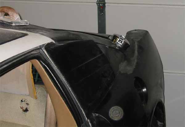

here some of the panels sitting on the car. I'm waiting for mounting hardware so this weekend I'll be doing some sanding and finishing work on a few panels.
The body is in really good shape and trimmed really well. There aren't any bubbles in the glass so my finishing time is less.
I wanted to get the panels on to see how far I need to bring the wheels out. Looks like 1.5 inches up front and 2 inches in the rear.

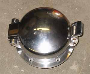

What did you use to cut the gas filler neck? My tank is about 1/4 ful and I don't want anything dropping in it - or exploding!
YellowArtero
Posts: 256
From: Belle River, Ontario Canada
Registered: Mar 2004
Report this Post03-07-2004 03:08 PM Click Here to See the Profile for YellowArteroSend a Private Message to YellowArteroDirect Link to This Post
When I did mine, I used a large pipe cutter that is used for copper pipe. It doesn't leave any filings. I believe I used a 1st generation Dodge minvan rubber extension to lengthen the filler tube. Trying to get gasoline grade hose is very difficult and very expensive. Mine cost me $2.

An oxy-acetylene torch, but I like to live life on the wild side.
Actually, I also used a large pipe cutter to cut the neck and a regular tubing cutter for the overflow pipe.

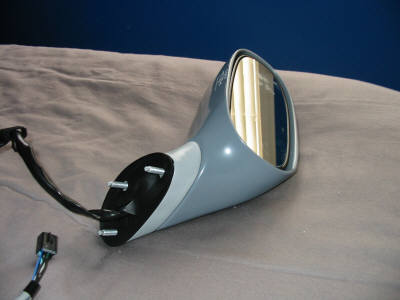

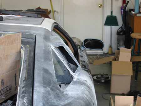

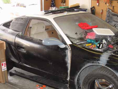

My mounting hardware showed up last week so I was able to mount 1 door. I did a little cutting of holes (license plate, vents). But I don't have any pictures - will try to get them up this week. Next weekend I'm devoting to a friend's wedding and family stuff so there won't be much work done on it. I should have some more parts in this week (hint, hint, nudge, nudge Archie).
So what's the big update?
And a picture of some toys I've collected in the last couple months to put on. 11.25 brakes and 2" drop spindles.

What do you guys think of this?
Close up:
I don't like what it looks like on the side where the original gas door is, but I like the placement on the back. It will be in front of the wing - I'm sure the wing isn't really functional so it won't hurt the aerodynamics
Stinkin_V8
Posts: 821
From: SK, Canada
Report this Post04-15-2004 12:00 PM Click Here to See the Profile for Stinkin_V8Send a Private Message to Stinkin_V8Direct Link to This Post
That looks great! Perfect addition.
Edit: On second thought, are you going to have enough room in there to run the pipes down to the fuel tank? You need room to stick the nozzle in, too.
If this helps any, the last time I needed to build a custom filler neck I bent up a coat hanger to the right shape and took it to the muffler shop.

Update time. My wife and I just got a new boxer puppy so the finale has been on hold a bit.
Today I mounted the side mirrors. They are power/defrost type from a 2004 corvette.

I've had numerous requests about the mirror mounting. I'm not sure how it will mount on a stock fiero - I'm not sure if the angles will work to keep the mirror flush and horizontal at the same time. I will need to build up the bottom edge on the finale about 1/8" to make it work...
Here is the back of the mirror to show the mounting style:
