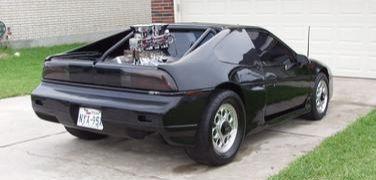

You must be congratuated on a nice and ultraneat ( and ultrafast) V8 swap. By matching a powerful V8 to a high strength transmission, the combimation is also bound to be reliable.
I have two questions and please do not get the idea that they are intended to flame. I really like your Fiero but I am just curious.
1. What is the new weight of the Fiero?
2. If you take your Fiero to a show out of state with your girlfriend or wife, and do an "overnighter" where do you keep your spare and luggage?
1. i havnt had it weighed yet, but i figure about 175 lbs more than it was.
2. its a trailer queen!!!!!!

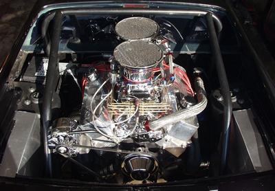

wow what a sweet rollbar!! tell us about it!

its black........

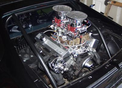

Originally posted by cardealer:
heres a pic as of today......
should be finished in about 2 more weeks.
Thats SWEET! Holy cow, I can imagine the things you are gonna hear from people once you start driving it! You Da MAN!

I guess I don't follow you there. All that is required is a simple elongation of the rear cross member location. The new extension & cross member are welded in, and then the old cross member is cut out and patched over. Very simple & cradle never distorts.
This shows the 1/4" x 2" steel angle iron extension and the 1/4" x 2" tubular steel cross member.
This shows the motor mount. While this is a solid mount, it is easily adapted to a bushed mount.

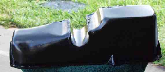

Even with a dry sump, you still need an oil pan and would still have to notch it out to clear the axle. Also, then you have to deal with more hoses and an oil reservoir and a crankshaft driven pump connected by a cog belt. Not to mention the $$$ involved over using just a good internal oil pump and a notched pan.

This shows one way to relocate the tie-rods. All parts are from Speedway or Jegs. Here I've "reversed" the knuckles, searching for a combination of the easiest place to locate the cradle-end of the tie-rod, and the "sweetest" 0-bupmsteer position. With "un-reversed" knuckles the tie-rod mounting plate is welded onto the flat face of the rear cradle bushing tower. I got a very suitable location there, and am just seeing if it is better if "reversed".
Here is the right side stock manifold of a Camaro LT1. Using two of these when installing an LT1 (what I'm doing) solves all exhaust routing problems concerning transmission & accessories such as ac, starter, etc. One side has exhaust routed forewards & one side routes exhaust aft, which works well with the stock Fiero cradle & chassis setup.
The shifter requires a small lever fabricated from flat steel which is Mig'd onto the trans shift lever rod end. A bracket is easily attached to mount the aft end of the shifter cable.
All of these details fit nicely into a stock Fiero.
