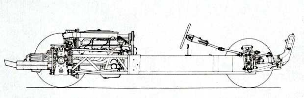

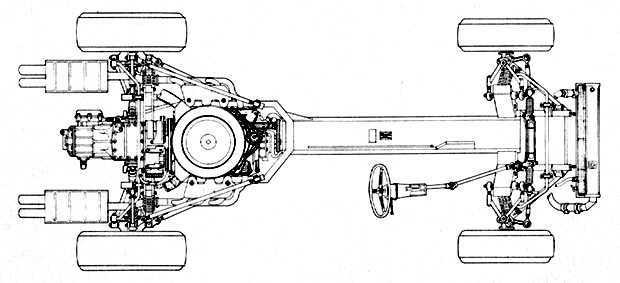

Originally posted by 80's BOY:
...I was disappointed in the structural integrety of the factory components. But then again they didn't have THAT much torque to worry about...
I don't care much for the factory design either. It seems that the trunk, with the crossmember, was a big part of structural integrity - I would recommend doing some reinforcing to compensate for removing them. I noticed that the upper frame rails don't really tie rigidly into the lower main frame rails. In front of the strut towers they tie into the cabin and behind it they are tied into the trunk.
Maybe you guys can use parts of my design to reinforce your car. I think cardealer is already going that direction. I am using a full race cage and the rear down strut bars - the ones that come down from the main hoop to the back - will be welded directly to the lower main frame rails, right over the rear cradle mounts. That way stress and pressure introduced into the chassis through the cradle, from the drivetrain and suspension, will be directed into the cage and forward into the main structure of the car.
Even if you are not planning on a full race cage you can still have new tubular upper frame rails bent that tie into the main frame rails, strut towers, and rear firewall - replacing the weak (often rust-eaten) factory upper rails. If done right it'll be much stronger and look great too.
perk
