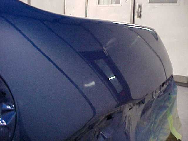

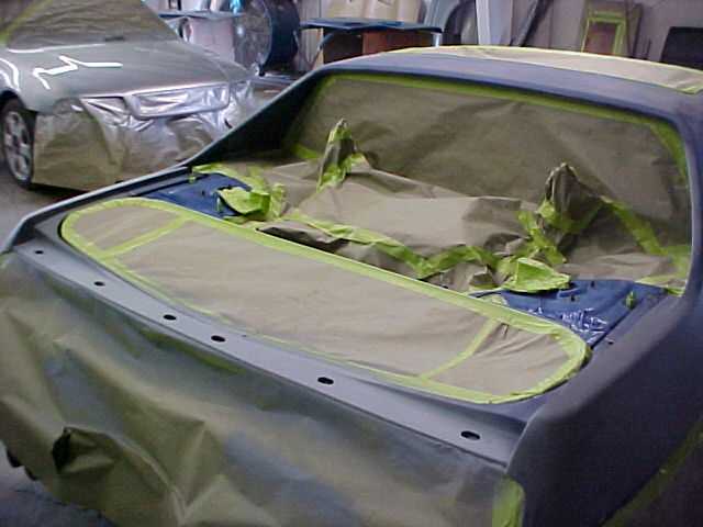

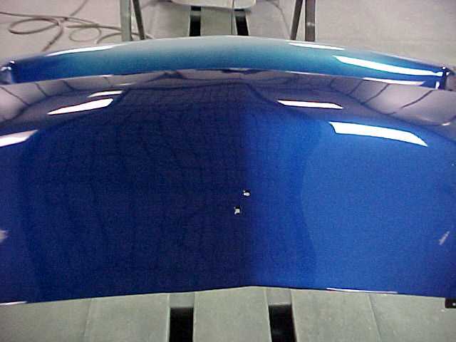

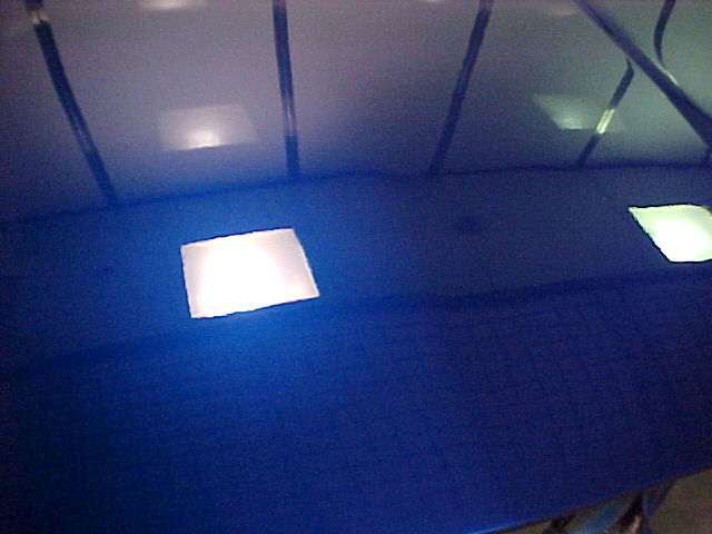

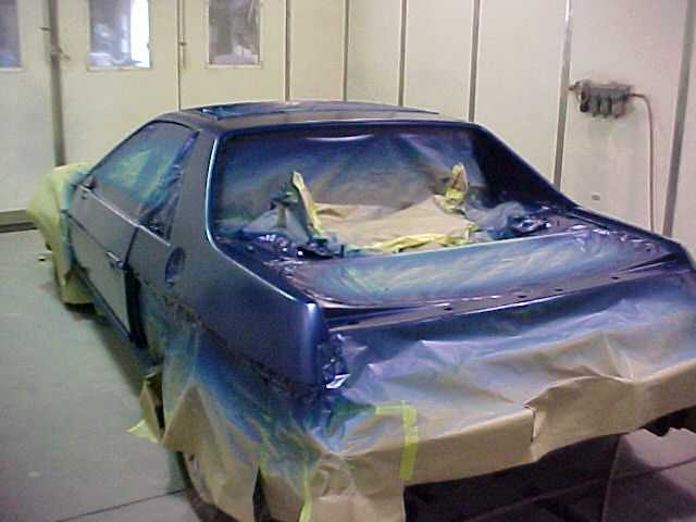

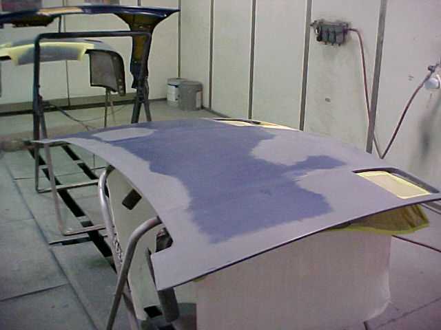

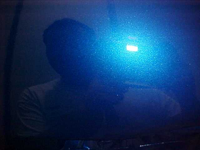

Wrapped and wet sanded with 400 grit, my hands look and feel like prunes.
Color sprayed on after the grey sealer was laid.
Quarter panel after clearcoat was applied.

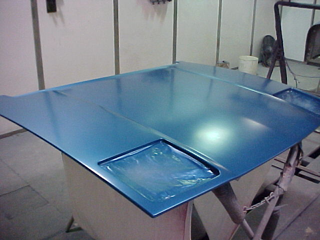

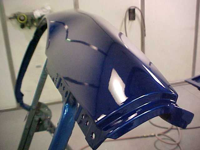

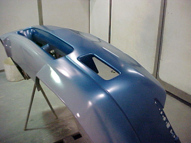

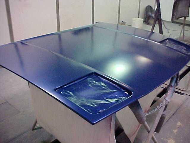

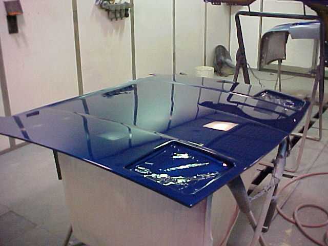

Here's the hood and other pieces. Same story, wet sanded with 400 grit. The hood was a Pain in the Arse. The old bodywork kept bubbling under our primer. We hope we got it after 3 tries. We had to keep going deeper and deeper till we got to the fiberglass. Time will tell.

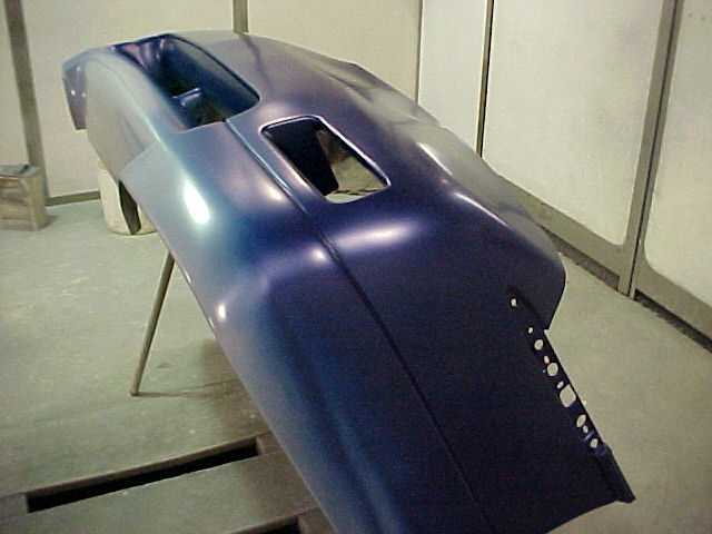

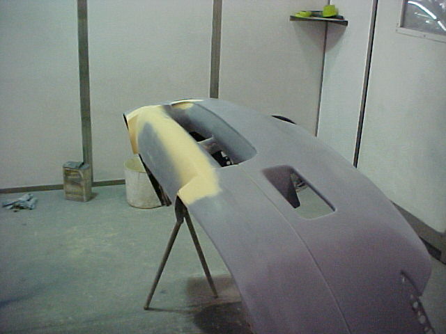

Heres the front cover. Notice the yellow primer. The body filler the gilbert clan used didnot harden. I had to dig out the filler and redo the nose.

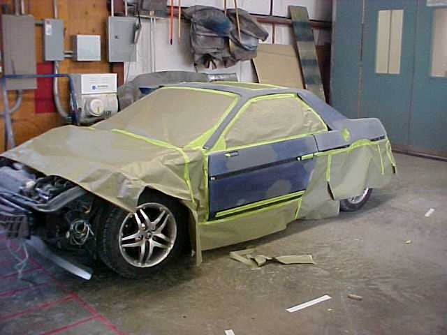

All these photos are from Saturday. Me and LilDv1L started at 830 and I finished at 730pm. He finished at 900pm. I don't do any spraying except primer, so I was no longer needed, and I was glad to be out of there. There is only so much "Fiero" I can take in one day! Anyway, all the "blue" is done except two pieces we haven't gotten yet. Next will be the silver.
