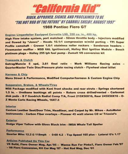

Mine has turned a 12.2 1/4 mile @ 118 mph and the top end mph of the car is approx. 179 mph. That's with a 3.61 final drive ration, which clearly tells you that it's screaming for a higher numerical final drive ration to turn faster 1/4's.
Bottom line is that 1/4 mile isn't everything. If all you care about is 1/4 mile performance, want to go below 11's, a car similar to the Mustang, is a better choice due to high performance part availability.

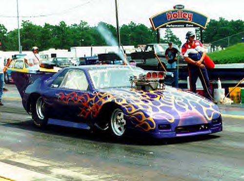

Here is a mid engine drag car.

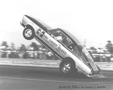

That had to hurt coming down.
California Kid
Posts: 9541
Total ratings: 274
Report this Post09-21-2002 12:51 AM Click Here to See the Profile for California KidSend a Private Message to California KidDirect Link to This Post
That car would carry the front tires like that or a little lower for the entire quarter mile. They even had a window in the floor so he could see where he was going, after finish line he would slowly back off the gas and ease it down.

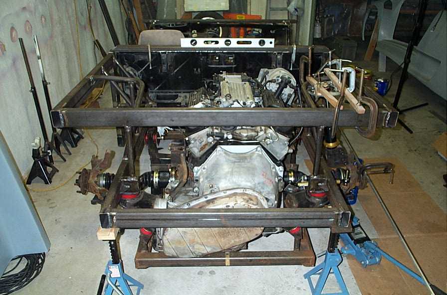

perkidelic
Posts: 772
From: Masury Ohio USA
Report this Post09-21-2002 11:15 AM Click Here to See the Profile for perkidelicClick Here to visit perkidelic's HomePageSend a Private Message to perkidelicDirect Link to This Post
perkidelic
772 posts
Member since Aug 2002

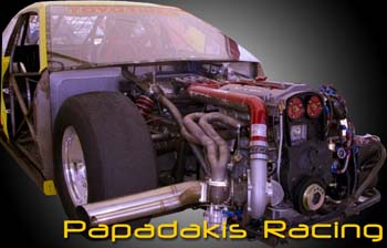

can't see the tranny real good but you get the idea - right?
http://www.stephanpapadakis.com/

The Hemi-Under Glass was NOT a Drag car it was an Exhibition Car and I have seen it at drag strips and it never had another car race it when I seen it. As far as cars with engines in rear being slow I belive most TOP FUEL Drivers would dissagree (300+ mph runs in less than 5 sec.) -- alf

Perkidelic wrote:
>>opm2000 - what the heck are you building?!?!?<<
That's the rearend view of an LT1 mated to a THM325 trans, with the bigger axles & bearings. The tubular steel replaces everything aft of the firewall. This is in the down & dirty fabrication phase, but everything fits, so far.
This goes into a Diablo body, but the same assembly will fit nicely into a stock Fiero if you are willing to loose most of the trunk.
