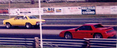

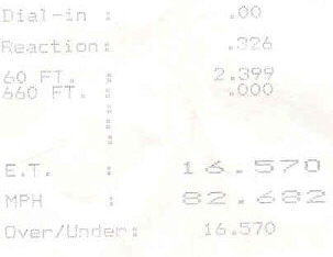

Ok here are my slips what do you think of my times?
My first round race was against the black firebird in my pics and the
2nd round was against the yellow olds in the second pic.
Ok soory i dident know they would be that big.oops to small hang in there. Ok finally sorry but I'm new at this posting pictures I finally got it right. So are these good times for a stock motor?
Stock 85 GT Bracket Racer
My record so far is 1W 1L
Fastest time 16.54

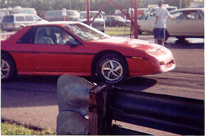

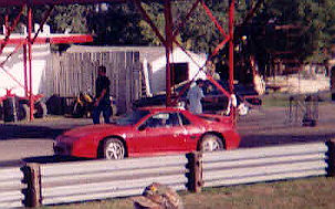

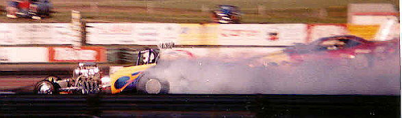

Ok here are the resized and zoomed pics of my first race experience
And here is some thing really cool Alcohol funny cars!!
Ok thats enough pics I had lots of fun and I look forward to next year!

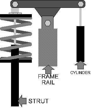

Ok, for my high-tech, active, training wheel system. I was not talking about modifying the suspension characteristics, but counteracting the rearward rotation of the vehicle upon launching. My proposed method of accomplishing this is to have a hydraulic cylinder force the rear of the chassis upward by pushing on a rocker arm. The idea is that it would interrupt the inertial forces at work and cause the front end to fall, or at least not rise anymore.
My first course of action will be to use fully tunable suspension components at each corner and run full stiff in the rear compression damping, to make the car resist the natural rotation. The active system is actually my vision of the ultimate extension of this philosophy. Instead of passive resistance, active force would be exerted in essence shoving the rear wheels into the ground, and simultaneously counteracting the rearward rotation of the body. I guess you could call it an active traction assist/anti-wheelstand system!
Here is a rough two dimensional illustration of the system:

Interesting concept...seems like it would be very difficult to control. In order to counteract the inertia of the car it would have to act fast, but if it acts too fast it would be really harsh and possibly add a torque steer with the greater momentary traction. I got to thinking last night, the setup I explained could also use a wheel speed sensor on each wheel instead of one from the tranny and used to create a limited slip type effect like traction control systems do. This isn't a big deal for normal launching on the Fiero, BUT when your front two wheels are in the air it could be used to keep the car going straight. Hell, if you wanted you could even add a couple of sensors/switches to steer the car with the rear brakes when the front wheels are up!
Your idea wouldn't weigh as much as I had originally thought. I wonder if it would be better to use compressed gas instead of hydraulics simply to save the weight of a hydraulic pump. Have you considered what you would use to keep the strut located in the frame (maintain proper alignment) through the ram travel? It seems like that would take a beefy design to withstand those kinds of forces and hold the strut rigidly. Also, what happens when you run out of ram travel...better let up in a hurry!

Before you get enamored of hydraulic suspension tweaking like the BMW 745i and Merc SL500 have, remember that both of those cars weigh well over 4000 lbs. What you're talking about is not compatible with the idea of having a reasonably light car.
I think you need to do more research into building an effective suspension geometry before you go tech crazy with active components. It's quite possible to build a rear suspension design with >100% anti-squat, and if what I just wrote is even in the slightest bit hard to grasp, you have a lot more research to do.
Consider the possibilities of using a 5 link formula style suspension...

I did consider using air or gas to control the cylinders, but it seems that they would become a suspension component and alter the spring and damping rates. Hydraulic cylinders would be seem to be the closest thing to a solid upper mount. I also considered designing a way to lock the whole deal when not at the track. The rocker arm/upper strut mount would indeed have to be very stout to handle the normal and additional forces. I figure a large, but well designed, 6061 alloy piece would do the trick (light and strong). In all, I am guessing that the entire system with specifically designed cradle would weigh less than the factory set up. The factory has upper frame rails, plus massive strut towers/inner fenders. I know from experience (cutting up my other project car) that Fieros have a LOT of metal in that space frame! My trunk is history too.
I was also thinking that, on my car with the full 12pt cage, I may even be able to eliminate the lower frame rails. I know they are probably pretty heavy. If I make the rear of the cradle bolt to the back of the cage, and then bring a strut bar down off the main hoops inside to each front cradle mounting point, it seems it would be as rigid as the factory set up. We're talking major weight reduction there! Not planning on doing this right now, just looking at all the possibilities.
You're right about running out of ram travel - you'd better start thinking about running out of gas pedal too!!!
I do recognize the benefits of your ABS-based system. It would probably be much lighter, and work as just well, if not better. Mine came from a hard-core drag racers' mentality though - something that keeps me moving forward as fast as possible! Back when I first started racing street bikes the fast guys used to use the rear brakes to keep the front wheel down. When the new generation of "all-or-nothing" minded racers (which I was a part of) came along, they came to the conclusion that too much time was lost when the brakes were applied, and started sliding the clutch. A bike is really lightweight so we can get away with this for a long time on a single clutch pack. In addition to this the clutch is a snap to change. I think I mentioned this before, but one friend who is still at it has run 1.6 (maybe high 1.5) sixty foot times with no bar and a short wheelbase sport bike!
The ultimate system to me would seem to be yours. If you can get that thing to the point where it can actively control the clutch upon launch the problem would be solved. If it worked I wouldn't mind replacing clutches all season long for the best numbers possible without those nasty training wheels Using the gyro it could put more "slide" in the clutch and keep the front end close to the ground. Normally after about thirty to sixty feet, inertia begins to subside and gravity takes over, so you just have to keep the front from reaching a critical point.
