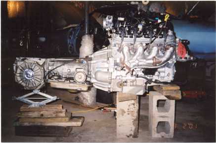

like this? http://home.earthlink.net/~westphillip/

I think the C5's tranny is way too long between diff axel take-off and input shaft...
It's going down the right road though. The various Porsche and ZF transaxles designed for mid-engine have the diff very near the input, and the gears hanging out the butt...
know what I mean?

Yup, that would make for a pretty long Fiero huh?!?. Looks like the Porsche is absolutely the way to go for longitudinal mounting. Now, to pick the absolute best in a tranverse tranny and compare to figure out which is the best for the plan.
For your project - I was checking out Held's products and they said you need at least seven inches to run the Porsche transaxle; and at seven you have to do some work on the firewall. With eight or longer it fits without messing with the firewall. Thought about you because you mentioned using the Porsche tranny with a six-inch stretch.
Thanks for the pic & link Leper - Checked out the Corv8 - water pump snout is in their armpits!!!
