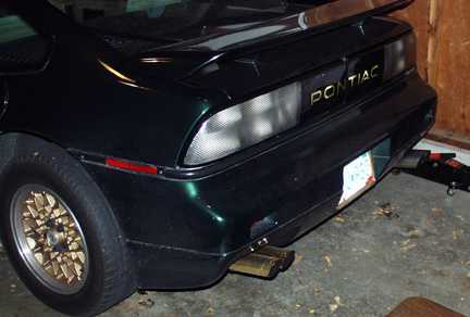

Well, I know many of you have been waiting for this (as have I). And after last week's problem with the gauges, I was a little worried about taking apart my good GT taillights. But I dove in Friday night full-speed ahead, I photographed nearly everything I did- and I will post those pics once I get around to scanning them... the following are all finished photos.
Here's the process: I first removed the taillight assemblies (15 years of dirt, grime, and gunk- yuck). I then separated each assembly, removing the inserts and cleaning the lens and reflectors carefully. I cut about 1" off the red insert and painted it black (It is stuck back in the final assembly to block light from the "Pontiac" from going into the signal area). I also bought a can of Chrome paint and repainted the reflectors- they were in rather poor shape themselves. I then used a clear bathroom silicone to "glue" in the pre-shaped lenses (these cured overnight). I cleaned all the sockets, and replaced bulbs. Turn Signals are APC amber 1156 LEDs, Stop/Brake lights are APC red 1157 LEDs, Backup Lights are PIAA Hyperwhite 1156 bulbs, and the PONTIAC uses Raybring green 194 bulbs. All the bulbs went in fine except the amber LEDs. They have a slightly different profile shape which required me to cut down the top edge of the socket just enough to get the bulb to seat properly (that was annoying).
Saturday morning I resealed both assemblies (small spots of silicone around the edges) and re-installed them in the car! As previously known, I had to remove/unplug the third brakelight below the roofline- the quartz bulb causes a bad ground when using LEDs. I'm going to eventually rewire it for another 1157 LED and put a white lens in it as well.
My final issue [EDIT]which has been solved in the Technical Discussion section[/EDIT] is that my Turn signal relay appears to no longer work. Not sure if this is a bad relay or an issue with the LEDs... any suggestions there would be helpful. https://www.fiero.nl/forum/Forum2/HTML/014659.html
[EDIT]It was the relay... the LEDs don't create the load that the original bulbs did, so I needed an "electronic variable-load" flasher unit ($12)[/EDIT]

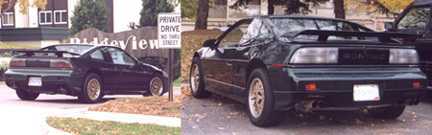

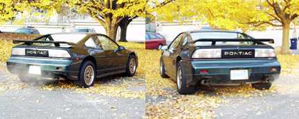

The basic "Before and After" pics

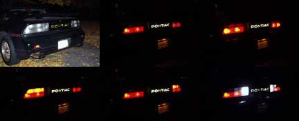

The night-series of the lights... The brake lights really just glow brighter red- the camera saw it as being more of a orange. And the Backup lights are WAY bright- almost like having another set of headlights in the back.

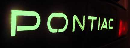

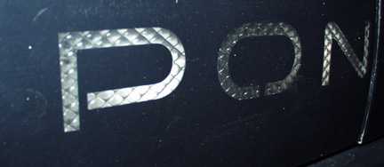

The "Pontiac" showing the Texture, then Illuminated (Green bulbs)
A closer shot of the red taillight and turn signal.
Another finished pic in the garage
Couple of shots this morning (a little chilly)
For anyone who may have missed the original thread about making the clear insert lens, check it out here: https://www.fiero.nl/forum/Forum1/HTML/010073.html
As for those interested in buying these lenses- preshaped for the GT lights... I'm not quite that far yet. I'm going to start working on a wood/Bondo form so they have a better, cleaner, and more precise fit (mine are only about 95% fit quality of what I want).
So, what do you think...?

    my cars getting jealous because everyone is showing off there clear tailights, so I told it I would post a pic. I did these about a year and a hlaf ago. (btw, would red neon light tubes hold up to being used as brake lights if I put them in the bucket and put red strobes in for the turn signals?)
    here it is!
    I thought I would dig up my how to thread on it too.
    https://www.fiero.nl/forum/Archives/Archive-000002/HTML/20010924-1-006083.html

    I finally got my amber LEDs from jcwhitney today and did the clear tails. It's really not as drastic of a change as I was expecting, very subtle. I'm pleased I'm most pleased with the quality of the lighting from the LEDs. From an angle they look just like regular lights, but from straight behind (for the bumper chasers ) they are VERY bright, definitely can't be missed.
    I ran into the same problem with the flasher unit that MinnGreen did, LEDs won't flash with the stock flasher unit. I totally forgot about that, and I'll be picking up a different flasher relay tomorrow.
    Here are some pics if anybody's interested. They're not much different from the ones already posted.
    http://home1.gte.net/jbnash/fiero/clearlights/clearsalllitup.jpg
    This pic was taken at 9pm! I love my new camera http://home1.gte.net/jbnash/fiero/clearlights/clearsfakeday.jpg
    Comparison stuff: http://home1.gte.net/jbnash/fiero/clearlights/stocktails.jpg http://home1.gte.net/jbnash/fiero/clearlights/stocktailsfakeday.jpg
    Thanks for the helpful info and the creative idea MinnGreen!
