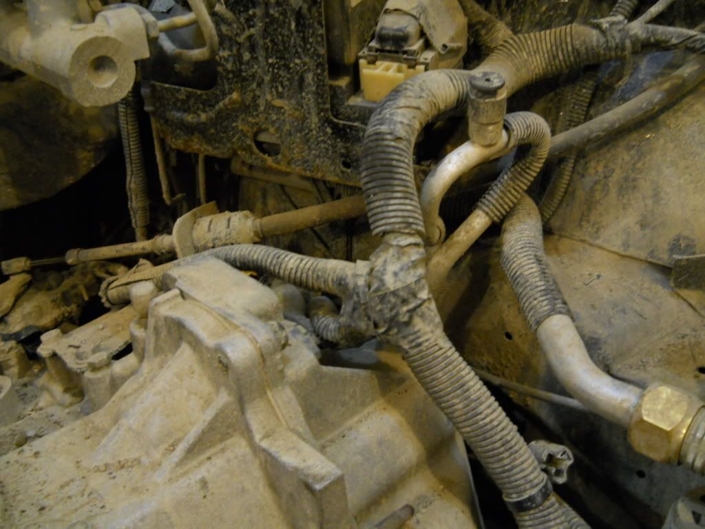

So ive hit a brick wall, im just wondering do i need any of this wiring to the transmission? im sticking with the fiero 5 speed so none of that will be used, can i just cut it off there and program that out? the harness goes up to what looks like the cruise control, what is my best bet to do?

No you can't just take a stock harness and hack off legs and then expect it to work. What you need to do is take the harness apart and then reassemble it configured for a Fiero. At that time you can leave out the unused parts that run to the transmission.
I would suggest having someone do the work if you are unable or unwilling to do it yourself.
If you are willing to do the work yourself you can get assistance on how to do it properly on this forum. It will take some time and patience. You do need to solder some connections.

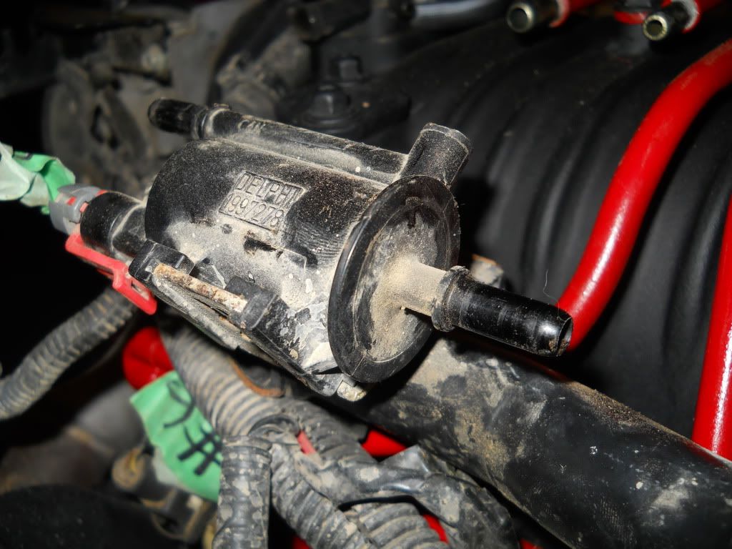

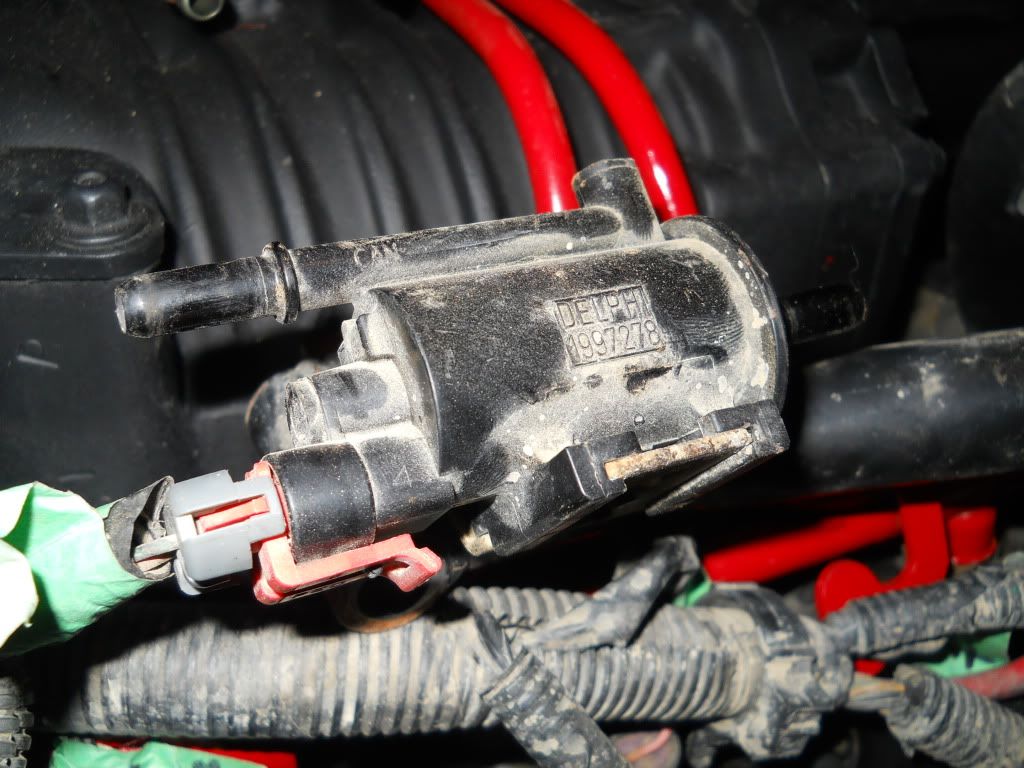

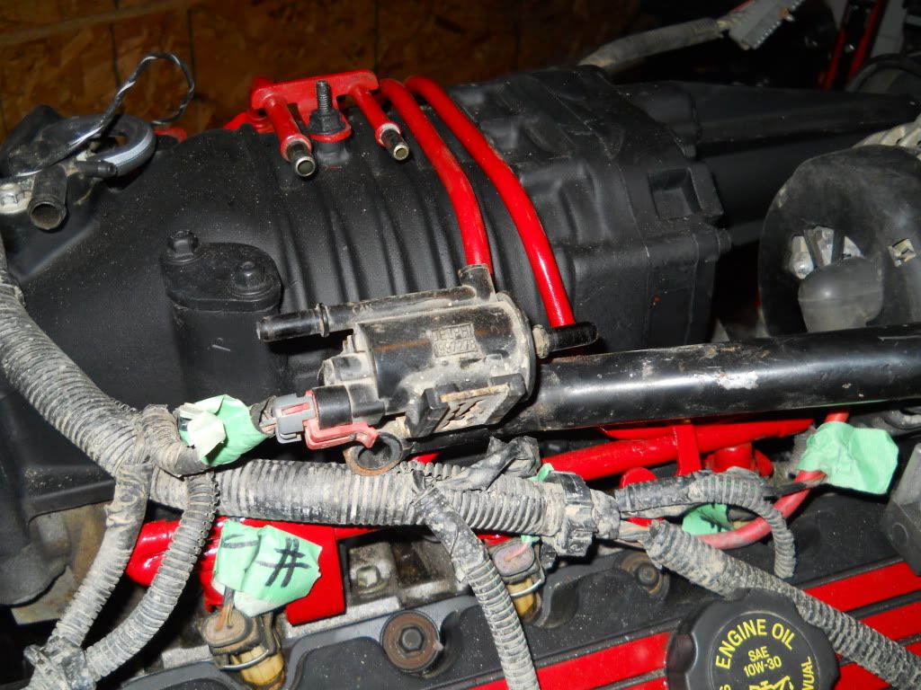

Can anyone tell me what sensor this is and what it connects to?
That would be the EVAP purge solenoid. It is connected to the vac lines that run underneath the snout of the SC and around it. Unsure if you can delete it im in the process of researching and getting the money for a 3800 in my fiero. But i had a 98 GTP and know alot about those engines.

Report this Post02-27-2012 07:01 AM Click Here to See the Profile for phonedawgzClick Here to visit phonedawgz's HomePageSend a Private Message to phonedawgzDirect Link to This Post
Keep the EVAP Purge Solenoid. Locate it on the transmission. The Green/White wire goes to the stock location of the Evap Purge Solenoid pin on the PCM connector. The other wire (Pink) goes to switched power (C203 pin K). Connect one end of it's vacuum connection to a vacuum source between the SC and the throttle body. The other vacuum connection runs to the purge connector on the evaporative canister., The PCM will then control the Evap Purge Solenoid to purge the canister during proper engine running times.

Report this Post02-27-2012 08:47 AM Click Here to See the Profile for FIEROFLYERSend a Private Message to FIEROFLYERDirect Link to This Post
Get rid of the 3800 EVAP system and just feed a vacuum line from the engine to the Fiero factory charcoal canister and be done with it.
The EVAP system is more vehicle specific then car and to fully function you would need to add in the fuel tank pressure sensor which requires drilling a hole in your furl tank or filler tube.
Have the PCM programmed to remove all VATS, the EVAP, second O2 and the EGR if you plan to remove it and tweaked to match any mods your car has and if wanted to match your tire size so the speedo is more accurate. Dan
