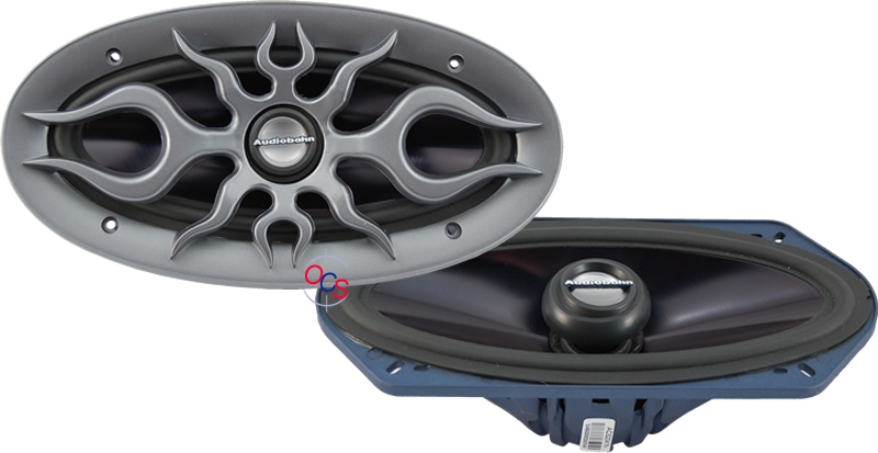

-The dash speakers (4"x10"): Those dimensions are very hard to find. The one that I know of, and that I've tried are the Pioneer TS-A4103, the Kenwood KFC-415C and the Audiobahn ACS2041N. (Click on them to see a picture) I've concluded by testing them that the pioneer focused more on the high notes, the Kenwood was more on the "bass" side and finally the Audiobahn was in between. I chose the Kenwood since the Fiero needed more low frequencies than highs.
