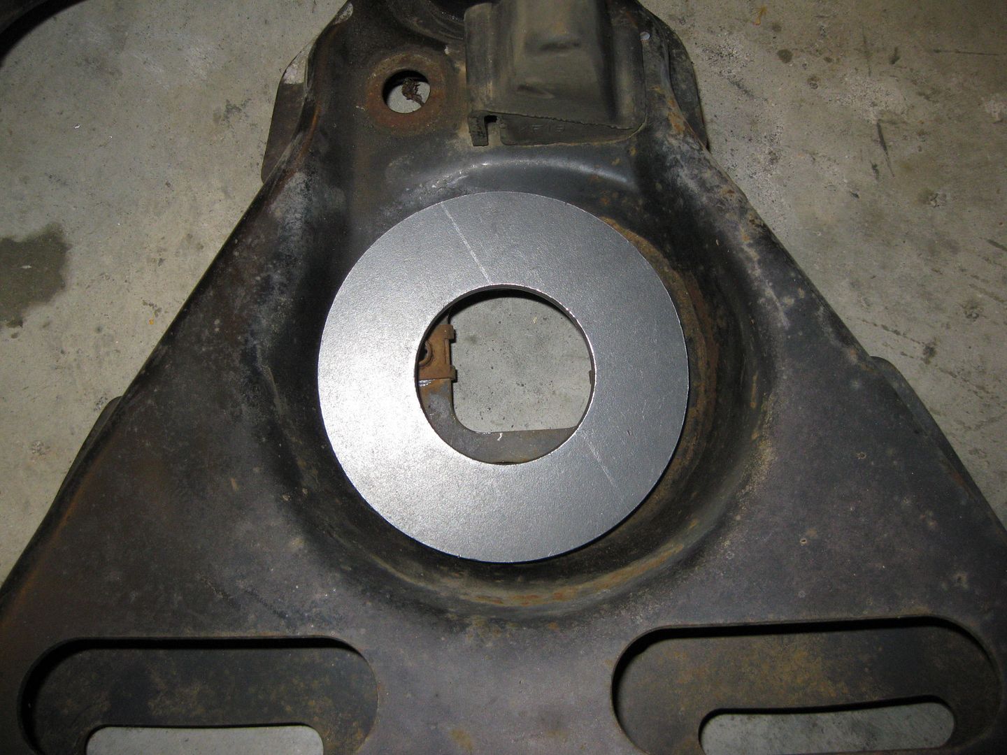

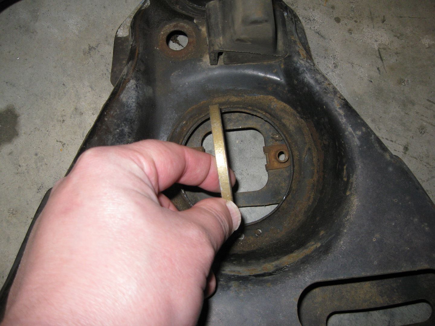

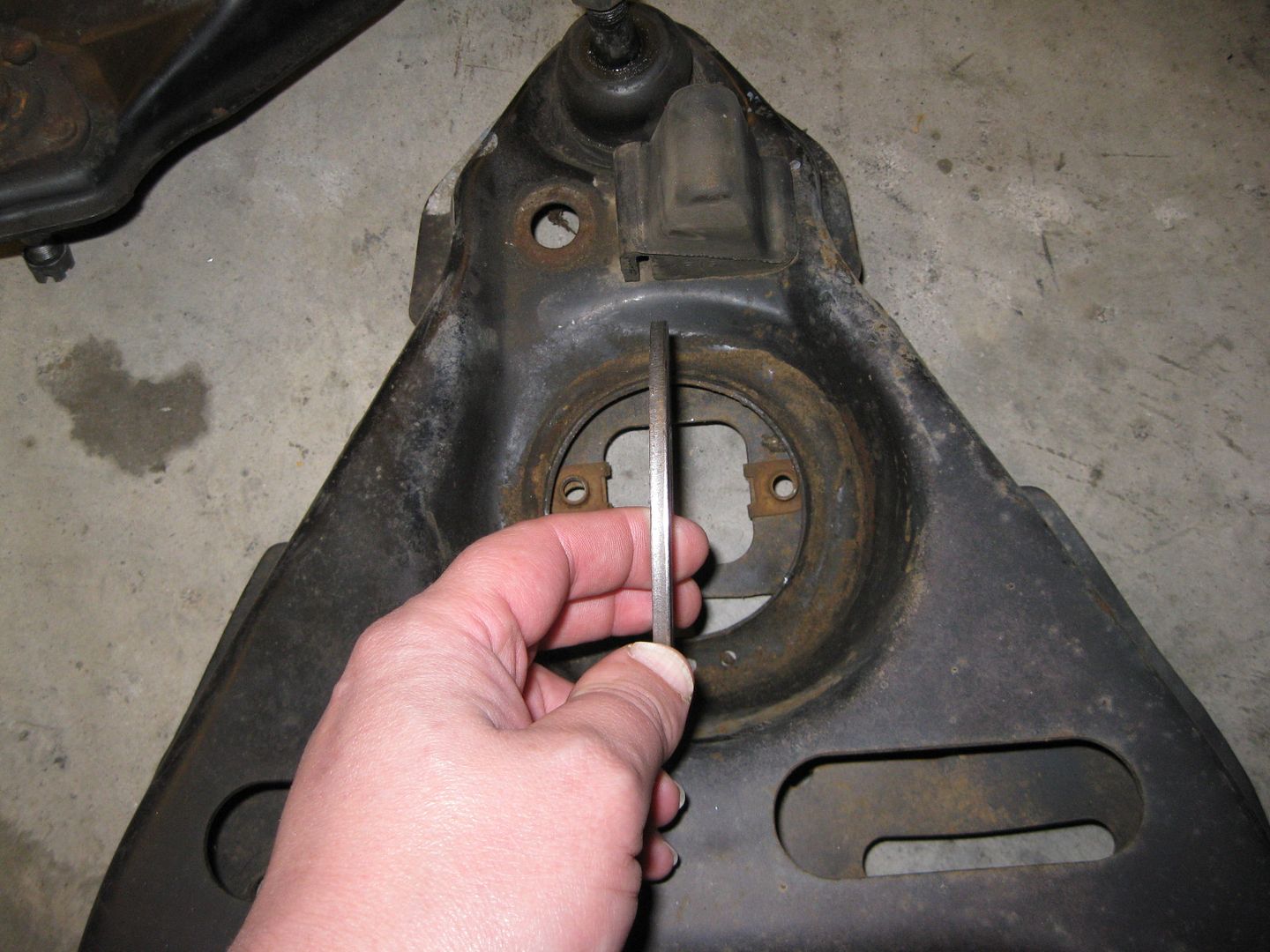

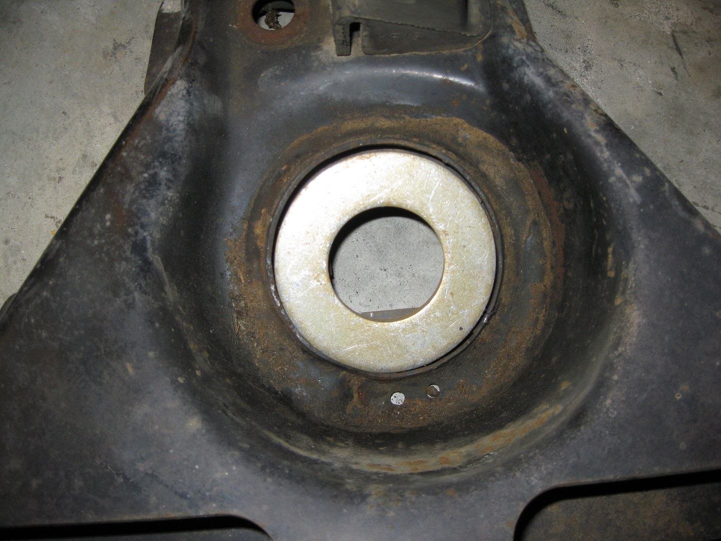

Report this Post03-03-2012 08:36 PM Click Here to See the Profile for qwikgtaSend a Private Message to qwikgtaDirect Link to This Post
Since your car is lowered, you probably want to target a shock with a compressed height 1" less than stock. I have bottomed out the front shocks before and bent the T-bars, so I run 1/2" spacers (move the t-bar 1/2" below the lower a-arm) to gain a little more travel.
I noticed that on my KYB's with less than 2K on them both had slightly bent "T" bars. When looking at my extra 88 LCA I have in the garage I couldn't help but think that the design is just poor. The thin metal that makes up the mounting position for the shock is just thin in my opinion. Not that i'm a metal's expert. Plus the shock is held on the LCA with two screws and a sheet metal nut. I am going to drill out the holes and use some grade-8 nuts/bolts when I do change this all out.
If I had welding skills, i'd design a new mount for the shocks, I'd cut some 1/4 steel the size of the "ring" the spring mounts into on the LCA. I'd remove the lip on the LCA that holds in the spring, and I'd weld a new ring onto the 1/4 plate so the spring had a place to rest. Then i'd cut a hole in the middle of the 1/4 plate to allow the shock to travel through. Finally i'd weld some tabs, with holes, to the bottom of the 1/4 plate approx an inch or so down and allow for the shock to use a "shock bolt kit" and "bushing kit" like on the QA1 site. http://www.qa1.net/qa1_moto...-shock-bolt-kit.html
One other possibility is to do the same thing, except forget the ring for the stock shock, and run some coil overs. Using the thick area of the LCA where the spring used to sit would be strong enough for the coil over to work. Since this would be mounted to the LCA from the inside, it would also be using the weight of the spring against the LCA to its advantage. The WCF Koni bracket is a bolt on from the bottom, its almost the same thing, except that the bracket is being held on by three bolts.
Someday i'm going to buy a welder and try to make all the things I have in my head.
Rob

Report this Post03-03-2012 09:17 PM Click Here to See the Profile for fieroguruSend a Private Message to fieroguruDirect Link to This Post
When you get around to it, there are off the shelf washers that will accomplish most of what you are looking for:
