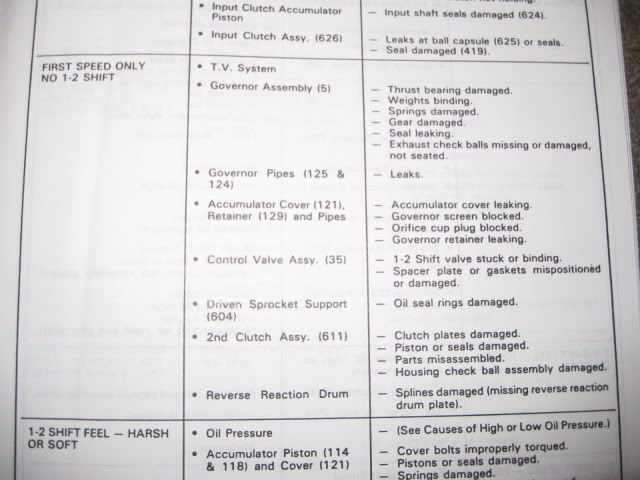

A slack or broken TV cable does not cause late/no upshifts on a 4T60 like it would on a 125-200-700. The fact that it went 4-3-4-3 first tells me that your governer gear has stripped. I'd check that first. Only two bolts to get the cover off then you can pull the gov out. If the driven gear looks like an apple core,get another matching gov(the gear is not replacable). By all means,get the TV stroke right and then adjust the cable so the shift timing is right. Adjusting the modulator wont help this complaint-it has next to nothing to do with a 4T60's shift timing-it does have everything to with having enough pressure when the trans needs it under load though.

Thanks for the info Marc! Jester (the last owner) told me it might be the governor as well. I had off work today but didn't work on it because of the 3 foot of snow. I wouldn't have anyway of testing it.
So Marc you say two bolts that's all to get it out? That sounds easy enough. Does anyone have a diagram of that the 4t60 looks like?

Anyone have a factory service manual for a car with this transmission? What does it say would cause a loss of everything but first and reverse?
fieroguru
Posts: 12579
From: Champaign, IL
Feedback score:    (45)
Total ratings: 258
Report this Post03-12-2011 06:38 PM Click Here to See the Profile for fieroguruSend a Private Message to fieroguruDirect Link to This Post
I have the ATSG service manual for the 440-T4/4T60 (2002 update).
I suspect the issue is the geometry of the TV cable bracket (this happened all the time when guys were converting their TPI camaros to carbs). If it has too much cable movement, then when you set it to be fully extended at WOT, then it will have too much slack. You can take the slack out and it would work again until you wnet WOT (which would pull the cable back to where it needs to be for WOT.
I ran a 4T60 with the 4.3 CPI (factory GM TV cable setup) and still have a couple of the intakes in the basement. The distance between the centerline of the throttle shaft and the center of the TV cable attachment should be about 1.17". If it isn't very close to this, then the geometry will be off. II suspect yours is too long... Readjusting it to set the cable at 3/4 WOT might make it work again until the next time you go WOT (which will readjust the cable and make it too loose at idle).
If it broke while passing, my guess still is he did a WOT run and the welded up attachment for the TV cable was too long, when he went WOT it either pulled the cable forward in its slotted adjustment or bent the bracket causeing the slack that is obvious in the picture below. All he needs to do is measure the distance between the throttle shaft and the TV attachment and see if it is about 1 1/8 to 1 3/16.... if it is then pull the govenor cap and see what is up with it. Once these two items are ruled out, it is an internal issue. But if he just swaps a new transmission in with screwed up TV cable geometry or swaps over a faultly govenor assy the next transmission will have the same issue.
