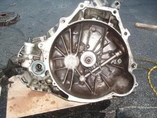

The factory manual indicated possible problems with the driven disc (ie clutch plate), fork and bearing assembly, clutch disc binding or warped and clutch to flywheel bolts loose.
so here's the clutch in pieces....
The bolts were fine
Here's the housing:
A good look showed me that the fork was solid and not distorted the bearing rolled freely as does the replacemant although this required some cleaning and some new grease.
So the prob was in fact the clutch disc getting bent and then snapping completely and the debris getting caught up in the splines etc.
I think the mystery is solved although it has yet to be put back in service. More to come.------------------

Glad to see it coming back together for you. That old disk looks terrible. Worse then I was expecting.
