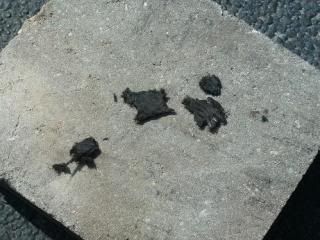

OK, got it up in the air and checked for case cracking or some other obvious stuff. Checks out.

Report this Post03-30-2010 03:27 PM Click Here to See the Profile for White 84 SESend a Private Message to White 84 SEDirect Link to This Post
White 84 SE
812 posts
Member since Nov 2008
Moved the starter out of the way and took out the flywheel to trans cover/splash guard. found some clutch plate debris in the little cubbie hole there. Obviously need a new clutch plate and this would explain the scratchy sound. So I am off to the auto parts store. Luckily I have a couple nearby. But other than a busted clutch plate don't know the extent of damage so far. Factory manual suggests faulty disc...yeah uh, fork and bearing assembly, binding disc hub to input shaft, clutch to flywheel bolts loose..... Seems quite clear the disc is dunk but I ought to look at the fork and bearing too. When I get back I will find out what procedures are in store but now I am taking a little walking break and a late lunch while I am at it.

Yep - Thats a pull it out and inspect to see whats damaged thing. If you didn't replace the throw out bearing before I would for sure now. Inspect the pressure plate/flywheel. I don't think you need to look at the other parts too critically, this shouldn't have damaged them.

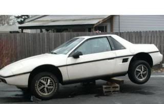

Dang! It is almost like I might have to drop the engine just to change out the clutch! Actually,that might be easier..... If it sounds like I am annoyed your pretty sharp! No, I will go by the factory manuals steps. Right now I need to go get a socket for the hubs and material to construct the engine support tool. (last time the 2x4" snapped and I was lucky)
But still, it seems crazy to drop the cradle just service the clutch.... gotta love it though.

Report this Post03-30-2010 09:15 PM Click Here to See the Profile for BlacktreeClick Here to visit Blacktree's HomePageSend a Private Message to BlacktreeDirect Link to This Post

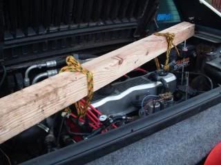

I used to have a Fiero with the Duke and 5-speed Isuzu. I made an engine support using 4x4 lumber and some long, threaded hooks. I drilled holes through the 4x4 for the threaded ends of the hooks, with big washers to spread the load. You should be able to get those items from the local hardware store.

Just an update, I got the axels off. Getting to that point took me 4 hours which included wheels, emergency brakes, getting a 30mm socket for the axel nuts, electric and tranny cables.... Had to go to work. I got tomorrow off. I wanna show you all the improvised engine support thing.

Well got the clutch out as per factory instruction. Well, mostly.... The manual calls for an engine support which is not available. Here's what I did....
It is sturdy...as a log ehhmm.... Used 2 2x4's glued and nailed together after getting a good fit. Wrapped 2 rounds of 300 pound rope at each lift support and tied off well. For the adjustable transmission support I lassoed the transmission to engine mounts and wrapped 2 times around the beam overhang. This allowed me to lower the transmission slowly to a board I positioned underneath. Cost was not much and in this way I was able to perform the tasks....one person.

The disc was completely smashed with debris all over the clutch case. The scratchy noise obviously came from this as also the inability to put into gear with the engine running. The fork looks unharmed, the bearing rolled pretty nice although I am swapping that anyway. Going with a new clutch plate even though the old looks fine just to be sure to get a good match.
