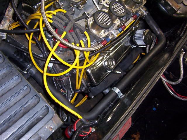

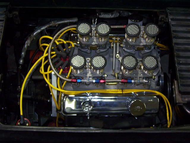

I'd like to see your setup, though. Feel free to post a shot here if you can do it easily. Thanks!

My last Fiero had such bad problems of overheating. I took care of every issue with this one...ie bigger radiator, lower psi caps, less rubber hose, better water pump, 180 t-stat, properly reading gauge, no restrictions, decent fan (no shroud though)etc.
I found that mine would run a little hot with the hood closed at idle. Open the hood and no problem. So I fiberglassed a similiar scoop to the Archie Warbler hood. No problems since. Try taking the hood off and see if your overheat goes away.

Here are some pics of my cooling system setup that you wanted to see.
This images is larger than 100K. Click to view.
the upside down electric water pump-to put the feed line closer to the passenger side coolant pipe.
oversized radiator w/ electric fan-don't mind the nose, the car hasn't been to the paint shop yet.
the custom made coolant pipe. made from header pipe J-bends. This keeps the rubber hose from expanding causing air pockets-a problem with my last V8 fiero.
pretty much I ran into many problems with my last fiero's cooling system. So far, I seemed to work out all the bugs. It hasn't run hot yet.

Nice setup.
You're really getting things done on that car.
One suggestion incase nobody has mentioned it. You really need to get some sort of shroud around your electric fan or a fan with an integrated shroud. You've got quite a bit of "unused" surface area there that you can be "optimizing" at idle with the use of a shroud that will allow the fan to pull air through a larger area.
I always look when I'm in the junkyard to see which other cars have an integrated shroud that I can remove the original fan from and install a higher CFM unit into. The nice this is: Some Saabs and imports have a pretty lager radiator so finding a plastic shroud that can be modified and pretty easily found. I'll be on a hunt for one during the next few weeks. I'll let you know what I come up with..
Keep up the good work.

Do you have a larger pic of the top of your engine. Great looking setup. I have a 308 replica and am looking to "disguise" the SBC just a bit. I love your intake setup.
Right now, I have a set of European Valve Covers and a few old Euro Cam Covers from OHC engines. I'm modifying my centerbolt valve covers to act as a mounting point for a "faux" valve cover. I also have a few plans for a cover for the HEI distributor as well.
Not that it's needed on a Fiero (or my replica for that matter) but I think what you've done is a great touch and very unique.
[This message has been edited by 3084me (edited 11-28-2006).]

Originally posted by 3084me:
Hey bmwguru,
I bought the webers three years ago for about $2,000 new. I was paralyzed in a freak incident and didn't install them until spring '06. (I have fully recovered by the way). Now they go for about $3,500....damn markup!!!
Anyway, are some better pictures.
Dave
