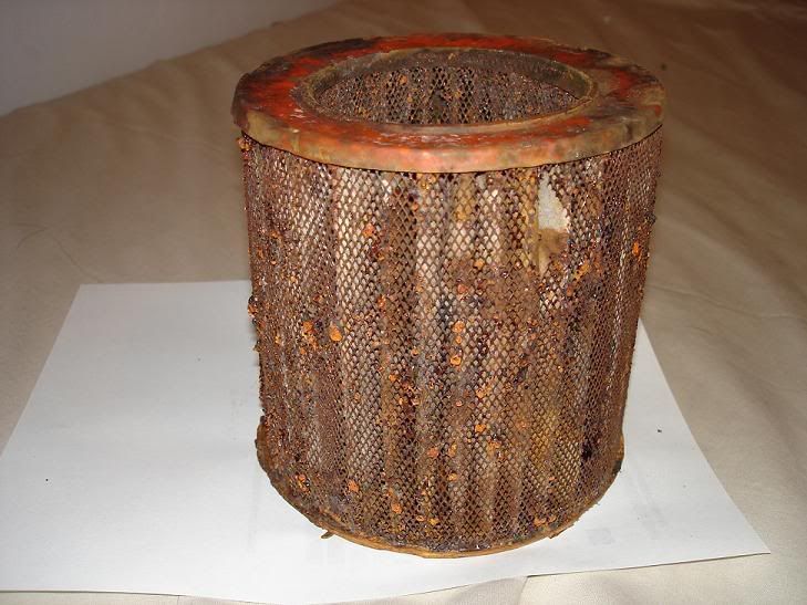

K&N Filter could be the problem if you haven't had it long. They plug up quick and all at once it seems. I think there was a good write-up on the subject of paper air filters vs. K&N types somewhere on the forum.

well, it came with the car, and i've had it over 3 years now. yes its been cleaned before, but its been a bit.

wow, noticeable power increase after cleaning the air filter, changing the o2 sensor, resetting the computer, and steam cleaning the engine.
Tomorrow: changing the plugs, replacing the coil, checking the timing, and seafoaming the engine.
when they arrive: changing to 8mm accel spark plug wires. shecked the cap/rotor yesterday, and it was good, so im leaving it.

feels like i just added 10 hp! runs nice and smooth now, though i did have to fill it up with 89 octane this time sence the station i went to was out of 87, thats something i have never done, so i wonder if that may play a role. i still have yet to check the timing, seafoam, or get that msd coil, but i did the wires and plugs, and i gotta say, those red 8mm accell plug wires match the engine red perfectly, and look GOOD!

moleman_in_a_FieroGT
Posts: 792
From: Houston, TX, USA
Registered: Apr 2006
Report this Post12-20-2006 04:39 PM Click Here to See the Profile for moleman_in_a_FieroGTSend a Private Message to moleman_in_a_FieroGTDirect Link to This Post
Originally posted by Falcon4:
Very odd... my car's getting about 13-15 MPG too - and it's exactly the same car. New plugs, new wires, cap, rotor, ignition module, pickup coil, O2 sensor, MAP sensor, IAC motor, umm... pretty much everything new. Except the air filter. Would that really make a huge difference??
Definitely. Especially if it looks like this...
(Came with the car, replaced right away)
Falcon4
Posts: 1189
From: Fresno, CA, USA
Registered: Oct 2006
Total ratings: 161
Report this Post12-20-2006 05:08 PM Click Here to See the Profile for Falcon4Click Here to visit Falcon4's HomePageSend a Private Message to Falcon4Direct Link to This Post
OMG.... wow, no... mine looks much cleaner than that. It actually looks very clean and seems to flow freely (just checked it out). However I did find more melted vacuum hoses... UGH. The hose coming off the throttle side of the plenum, which curves down past the EGR hose, is now plugged as well. Looks like the only place it goes is the cruise and the vapor canister though. I guess that won't hurt fuel economy... but I still don't know what will.
Old coil, maybe? Be a good investment to buy a new coil? *shrug*
