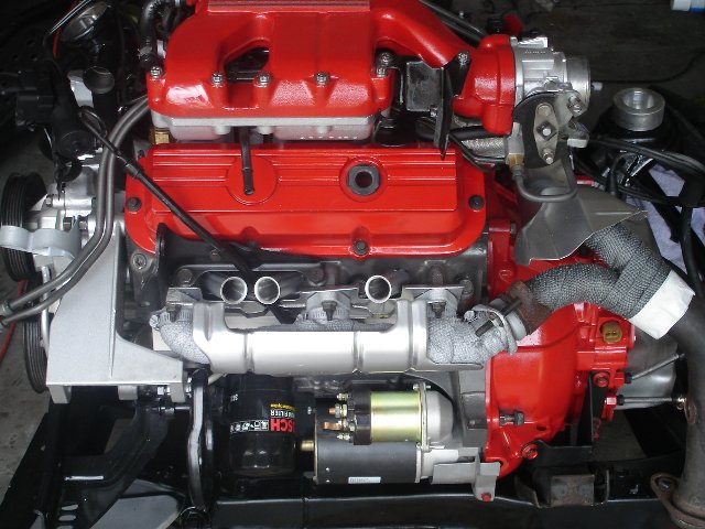

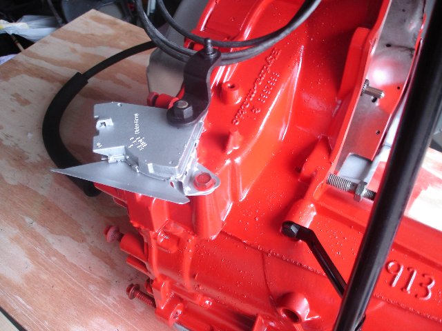

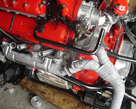

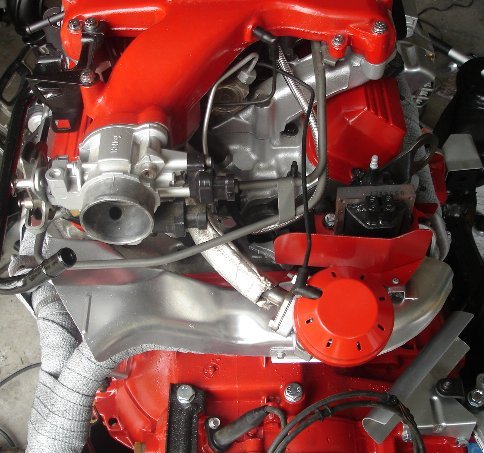

Did a little clean up on the tranny and started the last steps with the engine tonight...

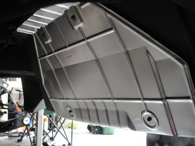

Heat shields in place...
The cleanest parts you'll never see... Lets just say I didnt care to see the old ones come off the car soooo rusted! Just a little rust protection going on here.

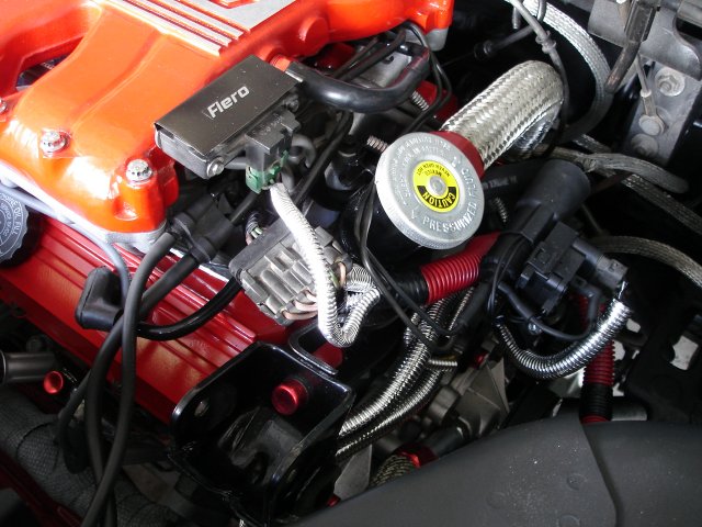

Quick shot of the engine...

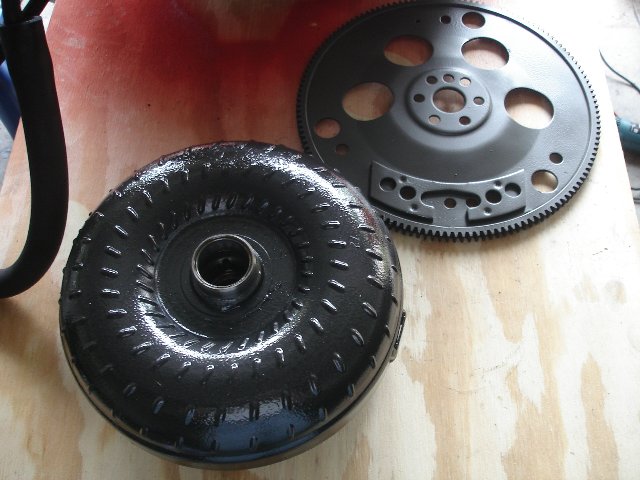

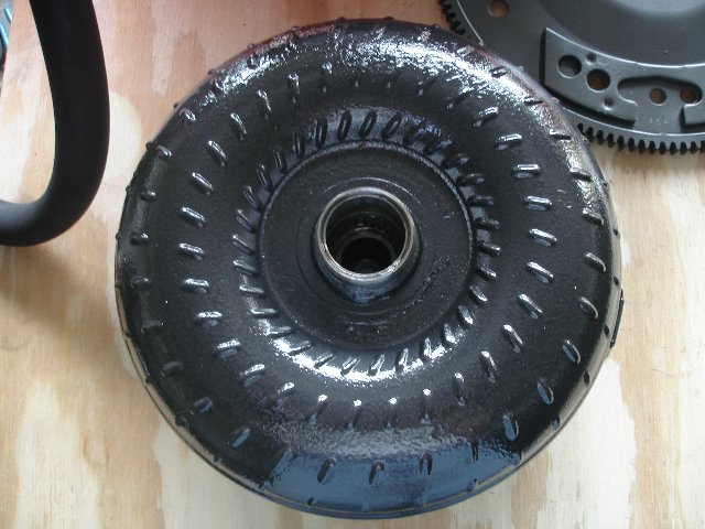

What torque converter did you decide to use?
powrmajik
Posts: 786
From: Orlando, FL
Registered: Feb 2003
Report this Post06-30-2006 07:35 AM Click Here to See the Profile for powrmajikSend a Private Message to powrmajikDirect Link to This Post
I ended up using a new stock one. We scratched up the one that was in the car when we pulled it out...it was pretty deep and we would have had leaks.
The 3500 stall one is still in the garage, maybe I can figure out something to do with it. I just couldnt see me sitting at a red light idling at 3500rpm waiting for the light to turn green and trying to convince the cop that I WASNT trying to race him! LOL

Report this Post06-30-2006 08:02 AM Click Here to See the Profile for 2002z28ssconvClick Here to visit 2002z28ssconv's HomePageSend a Private Message to 2002z28ssconvDirect Link to This Post
It doesn't make it idle that high. It just wouldn't fully engage until 3500. But yeah, it's probably better for race use anyway. Maybe a bit too high for daily commutes.

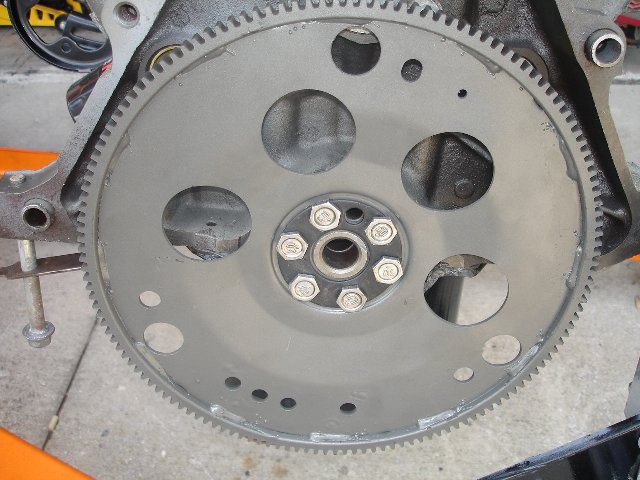

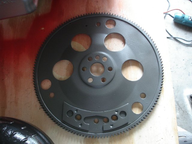

Ran into a slight problem this weekend...
Turns out the people who built my engine used a different crank and now the flywheel wont bolt up...UGH! It is exactly 1mm larger than the hole on the flywheel. I now have to wait till Monday to contact the shop and find out what size crank was used so I can find a flywheel to fit....

Well, that's odd. Maybe they installed a neutral-balance crankshaft?

IT's ON!!!!!!
Turned out...after vERY, VERY, close examination...there was what for lack of a better name I will call a "burr" on the crank. It almost looked like they tried to hammer on the end if it and made just the tiniest of chips which stuck up just enough to not let the flexplate fit. After a little walking of the plate It finally went on. Thats it! I'm done for today! I'll take this as a sign of better things to come with this build.

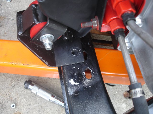

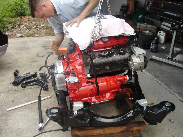

we got the tranny and motor mated today but ran into a snag with the W.C.F. Mounts. I'll let him tell the story.
powrmajik
Posts: 786
From: Orlando, FL
Report this Post07-22-2006 10:39 PM Click Here to See the Profile for powrmajikSend a Private Message to powrmajikDirect Link to This Post
Yes, tranny and engine are mated and sitting on the cradle...HOWEVER, my very expensive West Coast Fiero Tranny mounts DO NOT FIT! Ugh....Seeing as how time is not on my side with this project I am simply going to buy stock mounts...not a very happy camper right now. You can see the issue we ran into in the pictures below. We must have spent 2 hours trying every which way to make those darn things fit...just wasnt going to happen. Off to the parts store tomorrow to at least get new rubber mounts.
What is up with this! Spent a lot of money for something that doesnt fit...
Hopefully tomorrow will produce better results...
[This message has been edited by powrmajik (edited 07-22-2006).]

I recall that when I did my swap (3.4 dohc) I used WCF tranny mounts and that I had to 'pull them into place' with the mounting bolts as they were off a little bit not by that much. It's a shame they don't fit as they really are rock solid and hold the engine very solidly in place. My 3.4 hardly moves at all on the cradle.

I've sent an email with the above picture attached to West Coast Fiero...I'll wait and see what they have to say. I bought the solid aluminum cradle bushings as well, hope I dont run into an problems with those (dont think I will, but didnt think I'd run into trouble with the engine and tranny mounts either).

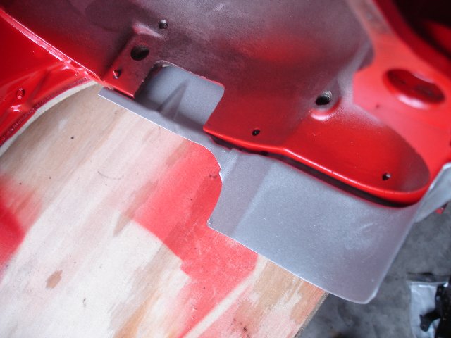

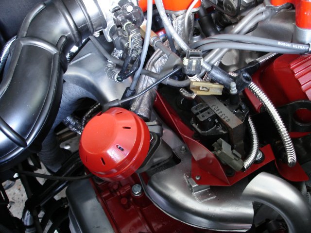

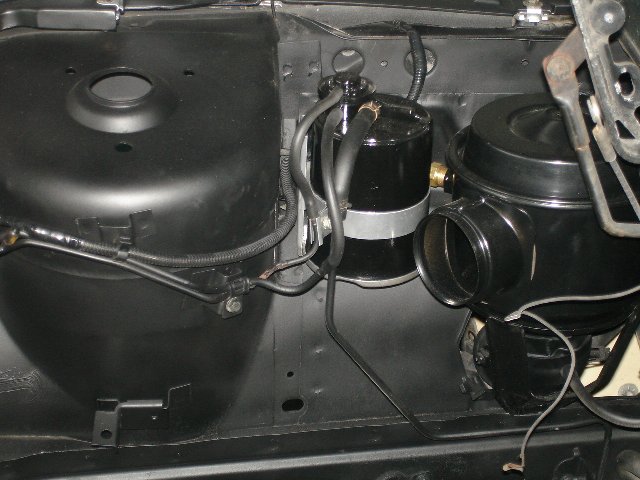

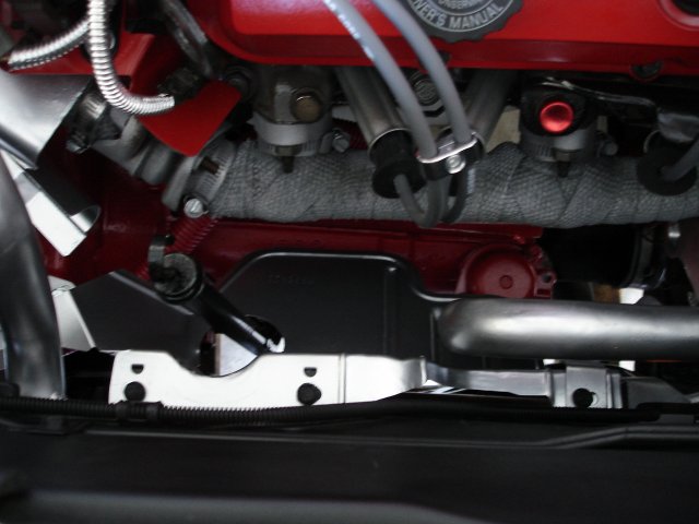

A little more progress...
Worked on the engine bay...
Some work on the engine...just added some heat shields, test fitted a partially wrapped Y-Pipe, and sealed the exhaust manifolds with VHT paint.

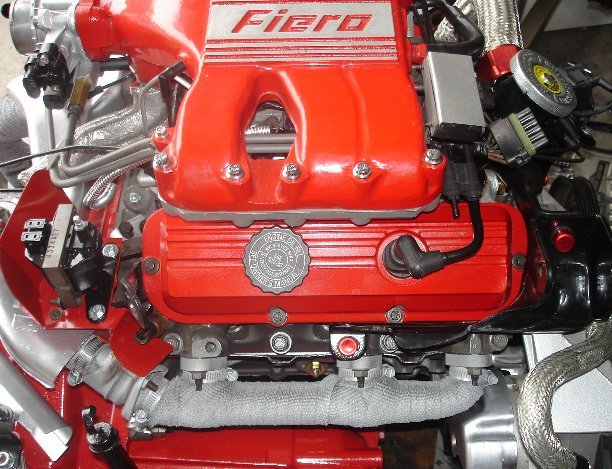

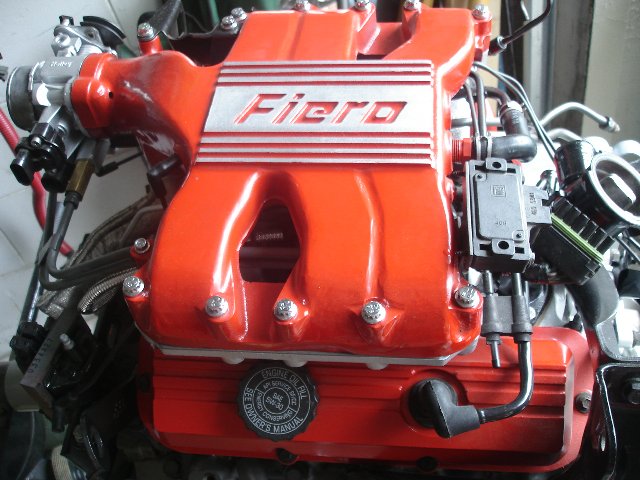

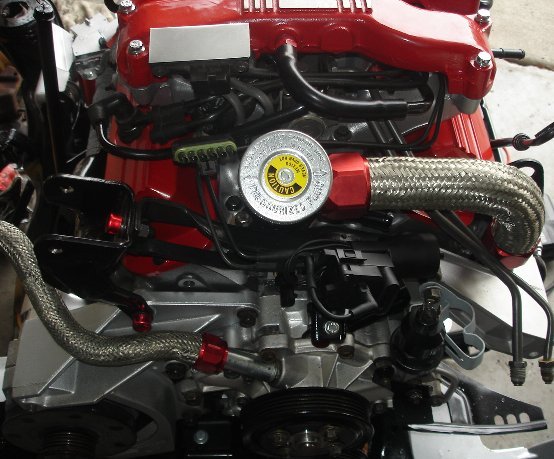

Here's a few more pics of the engine...
Shiny!

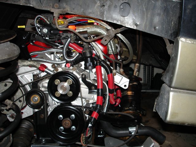

Report this Post08-03-2006 01:20 PM Click Here to See the Profile for powrmajikSend a Private Message to powrmajikDirect Link to This Post
I started wiring the engine...hopefully I can get some new pics up tonight.

I will NEVER buy anything from West Coast Fiero again....they are basically ignoring any and all of my requests regarding the poly mounts.
Someone from the forum suggested just prying them into place, welding or drilling new holes...I dont have the desire to do that so I will be putting them up for sale. If anyone is interested PM me else they will go on ebay.

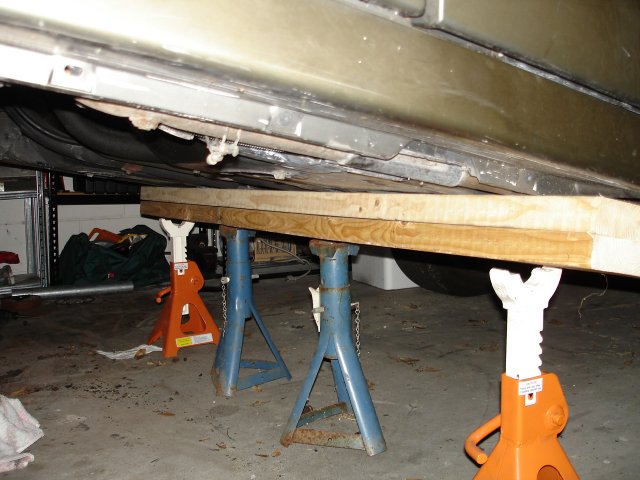

Report this Post08-21-2006 06:29 AM Click Here to See the Profile for powrmajikSend a Private Message to powrmajikDirect Link to This Post
Its been a little while since I posted but not much was missed anyway...lots f checking and rechecking to make sure I did everything before getting the cradle back into the car. All thats left right now is to prime the engine, drop in the distributor connect the spark plug wires, fill her with fluids and fire her up!
This is how I held the car up while I slid the engine in...very easy and stable.
Plenty of room...
And the engine is in...
Powr

That has to be one of the cleanest engies I have ever seen in a fiero, well at least somewhat stock! lol Looking great, keep it up, and don't let the bushing problems slow you down, some companies do that, I know all too well!

Got a chance to try and start it today...it was a no go on the first try. Adjusted the distributor and she fired right up! Purrs like a kitten, no leaks to boot!
I'm stopping here for tonight...finally I can end a day on a high note...no sense ruining it! Woo Hoo!!!
