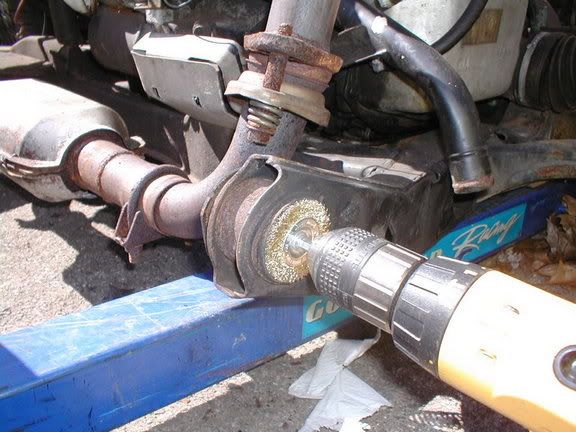

Well I have finally gotten around to starting my project...going with the name SCARAB. Dont know why...it just sounds cool!
Started with dropping the cradle in preparation for a new engine, Removing the front Cradle Bushings and Rear Cradle Bushings...

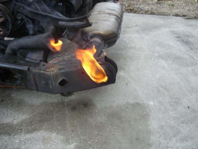

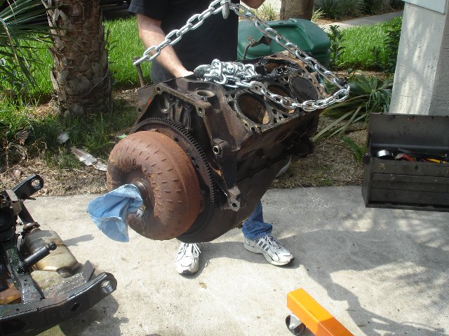

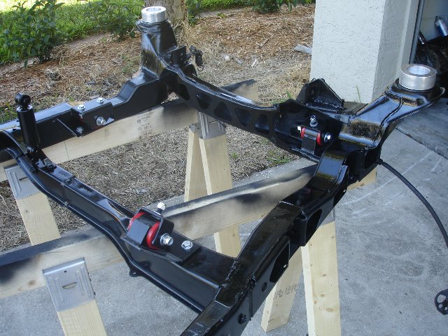

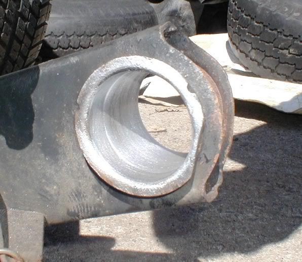

Continued work on the Scarab....
Pulled Engine...

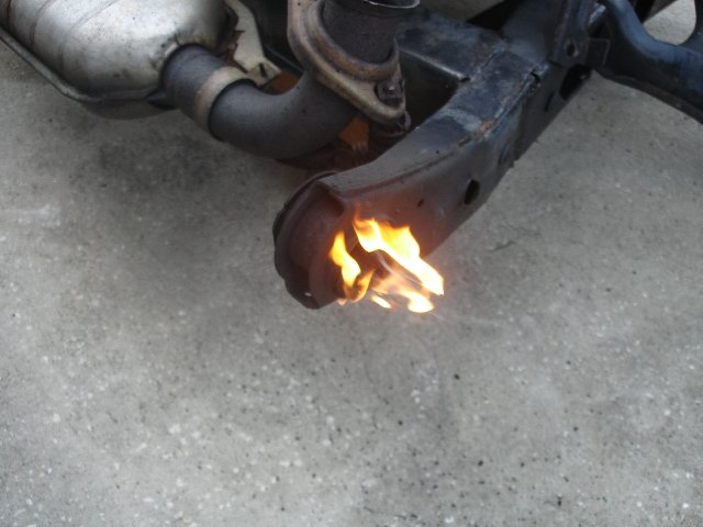

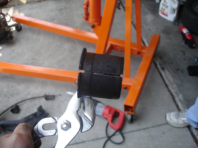

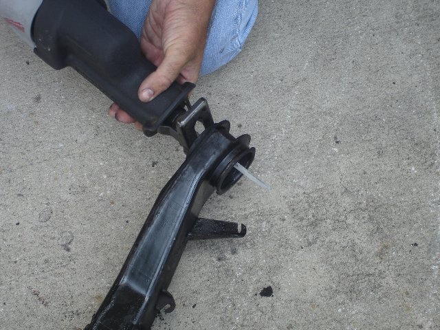

Because I'm using Aluminum Cradle bushings...the sleeves had to go...
Tomorrow I prep and paint the cradle...

Report this Post06-18-2006 06:37 PM Click Here to See the Profile for powrmajikSend a Private Message to powrmajikDirect Link to This Post
powrmajik
786 posts
Member since Feb 2003

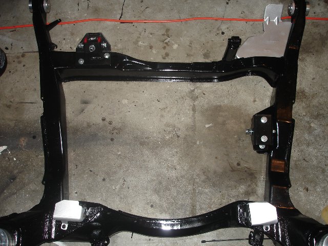

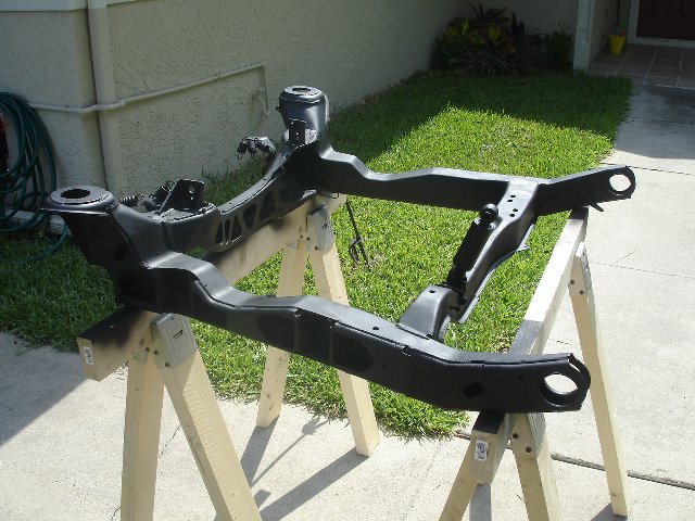

Once I got the cradle all cleaned up...I sprayed it with a rust inhibitor and black primer.

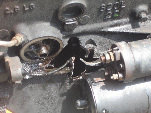

This was the problem with the engine that was in the car when I bought it...I had pictures in a different thread but thought I'd give a refresher for those who havent seen it. I was told it had a knock...some knock huh?! LOL
He should have said "he had a knock but then it stopped", which would be entirely true. He He
Thanks for the good pictures of your progress.

Believe it or not the car actually ran. I was able to move it around under its own power till it was parked. It spewed oil but it did run....had one of those nifty "audible" tachometers!

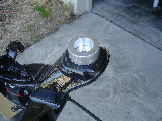

I really need to get around to doing my aluminum cradle bushings....Is removing the sleeve a must for the aluminum bushings?
Nothing like the smell of burning rubber....smells like..like a suspension upgrade is taking place
87 GT - Poly dogbone, RD comp short shifter, Ultimate Getrag Shift Kit, No Cat, FS rear sway bar, full poly suspension, 11.25" Labaron Brakes, (solid cradle bushings 06')
95 Geo Prizm - Can't get out of it's own way..but waaaay reliable.
powrmajik
Posts: 786
From: Orlando, FL
Report this Post06-19-2006 07:46 AM Click Here to See the Profile for powrmajikSend a Private Message to powrmajikDirect Link to This Post
From what I have heard...and I'm not 100% on this.
West Coast Fiero's aluminum bushings require that the sleeves be removed, Rodney Dickmans supposedly slide into the old sleeves once the rubber is removed. I have WCF aluminum bushings...both the front and rear.

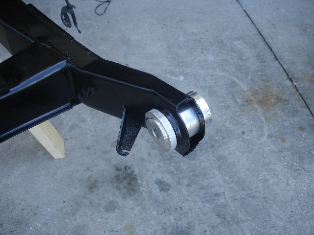

My aluminum bushings did not require sleeve removal. I heated the inner sleve and removed it, then a combo of a hole saw and appropriate size forstner bit to get the rubber out. Then I had to use the dremel to sand a few spots around the sleves so the bushings would insert. Apparently, the sleeves aren't perfectly round.

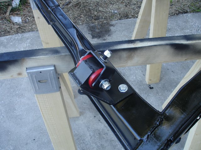

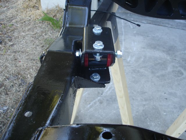

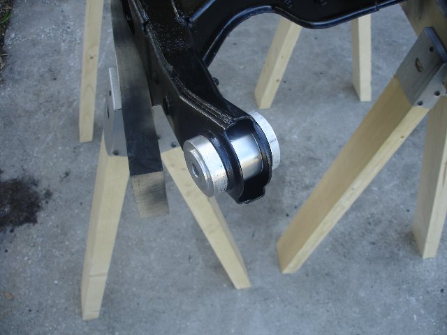

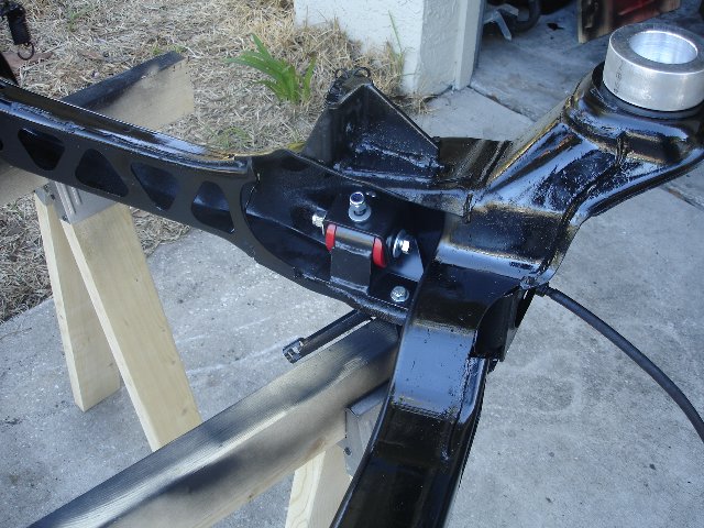

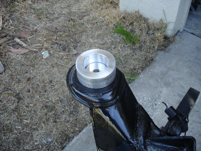

I am slowly progressing...ALL THE CLEANING!!!! Anyway, I got the new Poly Mounts and Aluminum Bushings from WCF put on the cradle....
Boy these sure look good!

Report this Post06-25-2006 12:38 AM Click Here to See the Profile for BlacktreeClick Here to visit Blacktree's HomePageSend a Private Message to BlacktreeDirect Link to This Post
Just out of curiosity, what type of paint did you use on the cradle?
CentralFloridaFieros
Posts: 363
From: Orlando, Florida, USA
Registered: Mar 2004
Report this Post06-25-2006 10:44 AM Click Here to See the Profile for CentralFloridaFierosClick Here to visit CentralFloridaFieros's HomePageSend a Private Message to CentralFloridaFierosDirect Link to This Post
HE used an Appliance Enamel. The same kind used on Washers/Ovens/Dryers. The stuff is tough, toughest paint I have ever run into. The Closest thing to Powder Coating in a rattle can. Since I lost my shop, Im going to use it on my front suspension when I get around to it.

Report this Post06-25-2006 03:39 PM Click Here to See the Profile for powrmajikSend a Private Message to powrmajikDirect Link to This Post
Yup..Appliance enamel...its actually an epoxy enamel so the stuff is pretty tuff. You can find it at Lowes or Home Depot.

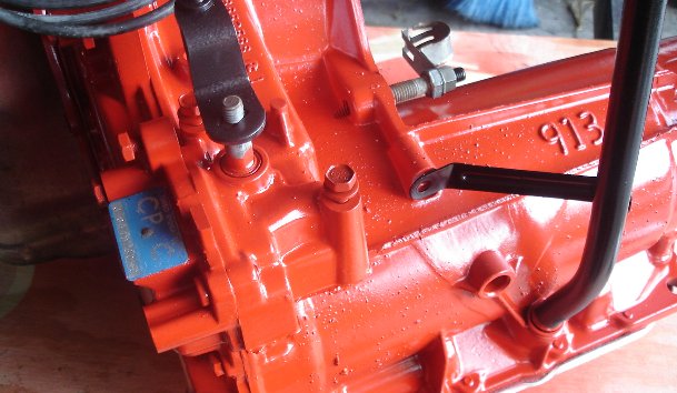

Report this Post06-25-2006 08:12 PM Click Here to See the Profile for powrmajikSend a Private Message to powrmajikDirect Link to This Post
powrmajik
786 posts

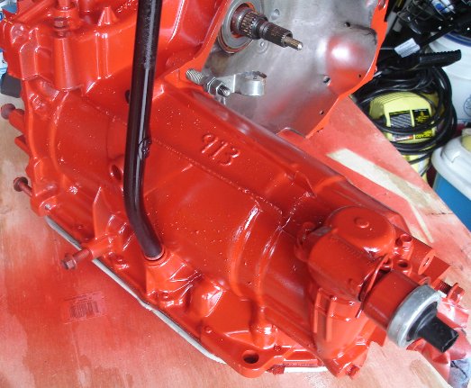

Got a little done with the tranny...
I'm starting to see some light at the end of the tunnel now. I only havea few small parts to clean and paint. Then onto the engine!

I start the cleaning/painting process on my auto tranny tomorrow.

Try to remember where everything goes once you take it off....heat shields etc.! I got into such a rush I forgot where most things went. Had to post another message on the board to figure out what went where! LOL

Ok...rainout tonight so all I could do was attach the heat shields to the cradle and clean...clean...clean...
I'm nearing the end of the cleaning stage though...finished up the last of the "parts to be painted", they are primed and will sit overnight to dry. The next few days will prove interesting as I try to figure out where everything goes! LOL
Here's tonight pic...my "mystery heat shields" have found their rightful place on the cradle.

I have the bracket installed on my engine. The engine is still on a stand, but at least you'll see how it goes on. Plus, I'll be putting the brackets on the tranny tomorrow. I'll take some photos for ya.
