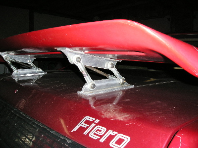

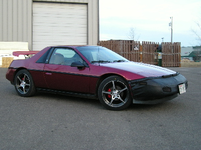

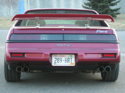

I added a wing to my 88 coupe but also built custom stands which added more weight yet. If its not windy out I can get the lid to stay up with the stock springs. I have a set of gas struts in the works to solve the falling lid issue.
I set the wing on the lid before mounting and kept moving it and veiwing from different angles till I was completly satisfied with the location...... its all personal prefference.
Heres a few pics(wing is fadded red in pics but is now color matched)

That looks awesome! Probably pretty easy to steal though.

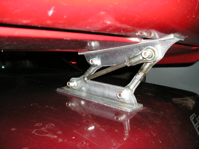

Steven Snyder- If someone tried to steal it they wouldnt get away with the whole thing unless they pried it off the lid. The wing would rip right off like any of them but the stands would still be there unless they spent the time to dissasemble them but theyed still need to pry off the bases because theres 4 bolts in each.
jscott1- I've seen stars a few times because of that thing catching me off guard
I think this pic shows how they are bolted to the lid
