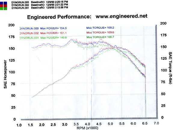

Originally posted by goatnipples2002:
Good luck to you guys, but not to bring you down many have tried, MANY have failed to get the fiero intake to flow enough for the 2.8 to make power at 6k and the 3.4 needs more air.
No streetable Fiero cam I have seen is designed to make peak power over 5200rpm. Most make there peak in the 4200-4800 range. Darrel's TB and a ported intake allow for plenty of power to be made to 5000rpm with a 3.4.
Look at my dyno chart: http://www.geocities.com/lou_dias/Fiero.html
now show me a Truleo 3.4 with a Darrel TB that has made more power than that.
Honestly, the exhaust is a bigger restriction in a 3.4 Fiero than the intake. No body seems to believe me when I say that if you have $600 to burn, burn it on real headers/crossover and a 2.5" exhaust. On a 3.4 you will see a 15-30 REAR WHEEL hp difference in peak HP.
I've dyno'd a 10rwhp gain just by removing the EGR valve on the crossover pipe and letting the exhaust flow freely there.
I'm not knocking the Trueleo at all. I'm just saying it's crippled by an exhaust that everyone ignores. I've made more hp with a stock ported intake and freer flowing exhaust than anyone with a Trueleo intake and stock exhaust.
Cost of my mods:
Sprint headers $520 (back then)
IRM Dual exhaust $200
hollow cat (my arm and a crowbar)
$720
the funny part is that a custom exhaust shop can build you a better 2.5" exhaust for about $600
Honstly the Sprints aren't worth the money the Fiero Store is asking for (over 600 now, yikes!). There's someone on the forum here that builds a better set of headers for under half the cost. Steve Hamm I think...
That being said, I'll eventually get a Trueleo intake...AFTER I've done all my other mods. It's a finishing piece not a starting point to get those last few extra hp. IMHO
Lou

Originally posted by Alex4mula:
This manifold has that done and more.
With the rest of your mods except ported heads and stock cam this is what I got with the moded manifold (previous was Darrel ported as well as TB), 2.5HP;
I have yet to see a FI 3.4 engine to break the 150 rwHP barrier. This fall I'll put the H270 cam (ordered already) and roller rockers with my Darrel ported intake. I'll take it to the dyno and see how it does but this will be with an automatic tranny so we will see also how that affects. Then I plan to get the Truleo and hit the dyno again in hopes to break that 150hp
I was right at 150. And I didn't have that intake. I used the H260 cam not the H272. My next 3.4/3.5 will surpass most 4.9's in power. It will be documented in about 8 months to a year. I'm iffy on whether I want a roller cam black or standard hydrolic... Need to find a reasonably priced performance roller cam. But I will be using Fiero heads, computer and injection. BTW 1fst2m6's 2.8 dynoed at 154rwhp. I also will be shortening my next intake the way he did.
ps, I was still making about 127rwhp @ 6000 rpm so much for the Fiero intake not flowing when it's ported...
Also, I removed the air filter tube and ran an open throttle body on one where the previous run I was making 145 hp (before I got the timing right) and made 145 peak hp @ 5500 rpm instead of 4500 rpm. All it did was shift my power band over to the right 1000 rpm.
I'm telling you (all), just get a real exhaust system.
[This message has been edited by lou_dias (edited 08-22-2005).]
I don't think that would be the case at all. Even on a big 350 you loose good torque when going from TPI to a short runner Stealth Ram. But you gain a lot of HP
Yeah but that's a radical change on a 350 (just like it was radical for a 2.8). If you made the 350 into a 400 then kept the same intake then replaced with a shorter one, do you think you'll stick lose much torque? I would say you are closer to what is required by the higher displacement as far as flow goes. Everybody told me I would loose torque by eliminating the cat AND muffler and I only picked up even more power everywhere.
I removed the EGR valve completely off the cross-over and picked up another 10 hp and 10 ft*lbs. That's not streetable and my listed peak is not with that mod ... but it proves a point. I was already running Sprints, a hollow cat and NO muffler.
This motor is constipated. You can open up the intake all you want, that fresh air isn't filling the cylinders because the exhaust has no where to go.
I'll be the first in line to buy a Trueleo EXHAUST. And I will put my money where my mouth is. Make me a 2.5" exhaust with 1/8" larger diameter than stock tubing on the headers going into a larger diameter crossover with a 2.5" downpipe and I'll be customer #1. Francis you have my word.

Building a 2.5" exhaust is much easier than building an intake manifold. I think I'll ditch my Borla exhaust and build one instead for this swap. Problem is I won't be able to test it before and after. But depending on the final dyno numbers I will see if it did any good overall.
Originally posted by lou_dias:
...I removed the EGR valve completely off the cross-over and picked up another 10 hp and 10 ft*lbs. That's not streetable and my listed peak is not with that mod ... but it proves a point. I was already running Sprints, a hollow cat and NO muffler.
Got a question; So your dyno result was with no cat nor muffler? Was it with stock cam too? I think you told me way back but I forgot.
