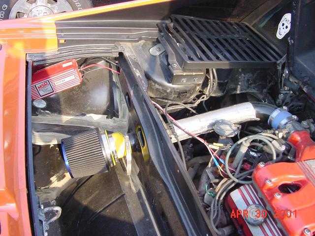

this... is a strange intake..
[This message has been edited by 1FST2M6 (edited 05-02-2001).]
What the F*CK is that???? That's the dumbest thing I have EVERY SEEN in my life, why not just put it in the truck so it can suck ALL THE good oxygen out after 15 minutes so now the engine is CHOCKING, not to mention HEAT because there is no protection... WHAT in god's name made you do that!?
PLEASE give me some sort of intelligent explanation why that works, because quite frankly, it looks stupid and im-practical and a GREAT way to WRECK your trunk

i guess your not very familier with the cars then hunh.. there is a large hold 3.7"x5.3" on the passengerside of the trunk where the fan was installed on all the pre 88 cars. this lets the air in and it's protected from the water and heat cause it's on the passenger side where the exhaust isn't, and it's about 28" off the road. as for the heat in the trunk.. uum have you ever actually put a thermometer in there and drove around??? it RARELY gets above ambient temperature.. only in traffic will it creep up and even then only 10* or so. I droped 2 tenths off my 1/8 mile time with just this intake change. as for the waste of my trunk.. i never use it anyway.. my last car had the same MSD box and a nitrous bottle and a host of other goodies.. why have a toy if your gunna be practical? i could carless if my trunk was usable i want fast.. I had Fast before(13.6@103) and traded it for slow and a blank canvas. my blank canvas has found 53hp and 30+lbft at the wheels since my purchasing it. (103-132 to 153-168) it's a fiero.. who needs a trunk nothing fits in it anyway. It's not a car for a real week long road trip(except Phils).. i've driven it to Detriot (10hours @ 80) and my SE i drove to Florida a few times (atl to sandestin) 8ish hours and i've never had a heat problem in either car in the pseudo-trunk it has room for my single bag... in the event i HAVE to drive with more then me in the car for any period of time or to work or in the rain i've got an Alfa Romeo 164L a Saturn SC2 or a Miata i can choose from...
my former SE now owned by GT Bastard.. https://www.fiero.nl/uploads/travis.jpg https://www.fiero.nl/uploads/corbeau.jpg (these aren't practical either...) www.fiero.nl/uploads/2m6dyno.jpg https://www.fiero.nl/uploads/1fst4puck.jpg (way not practical)
why does form have to meet function? B&O have skewed this for 40+ years.. why can't a bored engineering student transform a Fiero into a fun toy?
