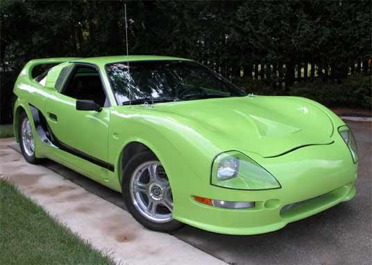

Space is not an issue since I have a Fino with the glass hatch on the rear. I am wondering if I can use the intakes just behind each side window as dual cold air intakes? Would I lose air if I left them facing away from the front?
Maybe I should find a way to reverse them for the ram-air effect?

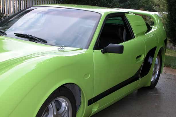

If I reversed the intake, it would look something like this...

Kohburn, your plan sounds great! The area in front of the rear wheels is not cut out, yet. It can be done very easily, though.
I'm wondering if it would look cool to use those upper vents as intakes, or am I just making a lot of work for myself?...

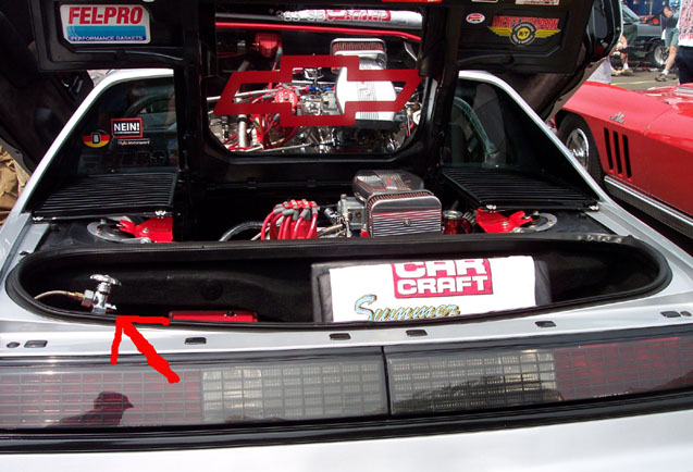

i have two ideas but no v8. this is the first one from an old thread...
https://www.fiero.nl/forum/Archives/Archive-000002/HTML/20030204-1-021087.html
i had this working on a 4cyl and i believe it would work with a v8. i put an indy scoop on my chopper and i hope the idea will transfer using a better flowing carb hat if i ever finish it.
the second i don't have a pic of but i recently put it on the same car. it's two fi-air-o type scoops with aluminum canisters at their bases. each holds a conical filter and feeds the duke intake. i cut the snorkel on the air filter housing and tee'd a 3.5" tube onto it that connects to each filter canister. again, when i try a more serious attempt i'll be looking at modding a carb hat to connect them to.

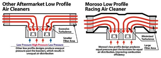

Here is a pick which demonstrates why the vast majority of performance carb'd cars use a circular air breather. Note that Holley also makes a really nice air breather which draws from two opposing sides so each set of barrels get fed evenly. BTW, the Moroso design is widely copied and the type is known in many performance shops as the "Corvette aircleaner"
With all due respect to all, I am willing to bet that any 4 barrel v8 using a hat will perform better with a well designed circular air cleaner.

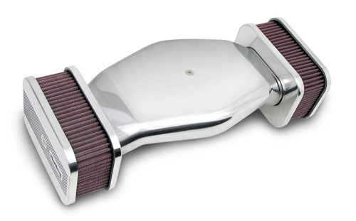

what if you used something like this instead of a regular carb hat?
http://cgi.ebay.com/ebaymotors/Dodge-Durango-Dakota-Ram-Dual-Intake-3-9-5-2-5-9-V8_W0QQcmdZViewItemQQcategoryZ38634QQitemZ7990844498QQrdZ1
so that the intake didn't have to narrow down into just a 3" or 3.5" intake opening. something similar to this is what i'm wanting to try bettween my dual intakes.

I think the Holley is the better design for 4 barrel, but to each his own. The one on Ebay, by the look of it, will generate alot of turbulence right above the venturi's. Again, what works for a 2 barrel isn't necessarily what works for a 4 barrel.
In fact, I wish I'd seen that one before I bought my air cleaners for my 2 barrel. (I've tried 4 different ones so far) It might have performed pretty well. However, it looks like it is designed to have the air cleaners above the exhaust manifolds, and that might be a hot air problem on a Fiero.

the ebay one would make setup easy - but i don't like the design - like arns said too much turbulance

Tina
Posts: 2858
From: At an elevation of 8564 feet.
Total ratings: 119
Report this Post08-03-2005 04:38 PM Click Here to See the Profile for TinaSend a Private Message to TinaDirect Link to This Post
Ahhh, the Hi Tek. Pretty good looking, too bad you have to cut almost half off to make it fit in a stock engine bay.
Works real well though then, if your trying to get the fuel in your carb to perculate.
I still use mine for shows (saves me from detailing the carb), but for driving it goes into the trunk.
Now if you got more room back there cause you swapped the body, like you Saxman.
It just might work in it's orginal form, but just keep in mind the thing being solid metal, it will soak up the heat from the surrounding area
and create hotter than usual air. Carbs don't like that.
Tina

Honestly Saxman, at the moment I just can't picture how much more room you got due to the body kit.
I've talked to people with Ferrari kits that were able to fit the whole darn thing and close the lid, but that is them.
Now reading this post over again, I think I got the drift on what you were thinking about.
Use the Hi-Tek as part of a dual air intake. Take the air from the window vents to bring down the temps.
# 1 Problem is, the darn thing get's so hot underneath, you can fry an egg on the Hi-Tek.
So you would have to find something simular, staying away from metal.
# 2 The air from the vents will carry dirt. Considering you got the glass cover, you will have to find a real good filter, wouldn't want to scratch that glass.
Cause you will see an increased amount of dirt in the engine bay.
Still, looking at your car. You really don't have a place to vent. That seems to be the main issue.
My approach, if it was my car. Take the back lid off, beat on it and see what the temp does.
I got this feeling that you are not nessesarily making more heat, rather ... considering the back end of it,
are storing it in back more than a conventional set up.
BTW ... These slots above the back lights, any way you could vent/force the hot air out there?
Perhaps with (I don't know, how many slots do you have?) 7 or 8 little fans?
Your carb would a lot happier, I bet.
If you still wanted to go with a cold air intake, i'd take it from the quarter panels though. Making them functional, sticking some filter behind them connected to some flexible tubing and run it into the carb from one or both sides.
Good Luck with it

this is kid of what I had in mind of welding out of 3" tube plus two flat peices in the hat section - there are a lot of different transitions that could he done in that area.. may even make more sence to use a standard cylinder filter and simply have the tubing to duct the air to the filter since the filter itself smooths the flow of air into the carb
Arns85GT
Posts: 11159
From: London, Ontario, Canada
Total ratings: 202
Report this Post08-04-2005 08:46 AM Click Here to See the Profile for Arns85GTSend a Private Message to Arns85GTDirect Link to This Post
Kohburn, that is a nice little design.
The thing you could do to improve it would be to have the pipes come in to the hat at 180* from each other.
That would ensure each bank of barrels got it's own air stream.
Having those K&N"s under the grills should work.
Arn
that's about what i want to try. at the moment since i am just using a stock duke filter housing in the middle i am just using the stock style air filter instead of the cones in the side housings. didn't see the need of starting to use them with just the 4cyl.
i'm gonna make an attempt to grab my brother's camera if he has it 'cause that's real close to where i am now. my middle section's pretty rough though 'cause i just don't feel the need to put a lot of effort into it for a duke.
Kohburn,
That graphic is just what I had in mind. That's a great idea to have open pipes feed into a circular filter, but would the casing for the filter be so large that it would look awkward? Could two filtered pipes come together into one that dumps straight down into the carb? I suppose that would cut down the air flow to the carb...
I need to at least get something temporary in for now. Something like this (below) as Riley suggested would take care of things until I got the full dual intake figured out. I think it should reach down closer to the front of the wheel, though. I think I can make one of these from parts on eBay to get me by.
