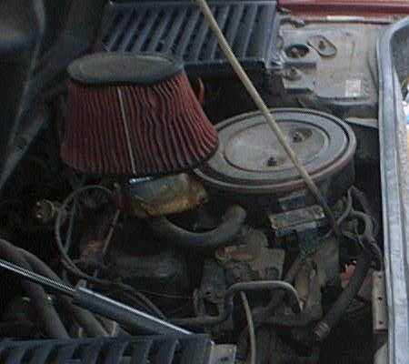

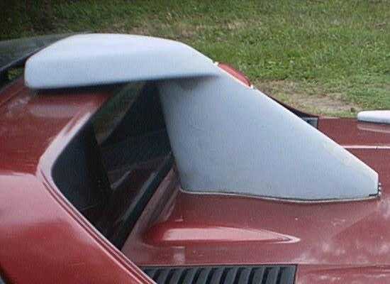

first this disclaimer: i say functional in the fact that it is an indy scoop and the intake is under it. other's can argue weather it is more functional, better or worse flowing or has ram air capability. it's something i wanted to try and hopefully if i am able to swap engines in the future, the idea can tranfer over.
it started with liking the scoop and getting it for my '87 coupe, then wanting it to be more than a big piece glass on the car. i first cut a hole in the lid for cooling. then played with the shape of the intake so it was under it then found a filter that would fit.

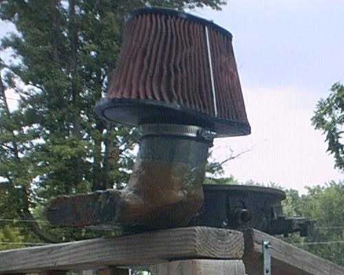

no rocket science obviously. i cut the original snorkle down, covered the opening and cut a hole in the side. then got some electrical conduit the happened to have the right diameter and curve in it and tacked it on. then i wrapped fiberglass around it to seal it.
once i found the filter (this past spring or so) and glassed the welded spots i took the original filter out. it's been together more or less this way for a few years with no hydro probs (the tube you see coming down in the pics is water drainage under the scoop. don't know if it's needed or even helps, but it seemed like something to include).

From the looks of the first pic, it seems all the fresh air is being deflected overthe scoop with your sunroof open.

bc, i wondered the same thing myself. i did careful scientific study on it by driving at highway speed and flipping my sunroof back and forth while feeling for some engine change and watching my air/fuel meter and vaccume/boost (just used for vaccume for now) guage. i really can't tell a difference either way.
rex, yes that's a brake light i got cheap with about 4-5 for spares. i'd really like something thinner and longer that runs down the back.
cost, $200 (in a club at the time so i got it for $180) from irm, which i guess is no longer in business but i think a couple other places have them. after that, nuts, bolts, the aluminum plate on the lid were minimal cost. as were the pipe and glass on the filter housing. got the filter at a swap meet for $5.
i have to take it off to raise the lid. i didn't put it on as instructed 'cause it isn't as easy to make it functional that way. if you can see in the second pic there is half a hinge on the end of the aluminum plate. i finagled the hinge to come off once it is raised so far. ever seen any military test equipment? that's where i got the idea. in stock form there is a gas strut under the scoop that holds the scoop up for opening the lid.
