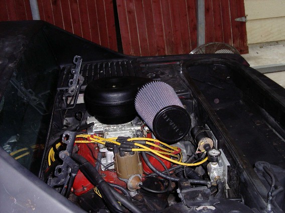

The Airaid carb kit seems plenty big! Looks like a good starting place for a carbed Fiero cold air setup.

[QUOTE]Originally posted by DanielKJenkins:
QUOTE]
I'm going to check that out. Let's see - where to buy...

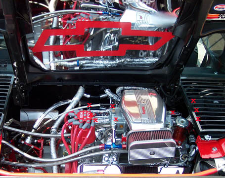

Originally posted by RacerX10:
Also : Tina what intake manifold are you running ? I'm trying to figure out where it's all going to land, vertically.
At the moment, the Air gap.
Rather than explaining on where you run into clearance issues, I just marked some of the areas with a red X.
Height clearance is also a issue depending on what decklid/ scoop you are going with.
The way it sits right now it just barely clears the Mopar 6 pack.
...another thing ... the torque flex, unless of course yours is already solid mounted.
Tina
Saxman, I wish I took a picture last year of my cold air intake I ran.
Pretty much boiled down to though ....Airfilter behind the quarter panel > 3 inch diameter pipe (just long enough to get past the frame)
> flexible airplane tubing (routed in a way to avoid the bigger hot spots) > plastic carbhat.
I could of went with metal tubing all the way, but metal absorbs heat> warmer air> unhappy car> less horsies.
[/QUOTE]
