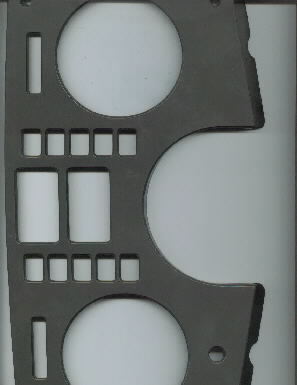

I guess it would depend which lighting system you have, backlit or side-but wonder if you paint the back side of the brushed alum looking bezel with white or other reflective paint, would that reflect light back onto the gages and needles? I have mine off right now and noticed there is a lot of white light that seems to just be directed right into the decorative cover. Haven't tried it myself, but may next week. It might help with the brightness issue. I'm talking about painting the back side of this piece:
