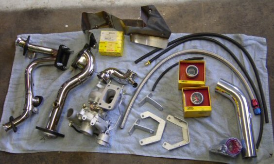

That's right! The wonderful man in the brown truck brought me my Dennis LaGrua turbo kit yesterday! I'm pretty pumped about it.
I've been looking at turbo kits for almost a year now. I finally decided on buying Dennis' kit because he offered it for the 3.4L and it came with all hardware and a programmed computer chip for the right fuel management. As I was researching this topic, I was dissapointed to see there wasn't that much information on turbo kits in the forum archives, let alone a writeup of a Dennis turbo kit install. So I've decided to dedicate this thread to my installation of this kit.
I wanted to post some pictures I took today of the kit, but I couldn't get PIP to work. It just locked up on me whenever I tried to post the pictures. Has anyone else had this problem? What could I be doing wrong?
So far I have only installed two items on the kit. I didn't really have any time to do it yesterday as I was working from 8 am until 9:30 pm. The first step in the installation is to install the computer chip and the 2 Bar map sensor. I have completed this with ease and started the engine up. Everything ran fine, which is a good sign I installed the chip and sensor right. Piece of cake! I also installed the fitting on the hose for the oil return line. This required some effort to get that dang fitting on, but after I sprayed a little Super Lube on it, it went in fine.
The next step is to remove the oil pan and drill a hole for the oil return line. As far as I can tell this will be the most difficult part of the installation. Since the engine is already in the car, I will have to remove the starter and front engine mount before the oil pan can come out. I don't know when I will be able to complete this as I have to get under the car to do this. I work at a Pontiac dealership so I have access to the shop, hoists, mechanics, and all sorts of nifty equipment. As of yet, the shop is extremely busy and an open bay has not become available. It may be a few days before I am able to get access to a lift, but I will keep everyone posted on the status.

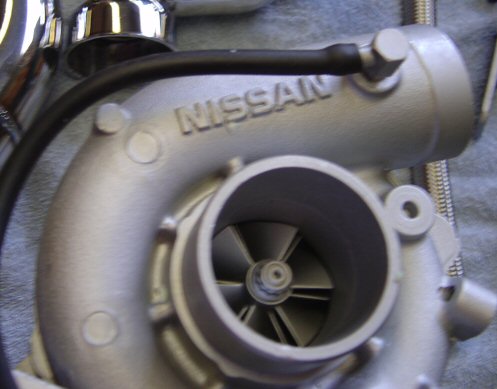

Okay, I think I got this picture thing figured out. I'll try a test one.
This should be a closeup of the turbo. What's with the NISSAN!!!

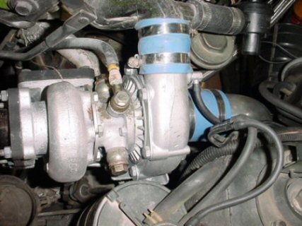

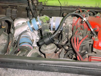

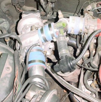

Some more pics...
This morning the exhaust shop was able to squeeze me in and connect the downpipe to the rest of my exhaust. Man, that car is a lot quieter now. The exhaust note used to be quite loud, it sounded lumpy and all. Now is is very quiet. Guess that's just what a turbo does!
I have gone out and driven the car more. It seems to run a little bit better. It still bogs a little at WOT though. And the bad news is I smell clutch. That clutch only had like 5,000 miles on it too. When I step on it, it does hesitate a little before it revs up, but I know this isn't turbo lag...it is something else.
I think I will take the advice of others and gap my spark plugs to 0.35. Right now I think they are at 0.45.
I sure hope I'm not getting any detonation...
It seems to be running rich or something. At WOT my A/F gauge reads quite rich, is this normal?
I got a TON of smoke out of it this morning when I started it up. It almost smelled like oil. The propshaft on the turbo impeller had quite a bit of play in it on both the exhaust and intake ends. One of our mechanics said this is a bad thing.
I think I'll drive the sucker around a little bit more to see if I can find any more flaws in the system. Then I'll probably contact Dennis and see if we can't get things worked out.

Yes, shaft play is a very bad thing for a turbo. It means the bearing is going out which will make the shaft eat away at the seals. When that happens enough, your turbo starts spitting oil out of it. If it continues, then the blades will contact the housing. Then the turbo is toast. You can't even rebuild a turbo when it goes that far.
Running rich at WOT is bad but it isn't nearly as bad is running lean. You want it slightly on the rich side but you don't want to just dump fuel into the cylinders.
That turbo looks like a T25. That is a very common turbo. If it is bad, then I know where you can get a brand new one for $200. Let me know if you are interrested and I'll give you the email.
