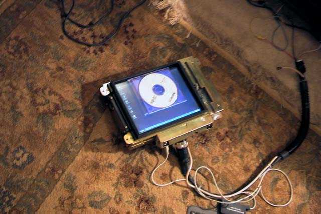

Check THIS out! 10.4 tft touch screen all in one unit, runs on laptop car adapter.
Steve
Specs:
Toshiba LTM10C306J 1024 x 768 @ 200 nit 10.4"
10.4" capacitive microtouch touch screen and controller
Celeron 400 or 366Mhz processor with BX chipset
64 meg (SODIMM, so upgradeable)
5 gig hitachi laptop HD
Built in BT879KHF TV tuner (think it might have FM too)
1 serial
1 usb
1 PS2 (keyboard or mouse)
Runs on 24 volt DC (I am using a 20 volt dell laptop supply to run mine)

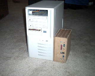

Just got done makeing my case, it measures:
7.75" x 7.75" x 3.75"
If I went with an external harddrive I could cut the height down to 2.5"
Now where to put it.

Here's my prototype case, need to install the power plug and the power switch, the real case will be molded plasic. Right now the harddrive is mounted above the MB I might end up putting it beside the MB that way I should be able to slide it under the seat, My plan is to have everything USB except the monitor and power, so it's only about 3 things to unplug, easily removable, so I can also use it in another car, or in home.

Installed My prototype yesterday, So far so good, I've just got both the LCD and the computer pluged into the Cig.lighter(in my Integra for now), the LCD is just taped in place, Don't have the wireless installed yet, only problem is I've got to smooth out the power going to the computer, when certain things kick in and out at idle(brake lights, air-con....) the hiccupps in the power cause the computer to shutdown(need to put a cap inline), the real surprise is that the on-board soundcard sound real good, between the mid priced JVC head-unit I've got, and the on-board playing 192kbps WMA files there virtually identical!

Report this Post12-18-2003 05:30 PM Click Here to See the Profile for cancerkazooClick Here to visit cancerkazoo's HomePageSend a Private Message to cancerkazooDirect Link to This Post
I tested out my rig in the winterbeater today(got my screen today). Here are a couple of quick pics. Sorry about the flash in the in vehicle pic.
Steve

cancerkazoo
Posts: 672
From: MI, USA
Report this Post12-18-2003 06:49 PM Click Here to See the Profile for cancerkazooClick Here to visit cancerkazoo's HomePageSend a Private Message to cancerkazooDirect Link to This Post
I'm useing 2000 right now. Xp didn't like the touchscreen controller.
Steve

cancerkazoo
Posts: 672
From: MI, USA
Report this Post12-20-2003 10:44 AM Click Here to See the Profile for cancerkazooClick Here to visit cancerkazoo's HomePageSend a Private Message to cancerkazooDirect Link to This Post
I am using a HP e-Vectra. It uses an external 19v PSU so I bought a 12v laptop PSU, it works great. If anyone is thinkig about this, they usually go for $150 on ebay and mine has PIII 733mhx cpu, 256 mb ram, and best of all can run off of a $20 12v adaptor.
If you can find a one with a fcpga 533a (.18 process) celeron that is the lowest power consuming cpu at 11.2 watts(for referance a pentium 100mhz draws 10.75 watts max and a pentium 166 draws 14.5 watts), my processor pulls 19.1 watts, according to the "Ugrading and Repairing PCs" 12th edition.
