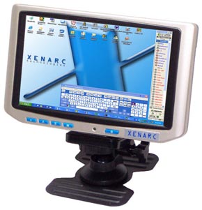

Don't use a desktop lcd.
Anybody who's anybody in the carputer world uses this:
It's only one piece in my arsenal of secret carputer projects, but I just can't let you use a desktop in good conscience!
It's small, but it's true widescreen vga, meaning that the picture quality makes any other lcd look like doggie-turds. You can get them with just rca inputs for approx $200, with vga inputs for $450 and touchscreen with vga for $500. The light quality is much better than a desktop lcd and it can fit nicely into a double din slot with a little ingenuity.
Edit: Since I'm letting out this little "secret" I expect at least one person to rate me for it!!!

I can let you know where to get the VGA/Touchscreen version for $400

And that would be where????? I'd love to get one. Does the VGA one have the same res. as the RCA input one? As in if I use a vid. card with an RCA output... Also, is it just one size, or different ones? I bought a 7" widescreen LCD "TV" monitor, the size is perfect for what I need, but the quality BLOWS turds. BTW, that was some nice work on that case mentioned above!

The native res on all models is 800 by 480. The model that has rca inputs will display TV resolutions by translating the TV res "up" to 800 by 480. That means it will be better than all the other cheap lcd monitors made for cars, but not as good as vga input, obviously.
The models that have vga input can "sync" the standard computer resolutions to 800 x 480.
The models that have touchscreen have a slightly reduced brightness, so you would probably want tinted windows so it wouldn't be so hard to see on bright days.
And, cancerkazoo, I would definately like to find a source for the touchscreen models for $400!

HERE is the link, sorry it took so long to find
Steve
By the way the new screens accept 1600x1200,800x600 ect.. according to the manufacturers website

Awesome! fierogt88, being widescreen, what exactly happens when you display a "normal" non-widescreen VGA computer screen on it? Does it stretch, cut off the top/bottom, or...? Same on "normal" ratio video input - if it's not a widescreen signal, what happens to it? And as for quality, how would you compare the screen to a decent-quality Laptop screen? I can't begin to compare it to the 7" monitor I have, even a WalMart video-in-a-bag is better than this thing. But I'm on a laptop, (HP Pavilion ZE4200, 1024x768), which I'm used to as a decent resolution / quality. Would this screen be like taking off a corner of my laptop screen and sticking it in the car? I just need a bit of a "push", and I'll order one!

Fierogt88: Rated pos. for the screen idea.
