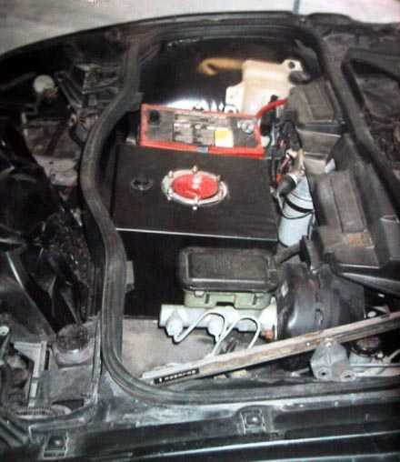

Report this Post11-13-2003 09:52 AM Click Here to See the Profile for cardealerSend a Private Message to cardealerDirect Link to This Post
heres a couple pics of mine. the fuel cell is 12 gallons and is from jegs. it fits rather nicely with out much work.
[This message has been edited by cardealer (edited 11-13-2003).]

cardealer, did you say you bought that???? where from and how much? and what'd u do with the space where the old tank was? did it mess up the hangling at all? thats sweet and exactly what i want
That looks great I would love to have 24 gallons of fuel but don't want to lose my AC. So how much did it cost? How did your handling change? How did you rig it with the other tank?

well i just realized that JEGS is a website and i found the fuel cell CARDEALER used and its 17.5" x 16" x 10" and it costs $112.99 i measured my car and you would have to make a few small cuts for it to fit and you would have to relocate/remove the AC but that doesn't seem like it'd be a big deal, this is my next project on the list after, brakes, muffler, headlights, thanks for all your help!

Report this Post11-14-2003 04:14 PM Click Here to See the Profile for cardealerSend a Private Message to cardealerDirect Link to This Post
yes that is the one that i used. if your looking for step by step instructions, you may be better off having it done by a professional. getting it to fit is the easy part, its making it functional is the tricky part. if you have a v6, you will need a inline fuel ($$$$) pump to handle your engine requirments, a return line back to the tank, some a/n fittings, a gm fuel sending unit for the fuel cell and a few more items to complete.
