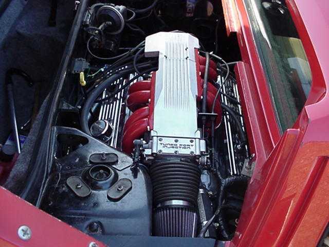

Archie, I hope you don't mind me postin a few pics for Slammed Fiero on your tread.
Sorry 2 of these pics aren't very good quality, I can take more if you need.
Right now the engine has stock heads on it, but I have a set of '98 Vortec cast heads to go on there.
This pic shows the Moroso pump with the connections to the Engine block. The pump wiring is the orange wire with the 10 amp fuse in it. This was my First ( used) carburated engine which I spun a rod bearing in.
This pic shows the general position of the water pump. I just have the Tuned port intake sat on top of the old engine.
This pic is of the Tunedport motor in the car, Complements of Skitime!!

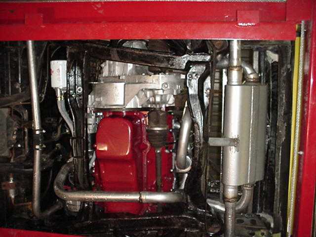

Gone in 60 Hours

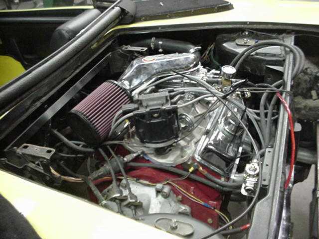

Actually, 59 hours of labor and we finished the car, did some test driving, and had it loaded up last night about 10pm. I didn't get time last night to make this post but here are some in process pics from our work yesterday.
Because of low decklid clearance we had to use a K&N filter mounted to a GN air horn.

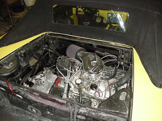

Here is what it looked like up on the lift. Much of the time yesterday was spent laying out & welding together the exhaust system.... this is a good view of that too.
Here is a view of the muffler etc. from the top before we put the new floor in the trunk.
I'm still pretty tired this am and gonna goof off today. So, I'll be around to answer any constructive detail questions you may have.

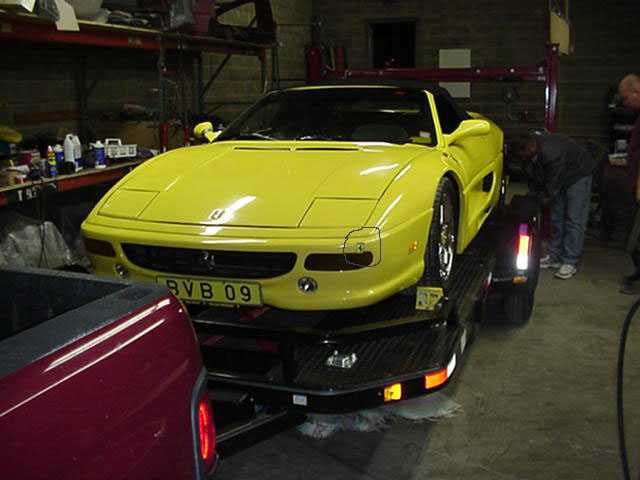

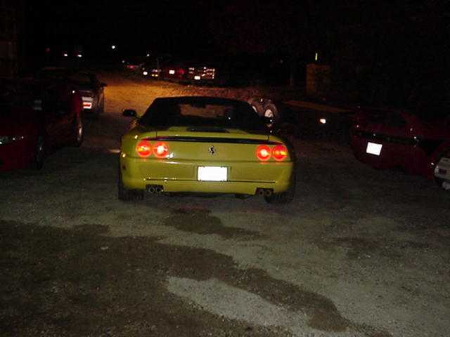

We didn't finish the car before dark last night and didn't get any good outside pics of the finished car. However the customer (who is not on the Internet) promised he would send me some good pics of the car when he got it home. So I'll post those up when I get them.

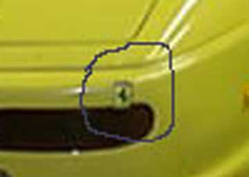

Archie--What is circled? Up close it almost looks like a Ferrari emblem, but that would be an odd place for it.

I ment to ask the owner about that, but keep forgetting to ask him. It appears to be a Ferrari sticker (patch) loosely applied over a "boo boo" on the front corner. I guess it would give new meaning to the term Ferrari patch.

So whadda think, you all want to see another play by play V-8 swap?

ok, i looked but i'm kinda dence. is the trunk shallower or narrower or a combo of both.
and yes, i'd like to see all i can.

As for the CSI waterpump:
They are now rated at 35-40 GPH
Rebuild is actually a new motor(center section) $100 dollars.
Used mine for over 5000 miles this summer. When combined with a four core radiator, it cools better than the stock V6! My fan turns on less than my V6 did, I am also running a restrictor instead of a thermostat. I have no scoops or other added methods of cooling in my system.
Ask anyone who builds hotrods for a living(MN has more per capita than any state) and they will swear by CSI.
Jim
