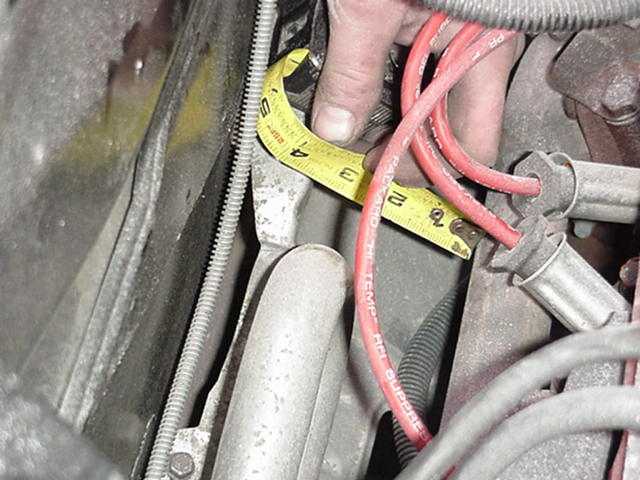

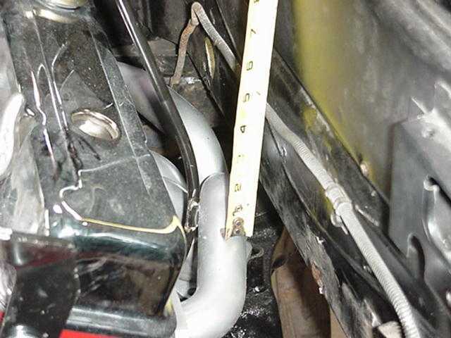

Now Loki, I'd like to answer your question. My answer along with the info you heard from others above, will show you just how dumb the Pests' question was.
In the 1st picture you will see that the Closest point of the header is 4" away from the Brake line. Also the header tubes run at a right angle to the brake line. The second picture is of a stock V-6 Fiero that hasn't been swapped to a V-8 yet. In that picture you see that the STOCK V-6 manifold runs about 4"away from the brake line. But the interesting thing is that the line runs parallel to the stock exhaust. So if I had to choose which brake line gets warmer, I'd pick the stock engined car.
In other words, my answer remains "Nope..."

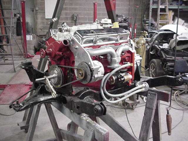

hey Archie, is this motor going to have that adaptor coming off the water pump so the pulley is in the wheel well, i thought that was pretty cool idea for not doing it the original/right way.

Yes, it will have that drive system.

This is what the engine assembly looked like after all the odds & ends were installed onto it.
As you can see, among other things, we have trial fitted the W/P Drive, but that will be removed to be reinstalled after the assembly is back in the car. (Monkeyman, good question I will answer it in the next post)

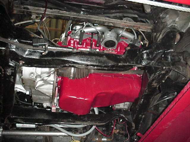

Here is what it looks like from the underside. This pic was taken about noon today before we fired it up.

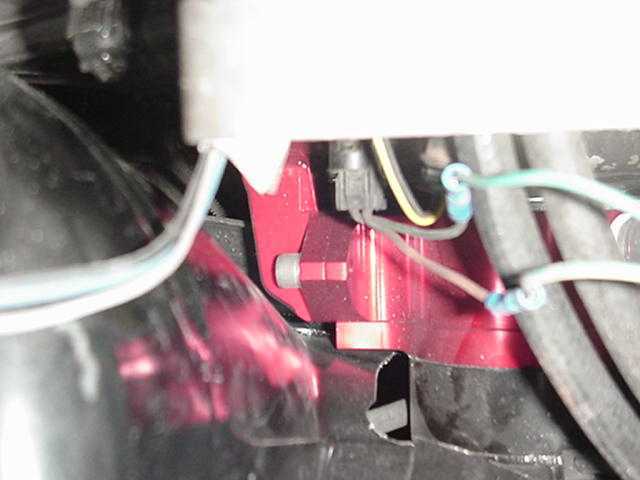

Here is a top view of the CSI (the red thing) installed in my "T" top car.
And a view thru the wheel well with the car jacked up so you can see it. please note that in this view the pump only violates the sheet metal by about 3/4" at the most. When you reinstall the plastic inner wheel well and don't trim it like we did here, it will cover the end of the pump you see in this view.
