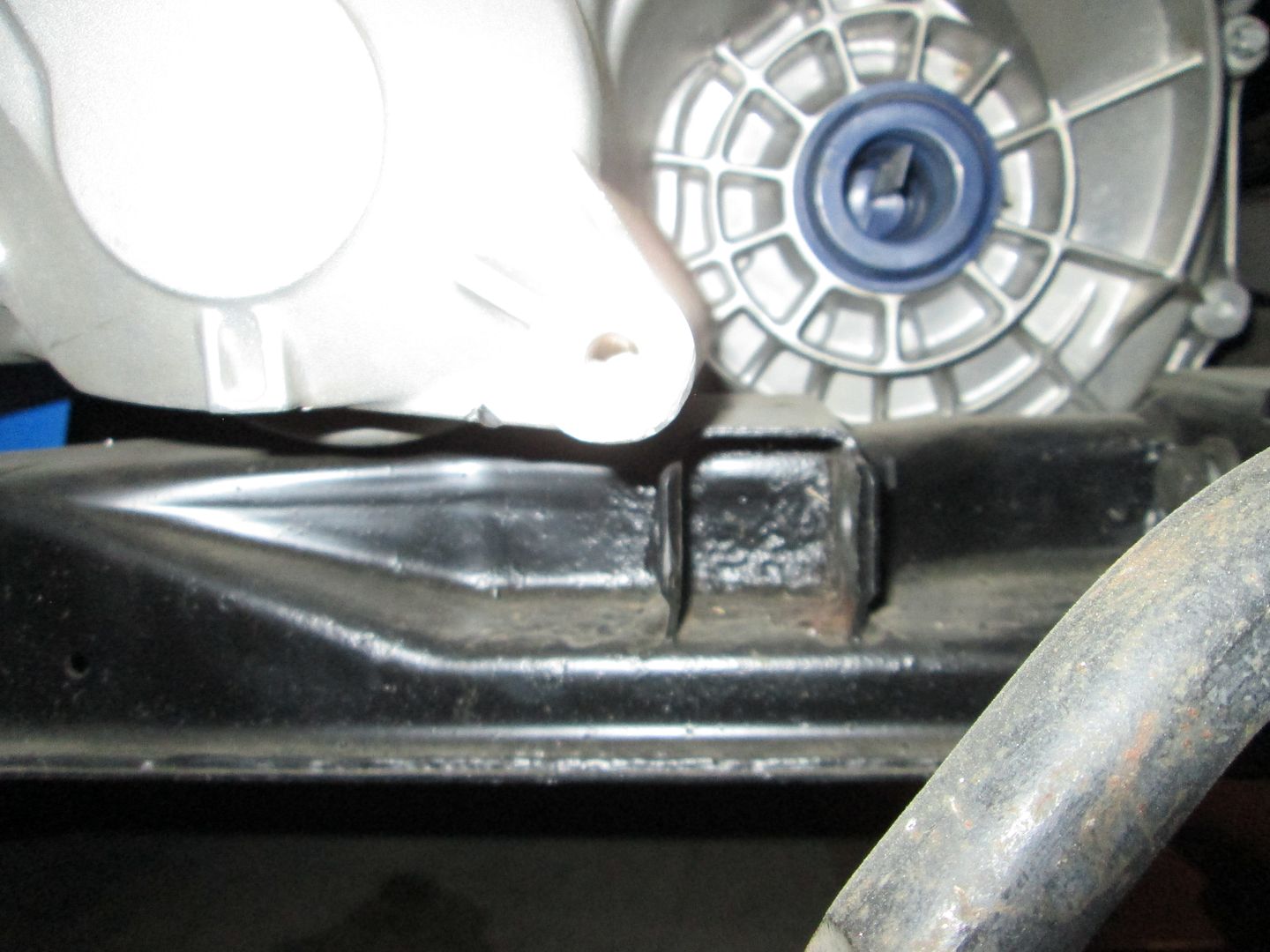

There is an interference between the cradle and the F40 transmission where I needed it to be located. The factory position for the engine to the best of my knowlege places the centerline of the crankshaft 9" above th bottom of the cradle, and 19" from centerline to the rear cradle mounting holes. The interference was located here:
 This is looking from the drivers side wheel well at the front transmission mount.
With the rear mount in place the transmission was resting in the front on this interference, which is actually about 1/8" above the intended location of the engine and transmission. So some minor clearancing will be needed. I could cut the part off of the transmission, but instead, I will modify the cradle.

Clears the cradle by 3/8" or so
Clears the frame rail by 1/4" or so
