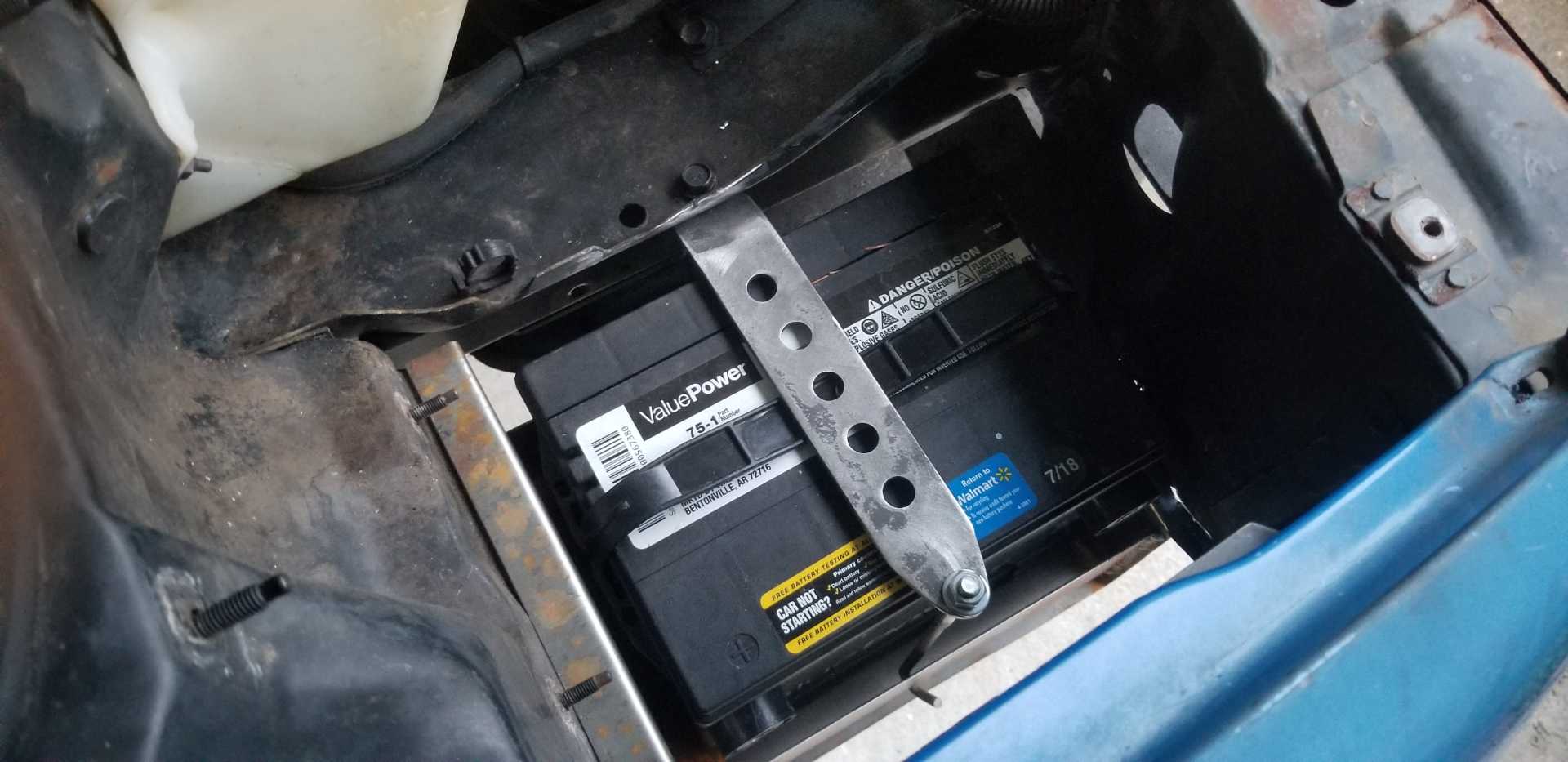

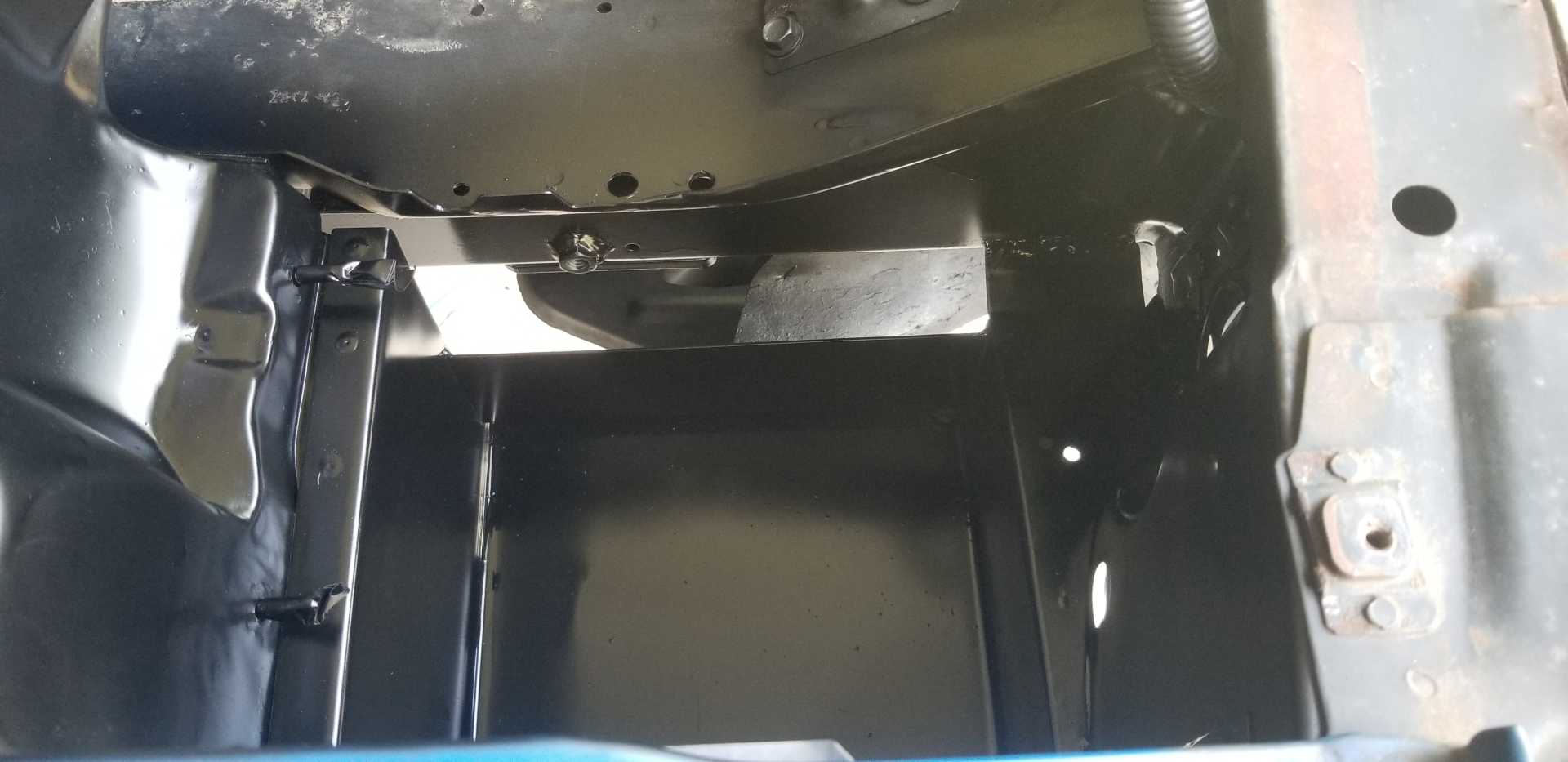

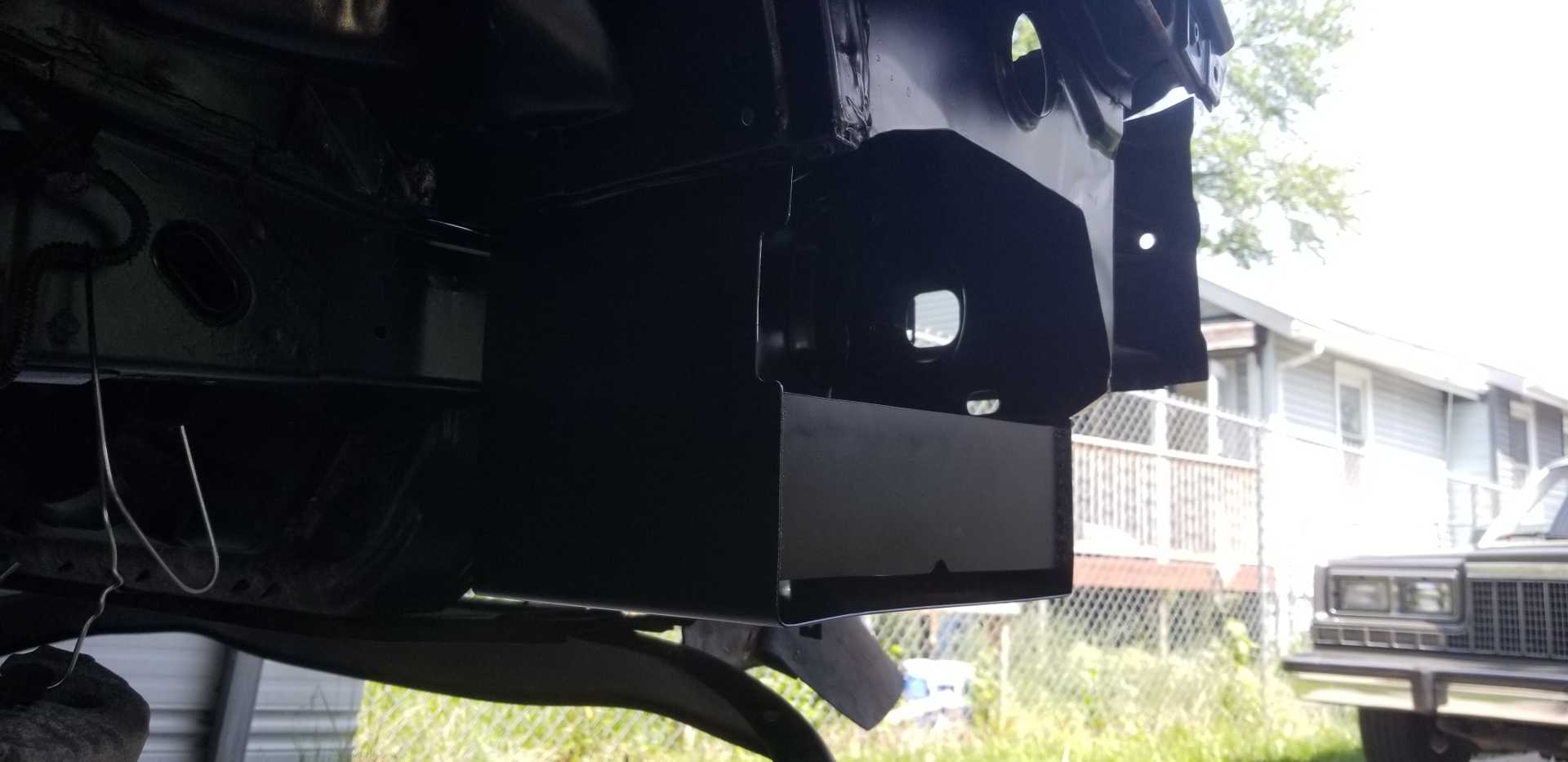

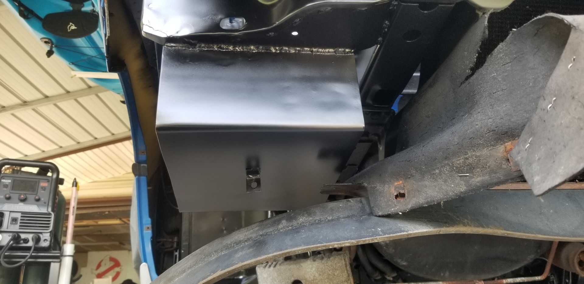

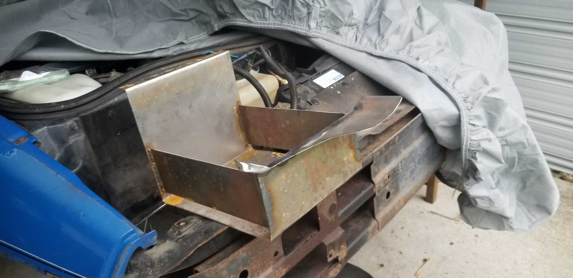

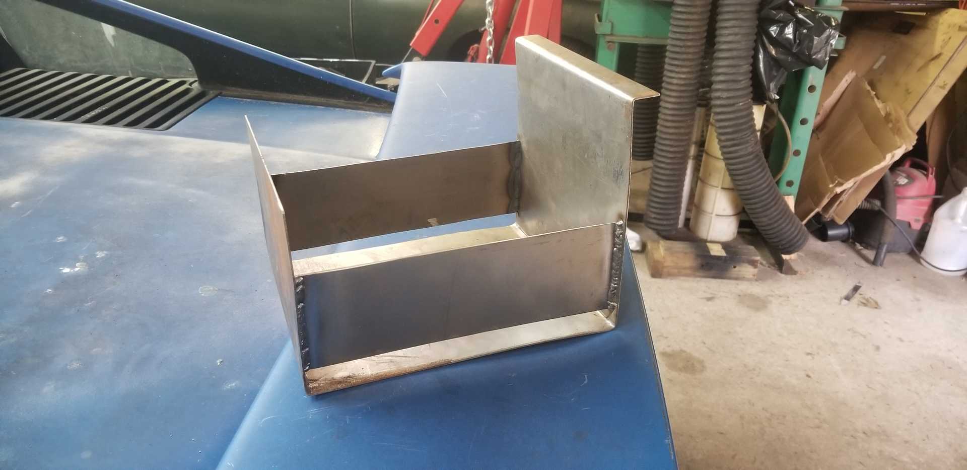

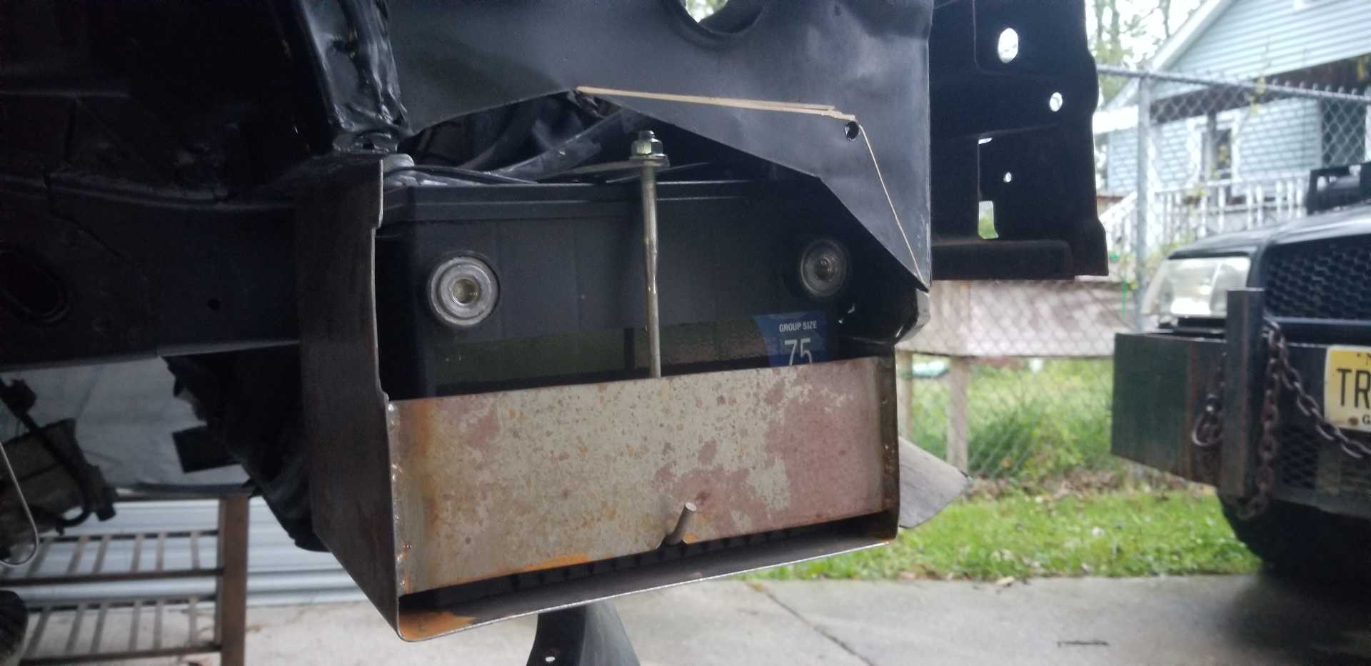

Figured I share my battery relocation. Wanting preserve as much room in front compartment as I could, i wondered if anyone put their battery in the empty area under headlight/in bumper. Did a search here and low and behold, I found and old thread where FieroGuru had done just that. I based basic tray off his design and went from there.

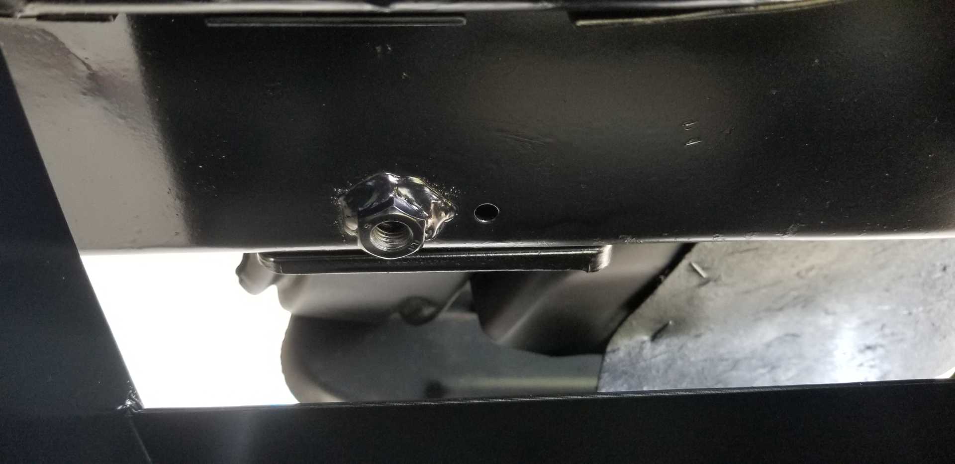

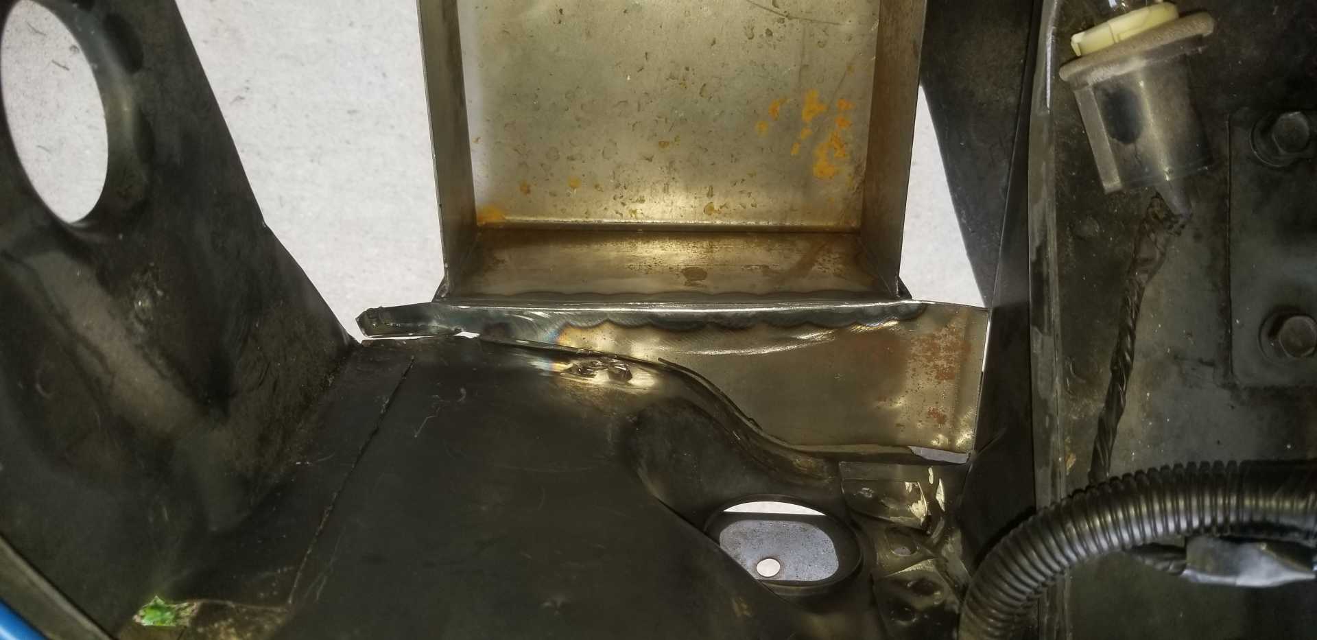

Tray is 16ga steel, hold down 1/8 x 1.5 plate. Cut out sheet metal under headlight and fitted tray to be spot welded in the rear, and welded along edge up front as lip was thin. Hold down bolts to frame and J hook to tray itself. Small tab on bottom for nose support. Drilled out the old horn mount hole and welded an M10 nut that will serve as the grounding lug for the battery. Positive will have a 200a breaker right off the terminal
