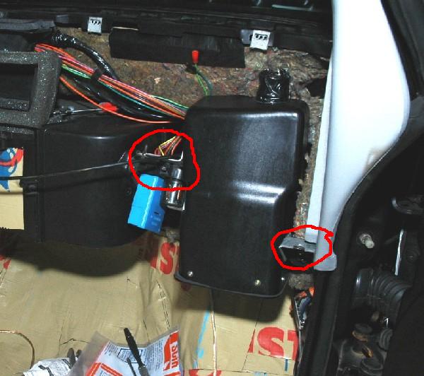

I bought a Fiero Store sub-housing that just bolts into the Fiero since it's a factory duplicate. If you have an 86 or newer, your heater box should already have the correct support bracket that supports the Convenience Center (chime box, flasher etc) as well as the sub-housing.
This picture shows how the Fiero subwoofer box is mounted.

12-19-2008 07:09 PM Click Here to See the Profile for fierosoundClick Here to visit fierosound's HomePageClick Here to Email fierosoundSend a Private Message to fierosoundEdit/Delete MessageReply w/QuoteDirect Link to This Post
Originally posted by joshh44:
my fiero is a 1986. so would that mean i would have the bracket for that subwoofer enclosure?
The sub housing is mounted to the dash bracket on the right and the chime box (blue thing) bracket on the left.
If your chime box is mounted differently, you don't have the subwoofer bracket on that side.
More pics of what you're looking for here: http://www.fiero.nl/forum/Forum2/HTML/085338.html

I built an enclosure with 8.5" sonotube, 12" in length, yielding .33cuft, perfect for my Polk/Momo 8" sub. This mounted in the same location as the factory sub. My car is an 86 (non A/C ) and the assembly attached similarly to the sub shown...no holes needed to be drilled. This enclosure is not visible from the passenger seat.

This is a good idea but with 100w I can see the flimsy plastic enclosure flexing a lot and adding distortion. Maybe not noticeable to many but will be there for sure. Would be nice to reinforce the stock enclosure.

I just did this to my own, using the suggestions here and from others on the forum.
http://www.fiero.nl/forum/Forum2/HTML/097588.html
It sounds really nice, even when pushed hard. The bass is not as deep as it would be with a larger speaker, but for my needs, it sounds just fine.
You do make a good point, by suggesting the plastic might be an issue at higher levels. I was worried about this, and about buzzing. I'm shocked by how clean it actually is. But in no way is it as good as a quality wood enclosure. I don't hear a ton of secondary harmonics, but the sound is a bit "colored" as compared to the nice warm sound a wood enclosure can provide.
I also use a lot of poly fill to compensate for the smaller enclosure.
Doesn't seem to be a problem - likely because it is ported. Now if it was a sealed enclosure, I could imagine it would eventually crack from flexing under pressure.

OK, I made the adapter just as you have pictured, I let the silicone dry overnight and will assemble today. I got the polyfill at WalMart. You say stuff it loosely. I guess as long is it is not packed tight I will be OK. I also cut 2" off the plastic tube. I will test it out today.
I have high hopes for this as to date my subwoofer has done nothing more than fart a couple of times.
Can someone explain something? If sealing around this mdf adapter is important why was the original metal piece in there full of air gaps? Not sealed at all. Air/sound could pass around the speaker or through the bass tube.
Had yours been taken apart previously? Mine was gasketed in that area, so the original piece was fairly sealed.

The only gasket I thnk there was was around the speaker grill. Anyway, I got the t-b installed and it works great. It finally has some bass. It is subtle. I can pull the connector on and off and it definitely makes a difference.
Thanks for this upgrade.
